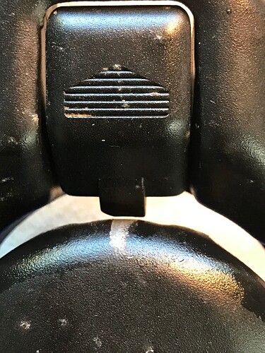

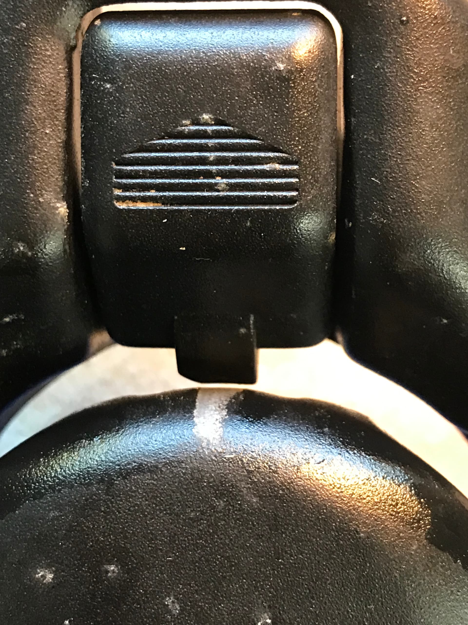

Bob, I carried out the second method today. Yes they work better but the design is not that brilliant with hardly any overlap.
Think I’ll see how they go and perhaps drill and tap tiny threads for a tiny dome headed screw. This pic was before I filed a mm off the ‘arms’.
