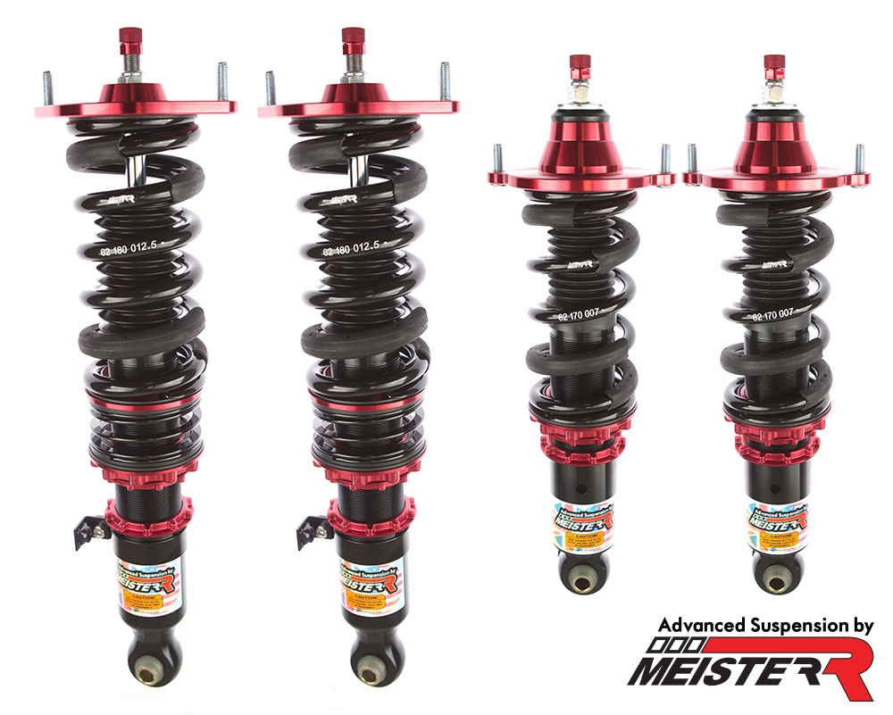

So I decided to make something just to prove a point, as well as designing a new setup for customer with a different focus.  The MeisterR ClubRace was the result.
This is not a theory, but an actual double perch coilovers with the same travel as many single perch coilovers that was optimised for ride height of 310mm / 320mm (12.2" / 12.6")
The major advantage is that driver can freely adjust the ride height from the out of the box ride height to 2.5" higher with no affect to damper travel ratio; something dual perch cannot achieve.
That mean you can run this suspension at the lower ride height, as well as OEM ride height, without the need to change anything.
If you compress a springs by 40mm with a single perch coilovers in order to gain 2.5" ride height, it will 100% mess up the vehicle dynamics due to massive reduction in rebound travel.
Another advantage is that with the helper springs, you can adjust the compression / rebound travel ratio without changing the ride height, as adjustment to the helper springs and ride height can be used to offset each other.
Therefore, if you run a bigger wheel setup and want to limit compression travel, you can do so without changing ride height.
With a single perch setup, you will either have to change ride height to give the wheel more room, or use a longer bump stop which effectively remove usable damper travel.
Just want to bring it up that the dual perch isn’t all bad.  It allow a lot of “versatility” that a single perch setup cannot provide.
A little creative engineering will be able to get around the small draw back of the dual perch design, such as using extended top mount to gain space needed to fit a longer damper.

Basically, you shouldn’t lose much driving dynamics from changing the ride height in this case.
However, if you are getting a jolting stop when going over rough road surfaces, that will be you running out of damper travel and changing the ride height won’t solve that.
The rule of thumb is at least 25mm of the thread needs to be in the lower bracket.
So that is what I will recommend, and that would be the highest setting possible on the coilovers.
Hope you get it sorted out.
