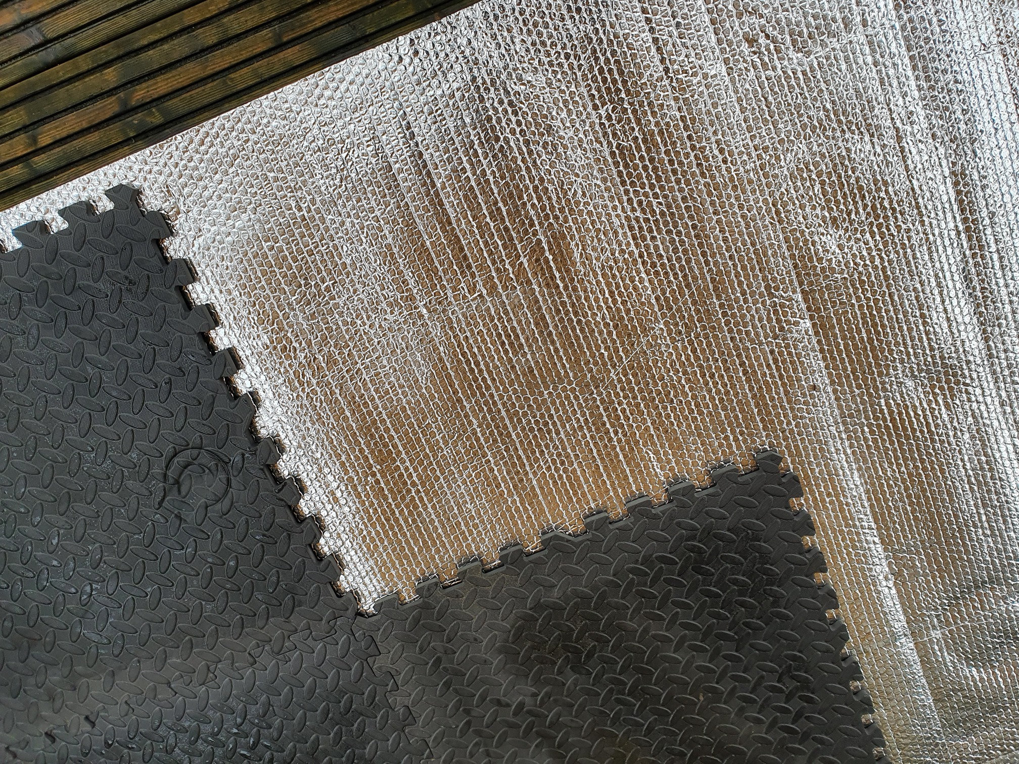

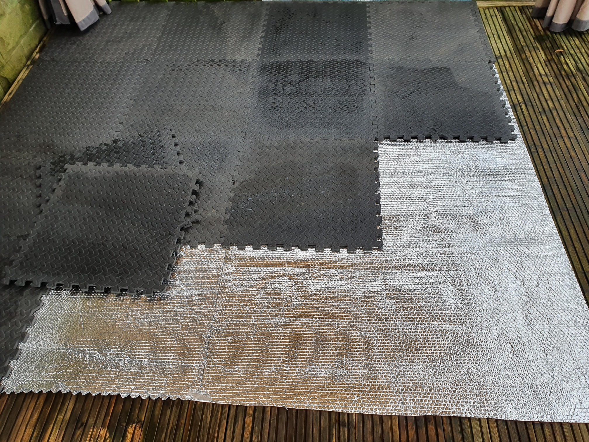

A few weeks ago, I took down the hot tub, packing it away for the onset of cold weather. Concerns of things like “don’t use it at temps less than 4°C”, etc. Anyway, thinking about it, if the water temps were maintained at least at +35°C then there shouldn’t be an issue. Pump works 24/7 to assist with filtering, so again, the pump/heater/air jets are all integral in the one unit, so the heated water is circulating all the time. Problem is, as ambient temps drop, heater works harder to maintain set temps. With me so far? :slightly_smiling_face:

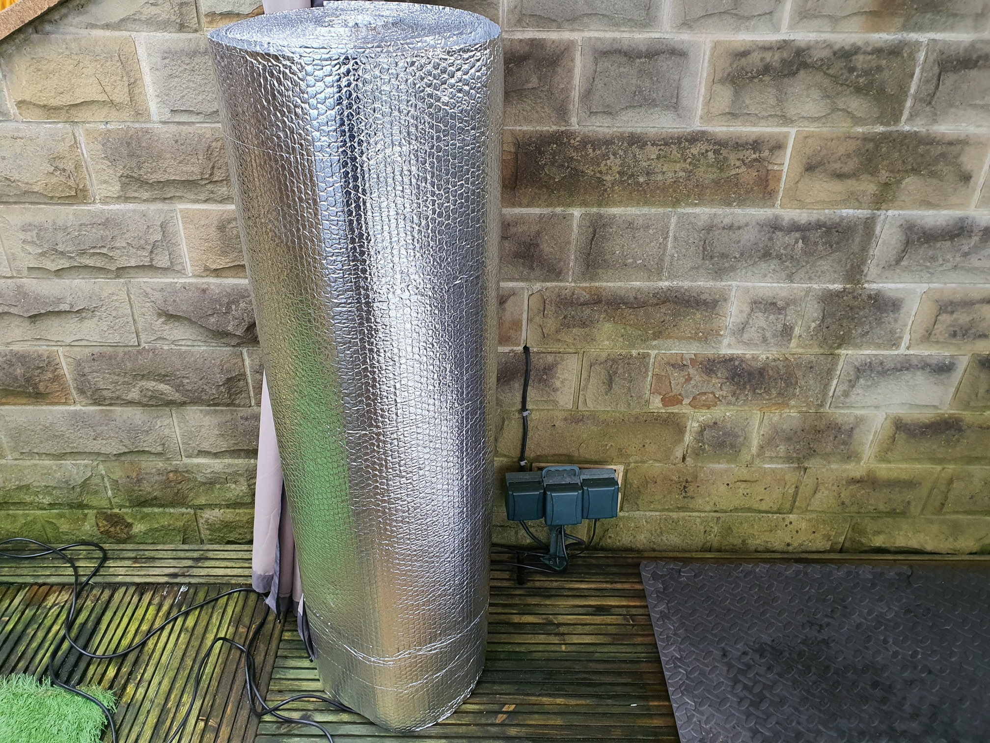

So, I’m attempting to winterise the hot tub for the colder months. I’ve started by purchasing some aluminium foil bubble wrap insulation and this morning, did this.
Ably assisted by these two ‘helpers’ :laughing:
So an additional layer of insulation under the foam mats that the tub normally sits on :+1:
Next job is to form a double layer of the insulation around the sidewalls of the tub and a double layer, circular ‘blanket’ of insulation to float on top of the water. The cover itself has an inflatable roof to both keep the cover more rigid, stopping it sagging and to provide additional insulation. :+1:Will add to posts as I (and the terrible twins) progress.
Forgot to mention, I also purchased a circular patio furniture cover to keep everything in place and make it look neater when not in use.
I suggest using a two inch thick sheet of builders expanded polystyrene with a thin protective layer of OSB on top of it. Ex-poly is brilliant stuff for this and very good for a distributed load. You might think about boxing in the sides with more of the ex-poly.
I put 2" ex-poly under the concrete floor in my extension, and forty years later that floor has not sunk or settled in the least bit, and the heating pipes embedded in the concrete keep it warm underfoot.
Hi Richard and thanks for the suggestion regards insulation :+1:
TBH though, I needed a soft solution that can be just rolled up out of the way when required. Having bought a roll of the bubble wrap type insulation, predominantly for the sidewalls, there’s plenty left to do all the other areas too! The tub is sat on a wood deck, on a layer of this foil insulation, which in turn has the foam mats on that. The tub itself has an insulated floor too! Hope it will suffice :+1:

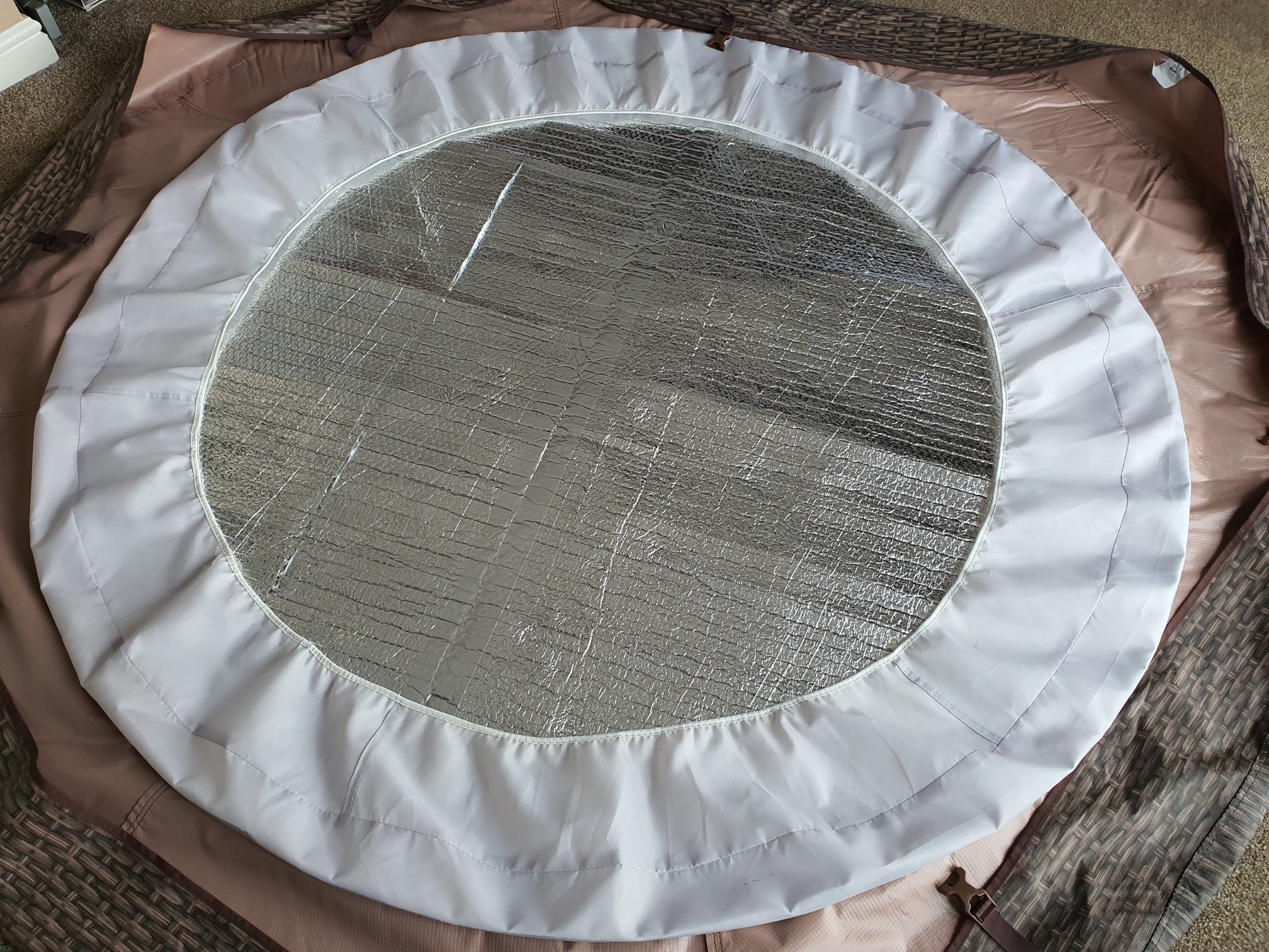

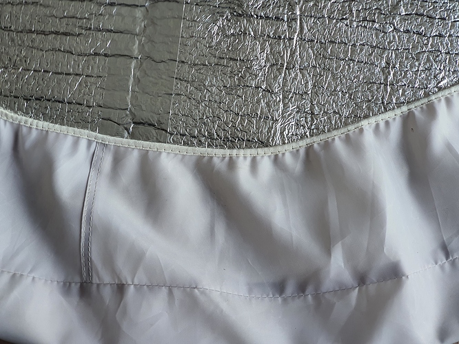

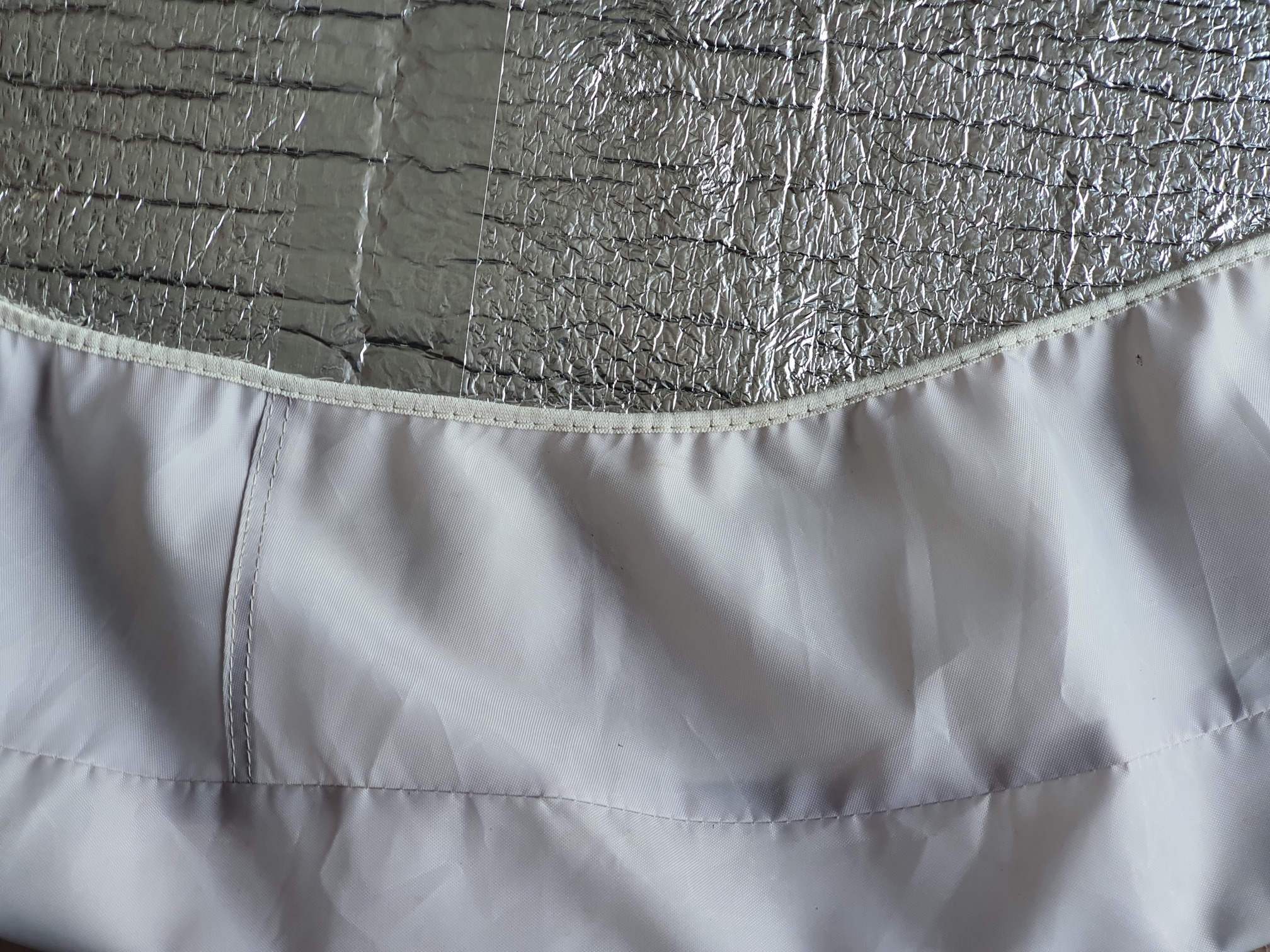

Had chance to do a bit more on the hot tub today. :+1:
Utilised the lounge for this first bit :grin:
Joined two sections of the alu foil insulation together with the foil tape and marked out a circle (I did this twice) one circle to go directly onto the surface of the water and the other to insert into the tub cover, sandwiched between that and the inflatable insert on the cover.
I’m currently filling the tub ready for chemical dosing and hopefully ready to use before the weekend :slightly_smiling_face:

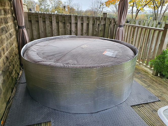

I’ve also made up the double layer of insulation to go around the tub before the patio table cover I bought is put in place when not in use.

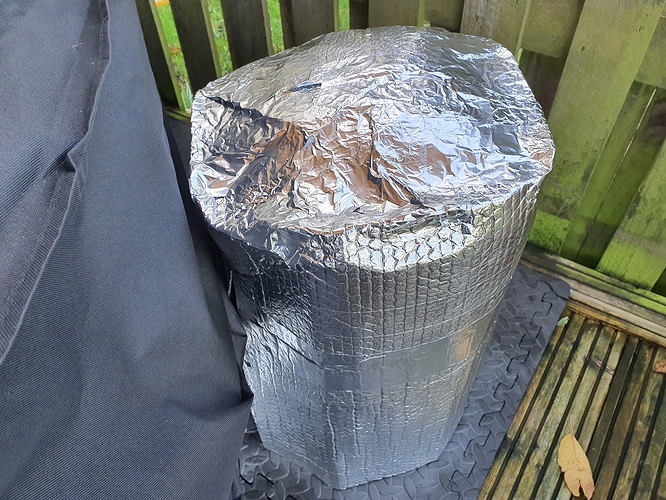

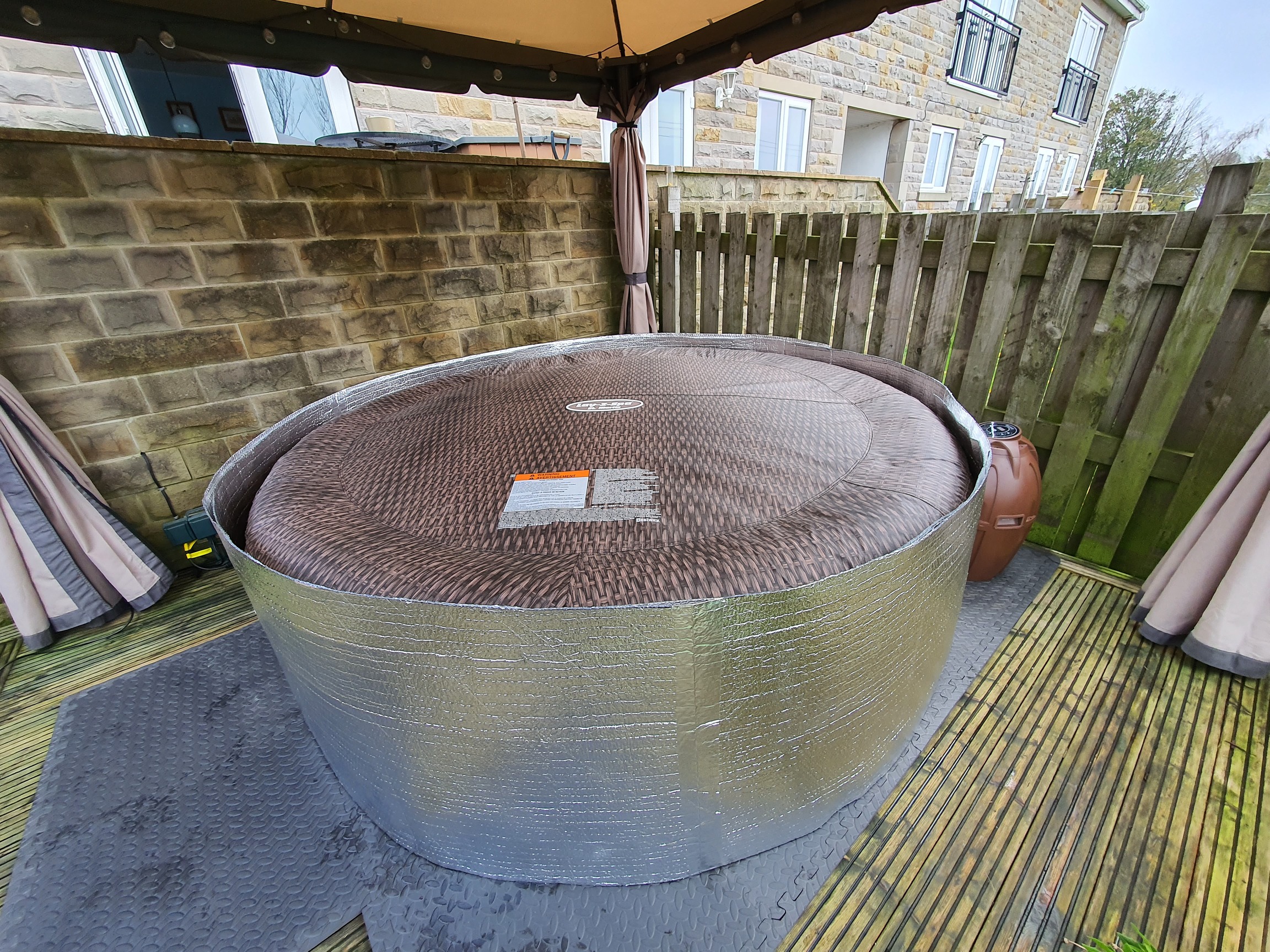

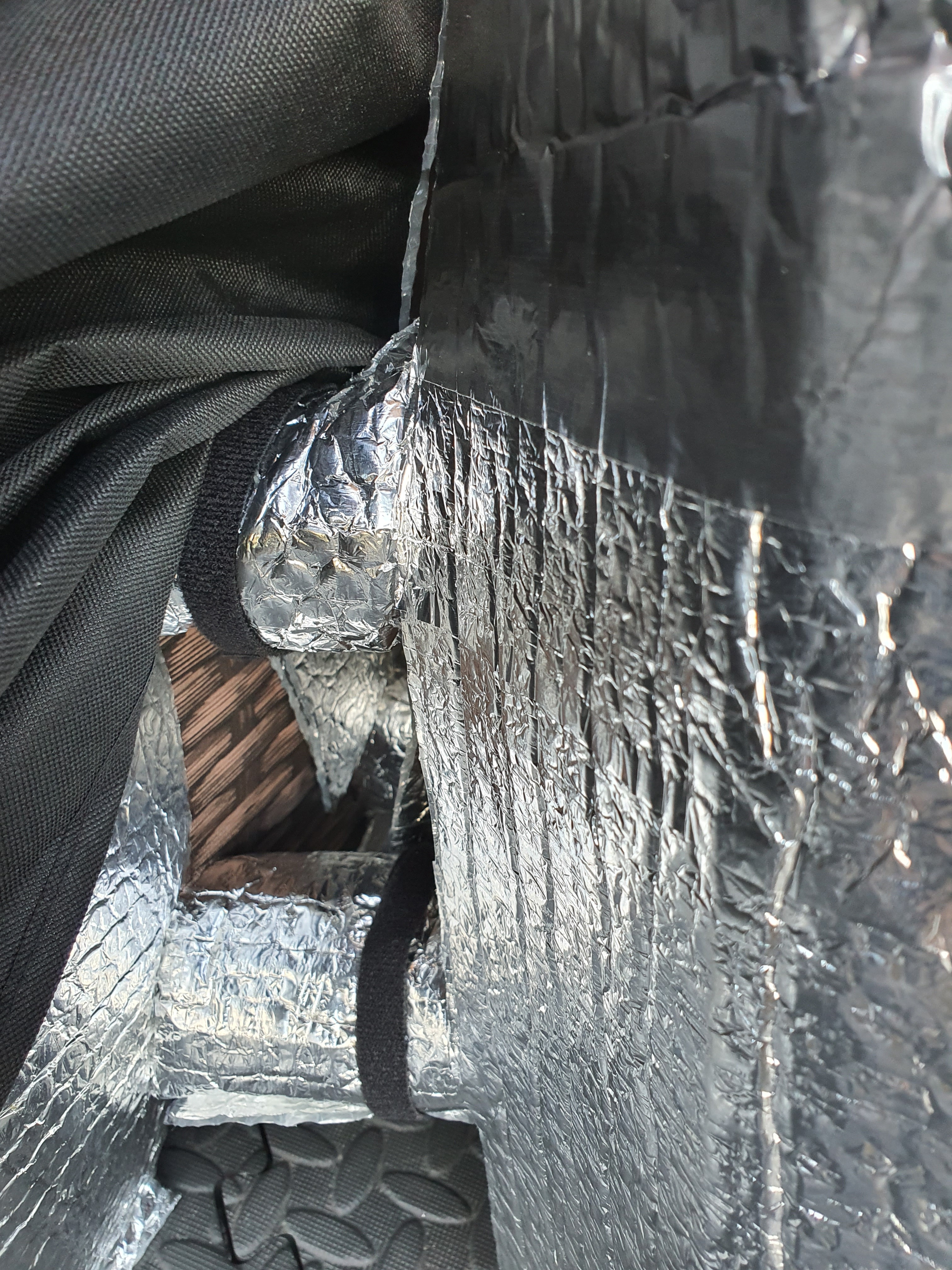

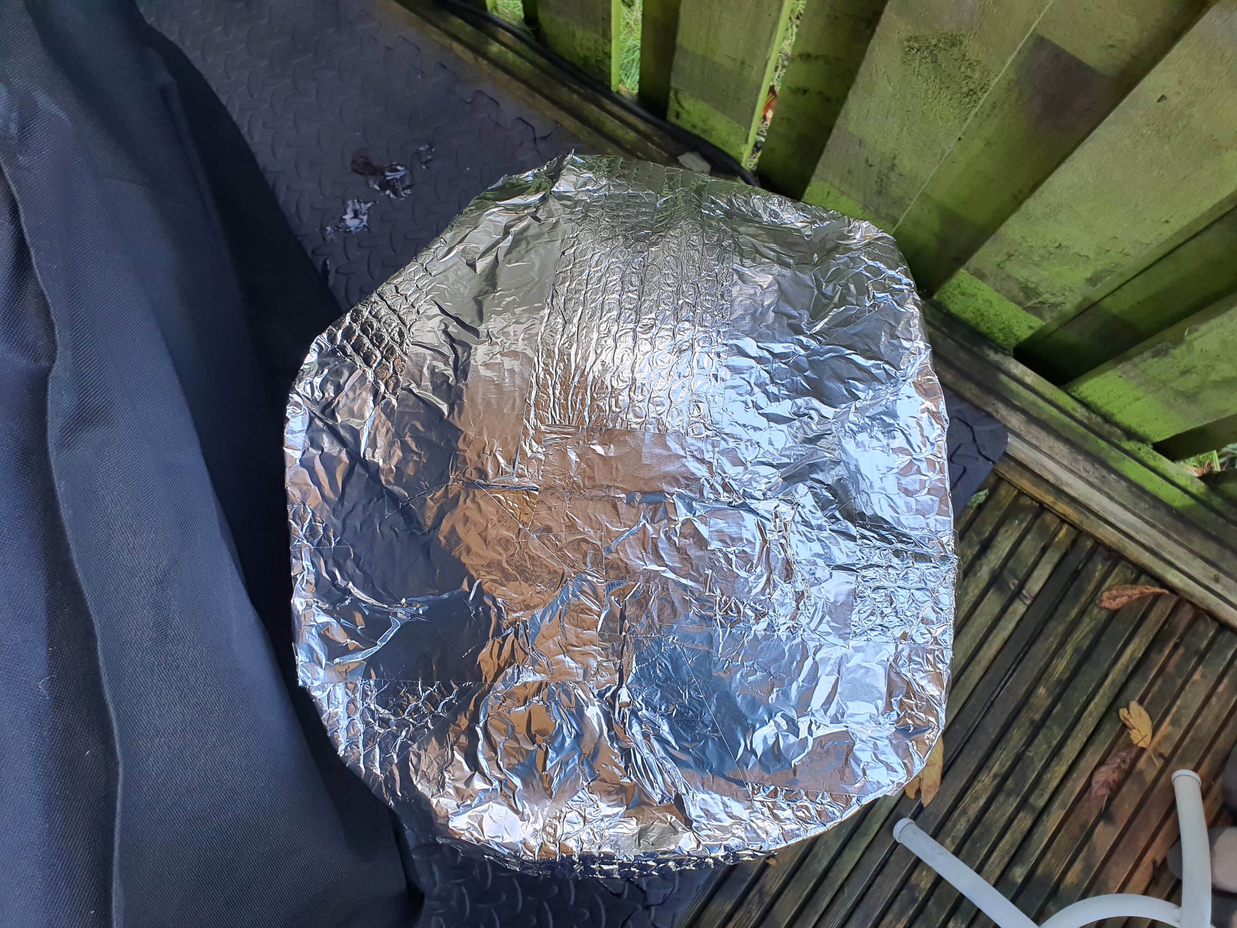

Final bit done this morning, of the winterising of the tub.

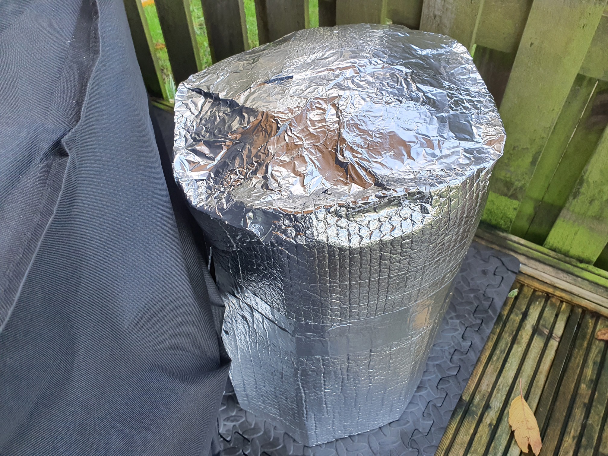

There are separate flow and return pipes for the tub and a tube for the airjets. I’ve insulated each with a strip of the insulation wrapped round and held in place with a strip of velcro tape. Easily removed for connection/disconnection.
I then made a sleeve to cover the external pump, heater and controls unit, function over form here! :grinning:
The air vents on the unit are below and between the pipe connections so I’ve left that section shorter so it doesn’t interfere with air flow and ventilation. Final part of the jigsaw was to cover the whole thing with the patio dining table cover, managed to source one that fits nicely, (not too tight) and has plenty to tuck in around the bottom of the tub walls.
The heater allows the temp to raise 2°c above set temperature, switches off and kicks back in at 2°c below set temp. So, will raise temperature a total of 4°c each cycle. The more insulated, the less number of cycles will be required. I’ve decided to leave it on all the time to see how much it will cost (having taken meter reading at first switch on). This morning, the temp was a steady 39°c same as at switch on yesterday. I reckon it will have cycled once during the night :thinking:
My current (excuse the pun) energy supplier kw/hr cost is 14.3p, the heater is 1.6kw and will take approximately 4 hours to raise temps by 4°c so each cycle cost is approximately 90p, I’m hoping for no more than two cycles a day now, equating to £1.80 or so per day! As we’re in lock down from tomorrow and we won’t be doing much else, I’m happy with that running cost :+1: plus, previously, we were only switching the heater on when required and tub temps were often down to 23°c so taking up to 15 hours to get to full temperature, that was costing well over £3.40 per use! Will have to see actual costs as we go along. Also can have access more or less anytime as temps will be ready for use :+1:
EDIT: got my maths totally wrong! :roll_eyes: have put in correct figures now!

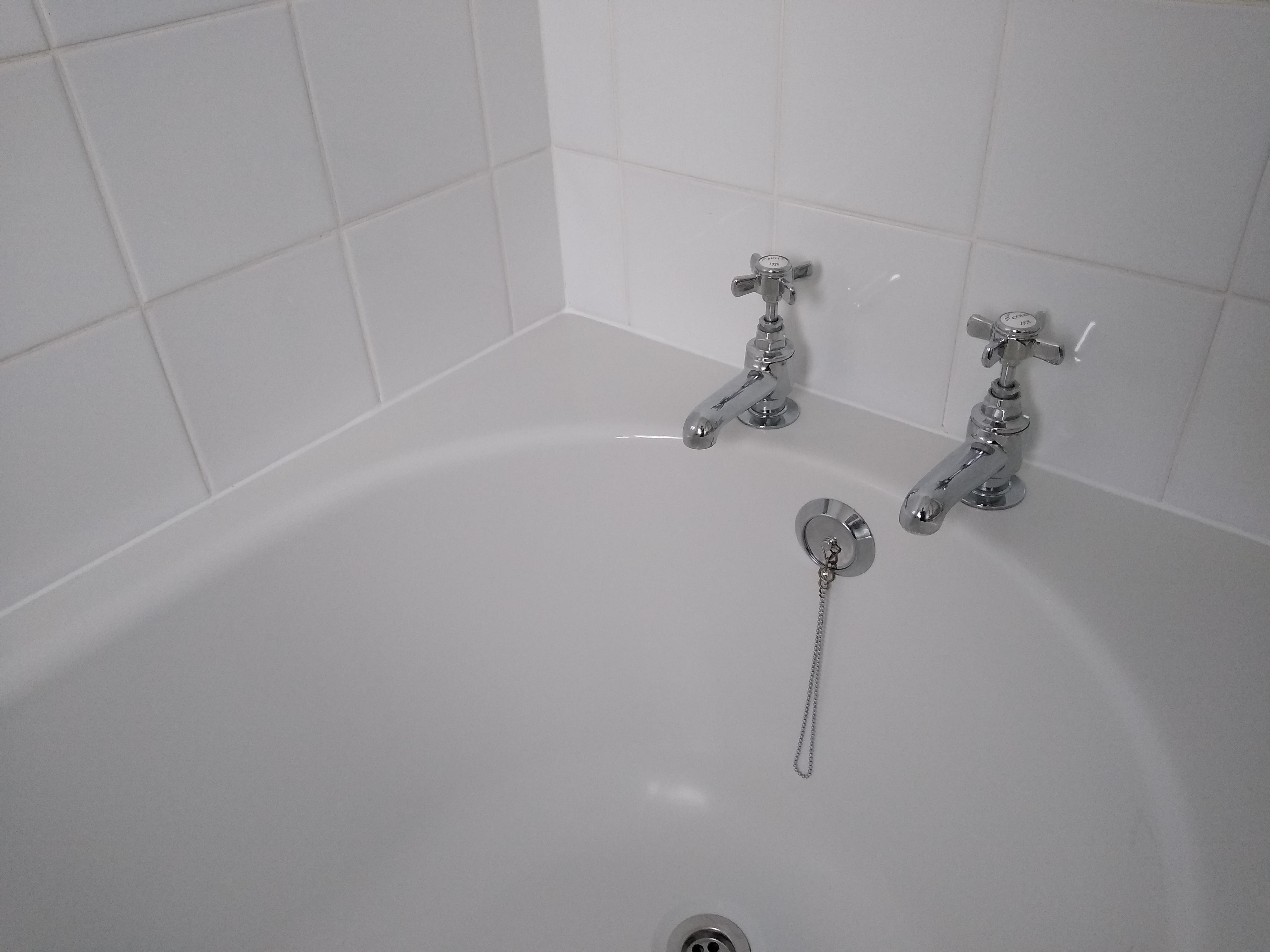

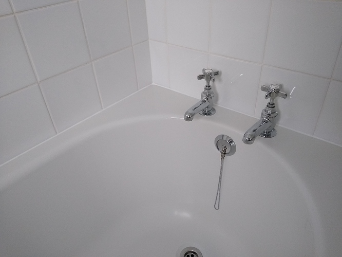

A bath tub this time…
There’s nothing more satisfying than getting that sealant done around the bath. Nice and a neat finish.
Lockdown job saved for lockdown 2😁
Hi Mick, does look very neat, did you do that freehand or mask it off? That’s what I normally do, then pull the tape before the sealant dries off. :+1:
Freehand Barrie, I’m getting good at it after years of making a mess of what looks a simple job.:grin:
Well done that man! :ok_hand:
Nice job​:+1: Has anyone tried those “Nozzles” that you attach to the tube. The adverts make it look really easy and neat… But I wonder :thinking:
I just use the cartridge gun, had it years, does the job ok.

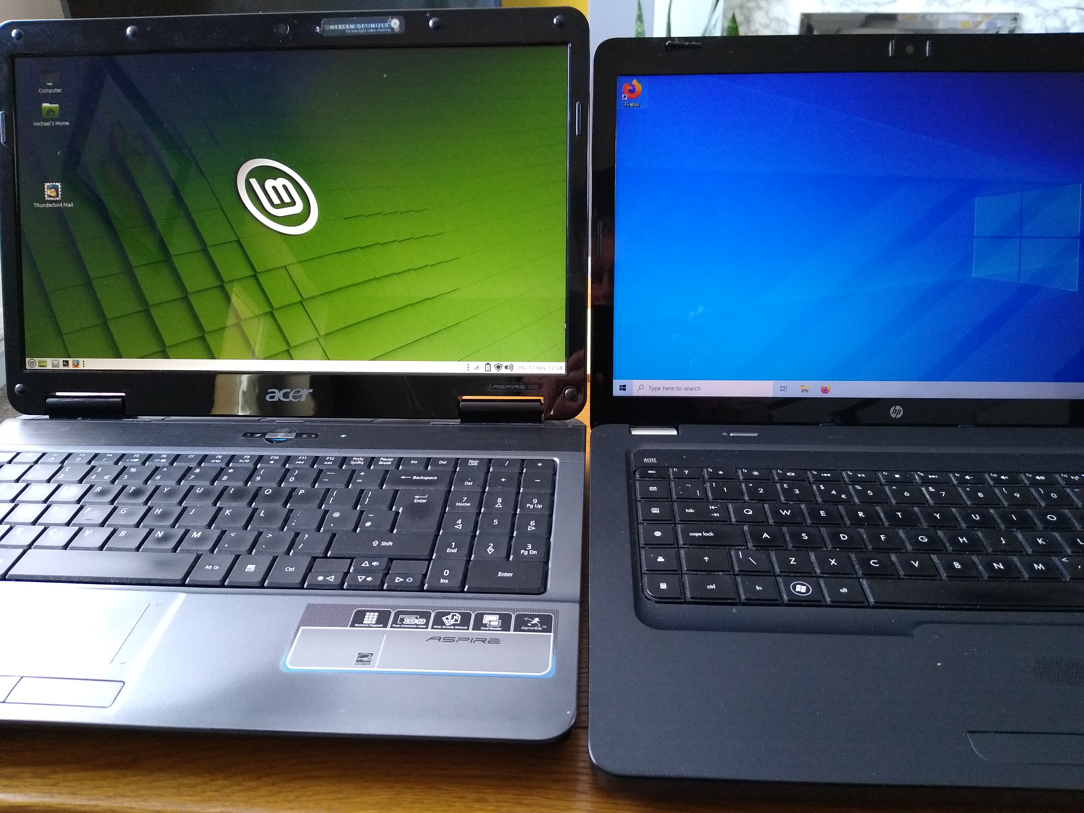

Yesterday I have mostly been messing with two oldish laptops.
Reinstalled Window’s on one, installed Linux on the other.
Acer is the older one, HP is newer but old if you get my drift.
I prefer the Acer, it’s silent always has been. The HP whirrs away like something possessed, hate it really but I like the central touch pad position but it feels cheaper than the Acer.
I’m going to install Linux on the HP next for a trial as I’m beginning to hate Windows 10 more and more.
Was going try one of these Raspberry Pi 400 but I’ll stick with one of the reinvigorated laptops for now.
