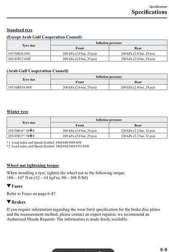

I have just had a new pair of Yokohama Advan 105 V85 195x50x16 tyres fitted to the front of my ND. The old ones had 3mm left but as they were original 2016 tyres with 41,000 on them and were beginning to perish it was time for new boots. Got the tyres from my local back street tyre guy who fitted them all ok. Then he went and inflated them to 36psi? I queried this saying the book says ( these are OEM) 30psi? We agreed to differ. Who is right? I’ve been running at 30 since I got the car in September?

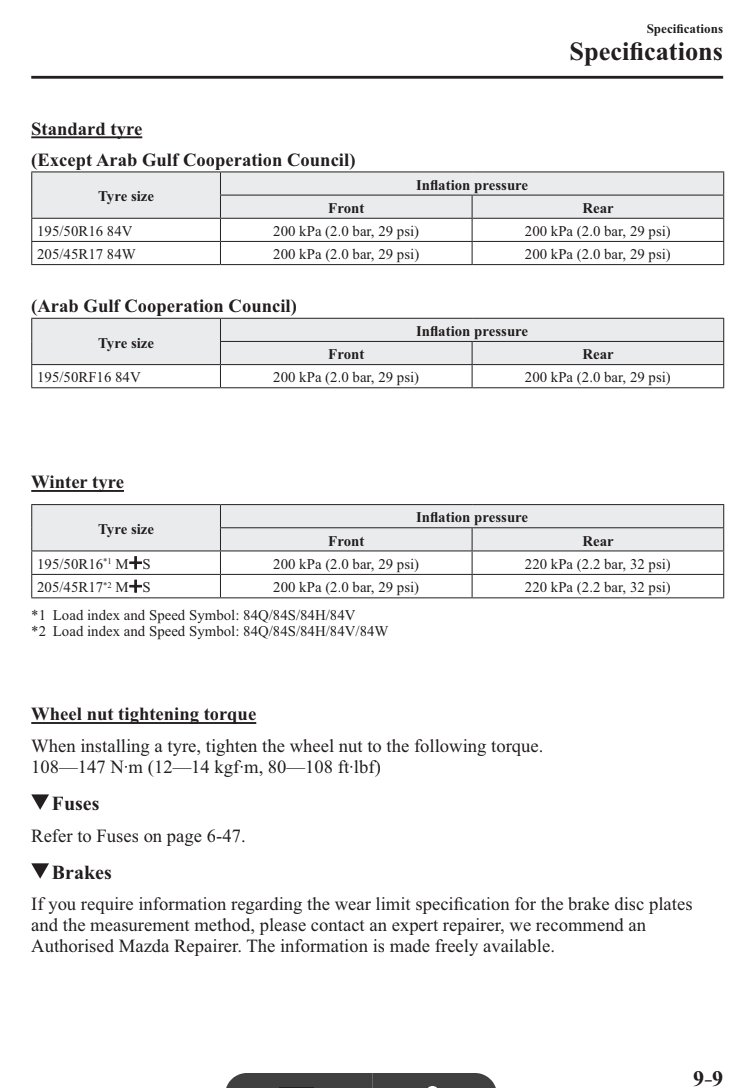

I run mine at 29 PSI which is what the manual says? Or the one I have anyway. Page 9-9.
36 PSI is way too high and I’d say would lead to excessive wear to the centre of the tread due to over inflation. As well as less than precise handling and a harder ride!
Steve
Extract from the manual:
As above, 29 PSI.
