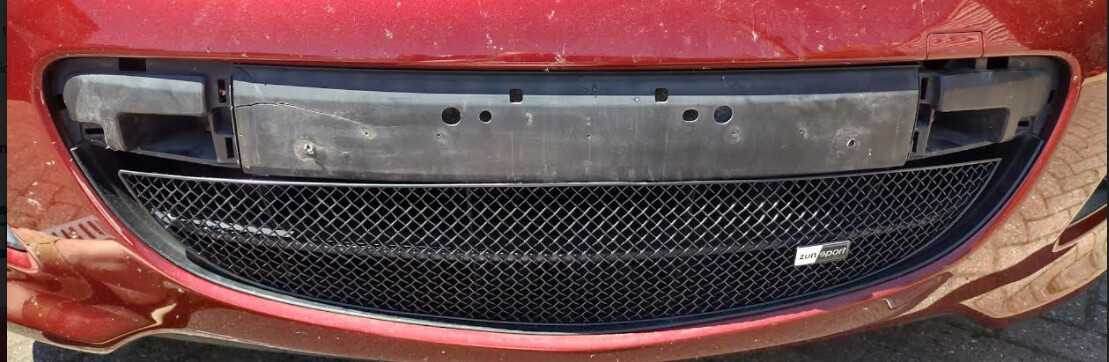

I’m assured by ZunSport that they have supplied the correct part, but I’m struggling to fit it. It’s supposed to just push in, and then fold over the lugs.
They have suggested removing the number plate housing - is that easy to do?

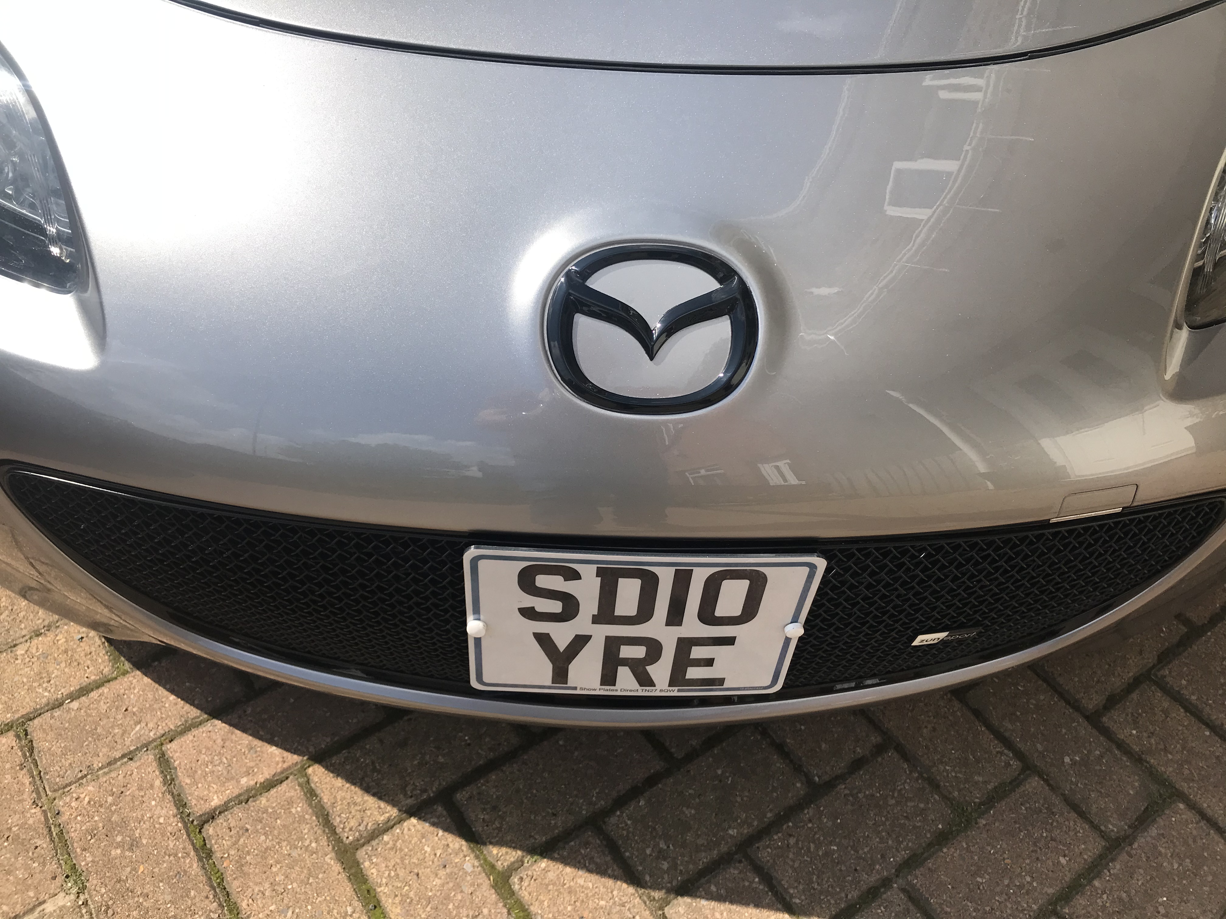

Difficult to see from your picture, have you bought the full grill or the one with the number plate cut out? This is mine and you have to remove the plinth completely.

I don’t think I have been sent the correct part…
Definitely not! It’s neither one or the other!
Actually, it’s quite confusing! I can’t actually see the one I bought on the zunsport site, although it is there on mx5Parts site?

ZunSport had supplied a 3.75 Grille not a 3.5 version.
Quite pleased with how it looks.
Shame about the dead bugs!
…and the illegal reg plate

I have the 3.75 one which does look good as yours does.
