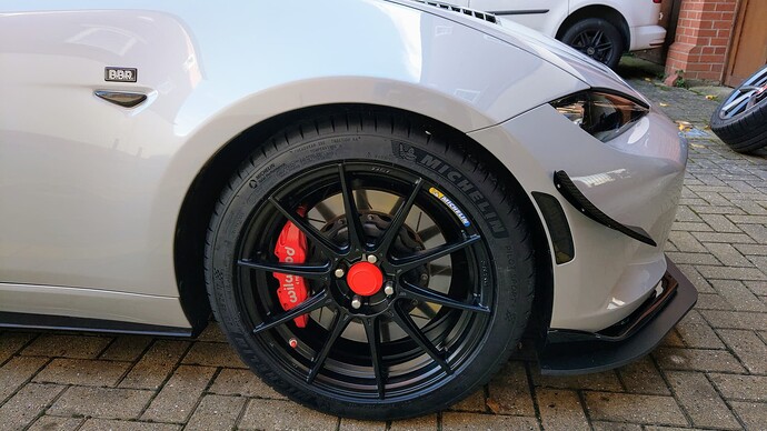

yes I do have the four pot with black Dimond disc’s with 20mm spacers soon to be replaced with 15mm spacers due to new wheels set up easy to fit kit Racing Beat Europe supplied them Clive/Lisa are very helpful…they been on around 5 years now …
love that lip spoiler :wink: :+1: :+1: :+1:
