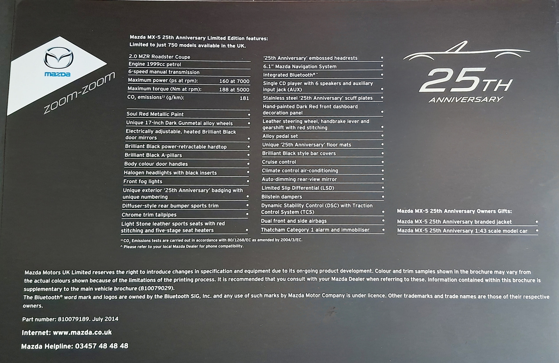

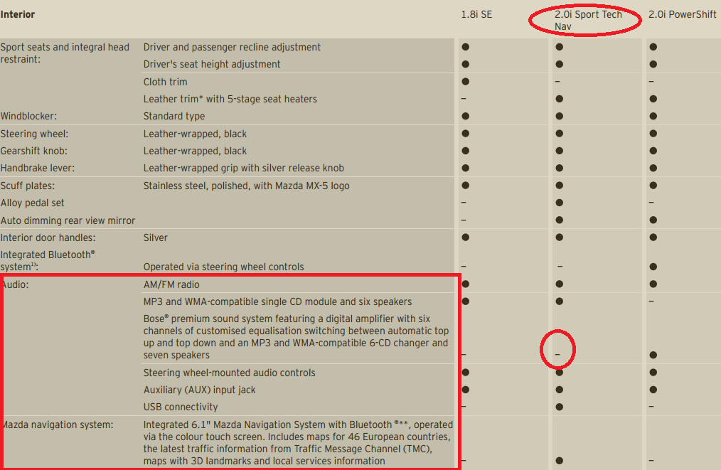

Hmmm. As you can see, the 2014 UK Brochure does not list the Bose amplifier as an available option on the Sport Tech Nav.
It also looks like the Bose amplifier only came as part of a package with a 6-CD changer. Does your car have a CD changer?
No cd changer. A mystery it would appear. Will be interesting to see what amp and speakers have been installed, when i take more interest in spring. It is very good whatever it is, and an added bonus by all accounts then.
I looked at my copy of the 25th Anniversary brochure there is no mention of Bose in it.
