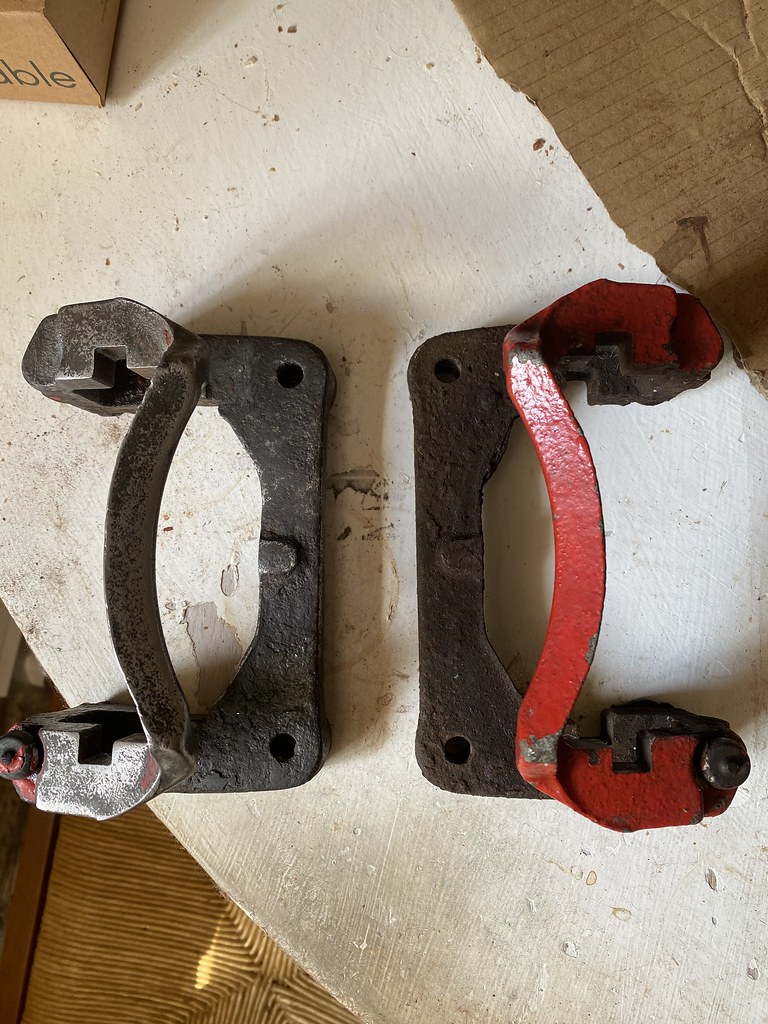

…and have been slowly refurbishing the suspension arms and brakes.
Imgur
Imgur
Imgur
Imgur
Imgur
Imgur
Imgur
Imgur
