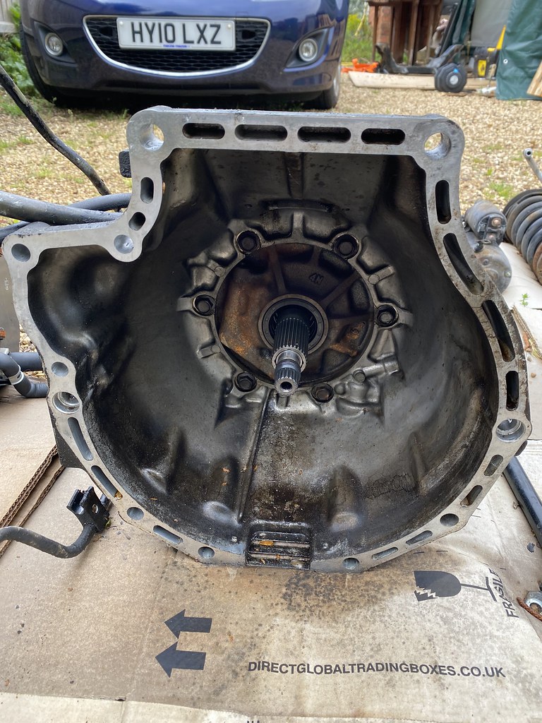

  • Purchased a 5 speed gearbox from a mk2
Imgur

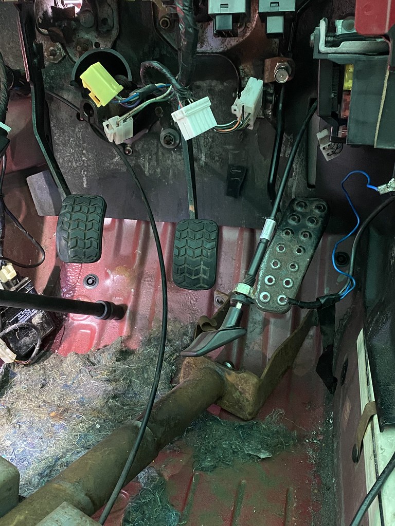

  • Fitted the manual pedal box
Imgur

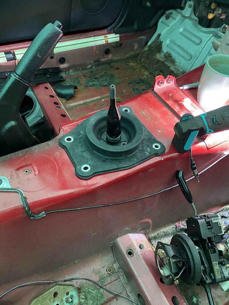

  • Purchased gearstick, mountings and surround.
Imgur

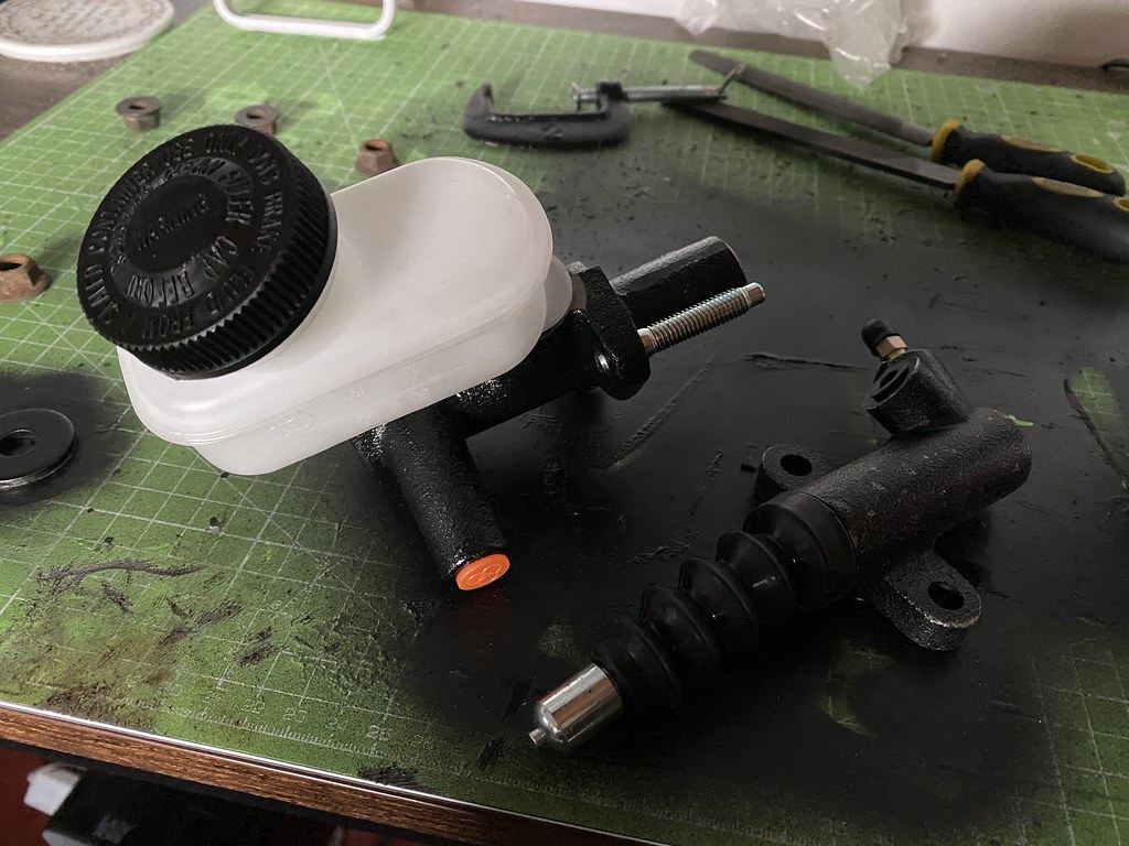

  • Purchased Master Cylinder
  • Purchased Slave Cylinder
  • Purchased Master to Slave hose.
Imgur
Now, I know where the Master and the slave mount; the troubles i’m having are:
  • Finding the correct hard line to go from the gearbox/slave cylinder.
  • Finding any diagrams of how the clutch pedal connects to the master cylinder
  • Finding a diagram of how the gearstick connects to the gearbox/slave
Does anyone have any experience of doing any of the above? Any help would be much appreciated!
Kind Regards.
Andrew
Your local garage will be able to make up the hard lines. They’re just brake lines so they’ve all had to change them with our salty roads. You will need a flexible section between the body and the engine though.
You could consider going braided. There’s no reason that you have to have hard lines, braided ptfe lines will work just as well and you can be a bit more creative with your routing should the need arise. And of course they look trick [that’s a biking term for cool or racy :smiley: ]
