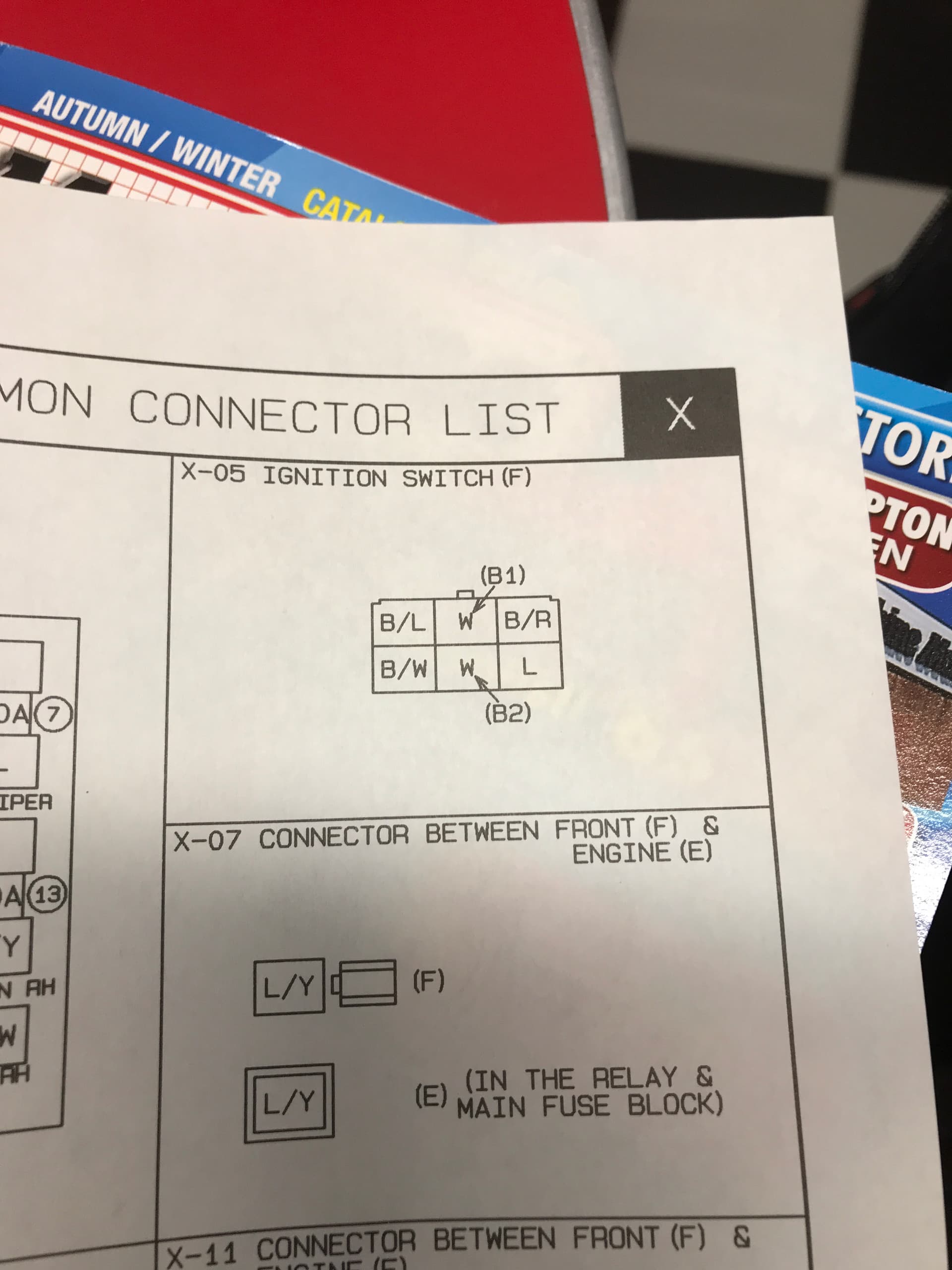

I’m not at home today so I can’t go and look. I found this picture on the IL Motorsports website, so i was semi right - one of the connectors has a pin missing, so for me to connect those incorrectly would take superhuman effort but you never know!
Even if it isn’t that, I think your’e on the right lines - its got to be to do with igntion and/or windscreen wipers.
Although, having said the above - I wouldn’t have been able to see the back of the steering connectors very easily so that would explain somewhat how I found it possible!

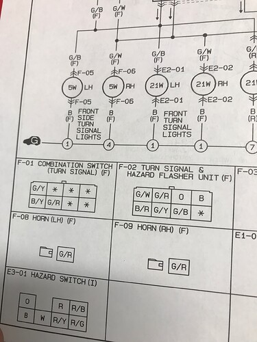

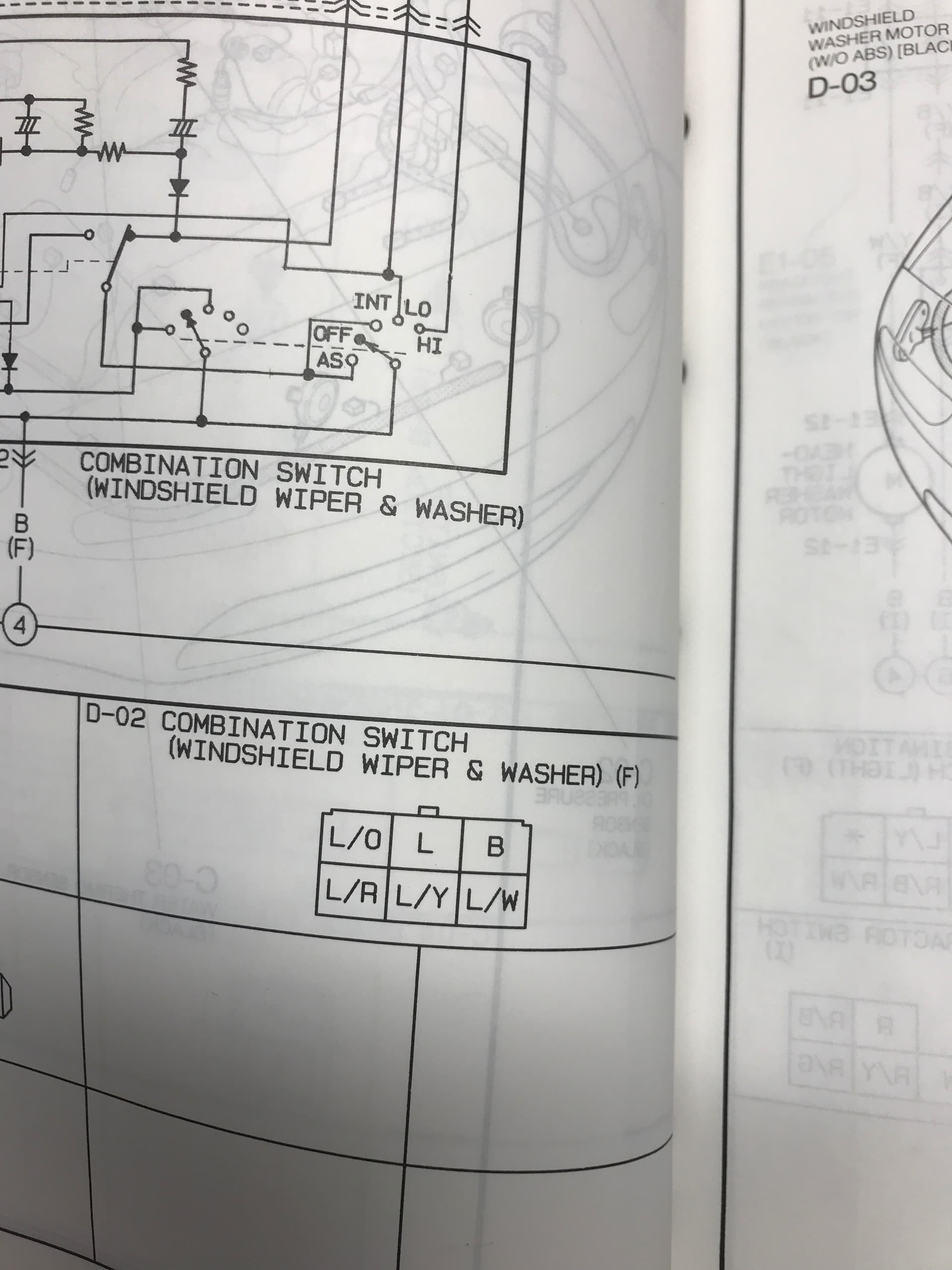

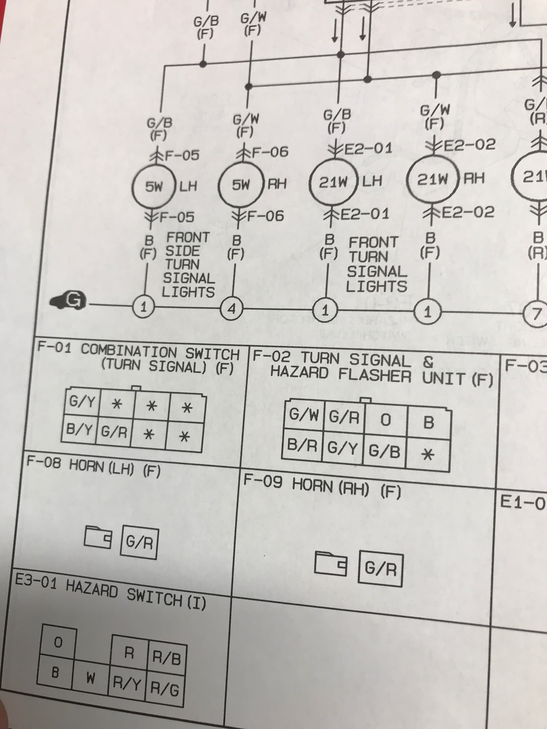

Thanks Robbie - is that for an NA? ALso what book is that in? I’ve got the individual diagrams of the wiring systems but that looks great!
It’s from my collection of porn…
Oooh porn indeed! Mine’s a Eunos so there might be subtle differences - need to find myself one of those though.
I find that the Roadster & MX-5 wiring tends to be very similar.
