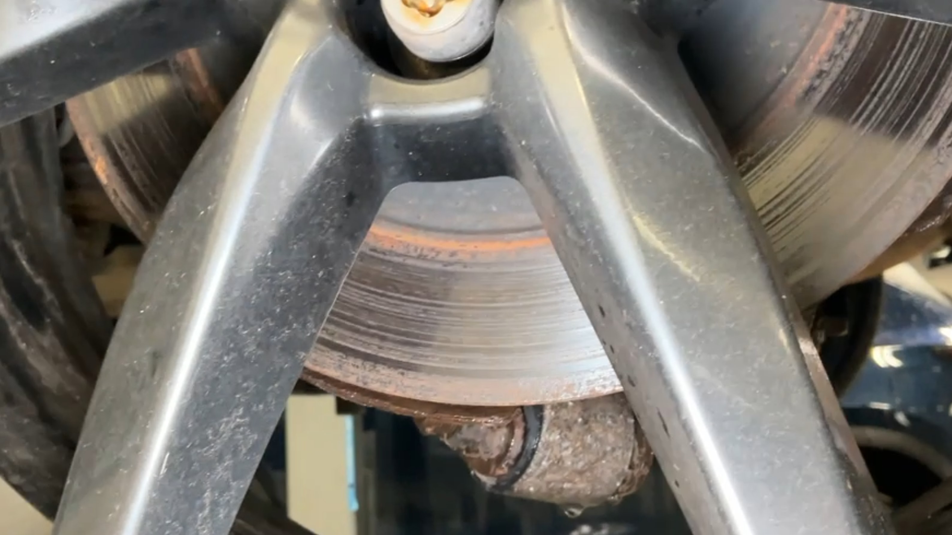

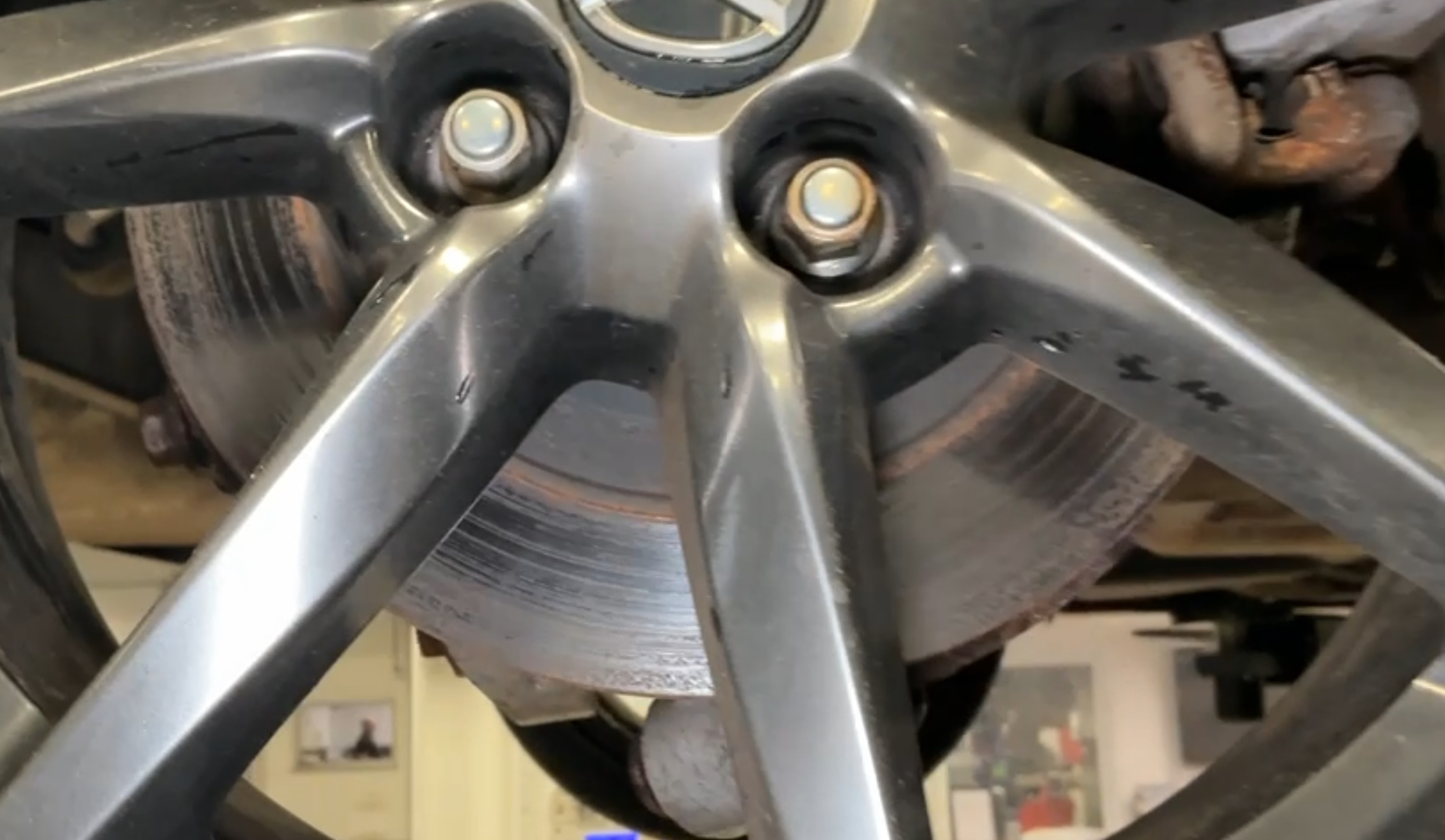

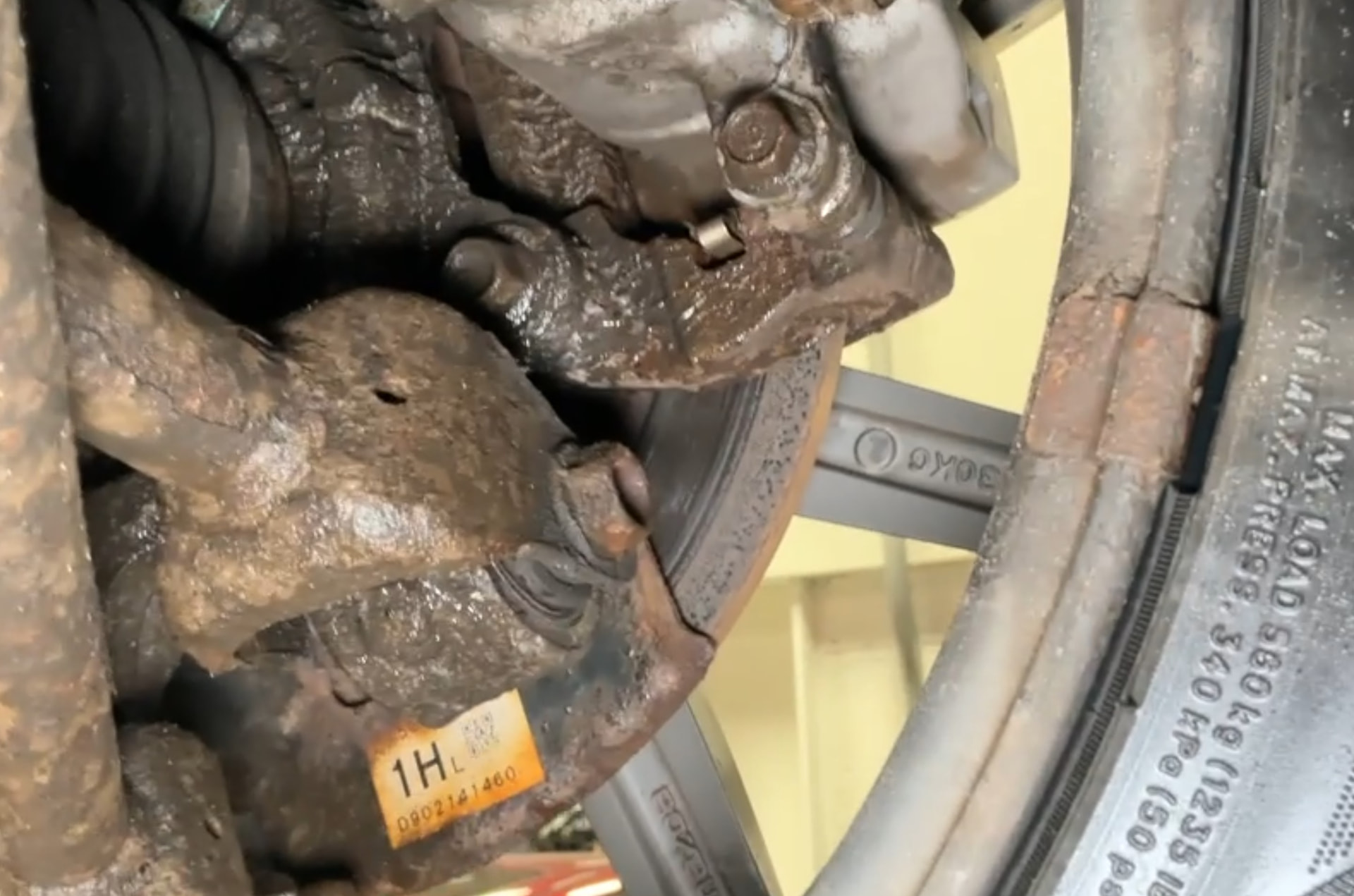

For the brakes go to an independent and ask for their opinion. I see no reason that you would need new callipers but why not post a picture of both rear discs and callipers so we can have a look.
Proceed with extreme caution.

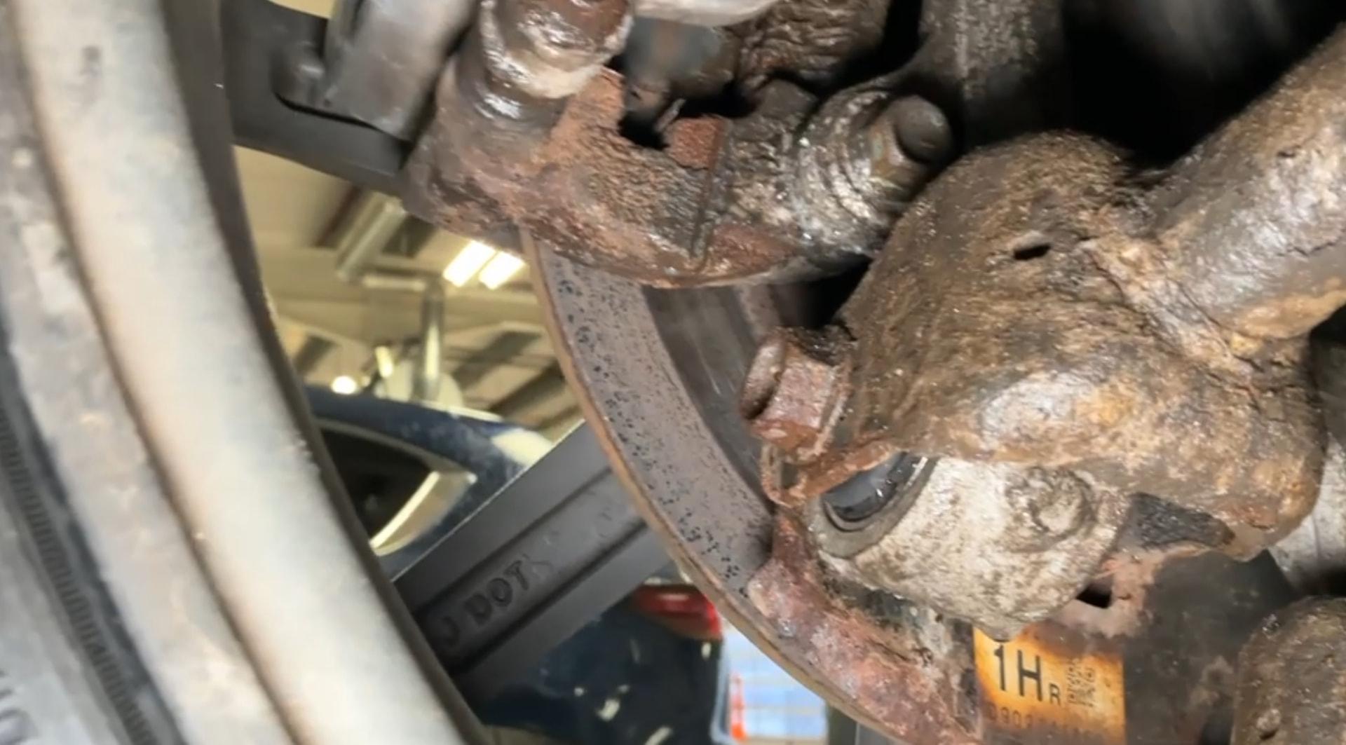

I actually have some pics of both brakes:
Left Side:
Right Side:
I’m checking and they are advising for a change of disc and pads, not calipers.
It seems quite expensive, isn’t?
Very unusual for calipers to need replacing if they are not damaged or cracked.
Unless the corrosion has got inside via a split seal, then it can be cleaned off (vapour blasting etc) and the caliper can be rebuilt.
In any case, if they are saying that the caliper is so badly corroded that they need replacing, then why have they not quoted to replace the presumably also badly corroded brake pipes and flexible couplings?

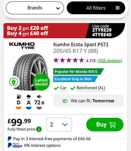

Purely my preference of brand, I am on my 5th set of this brand, recently had a set fitted to my ND and daily driver too.

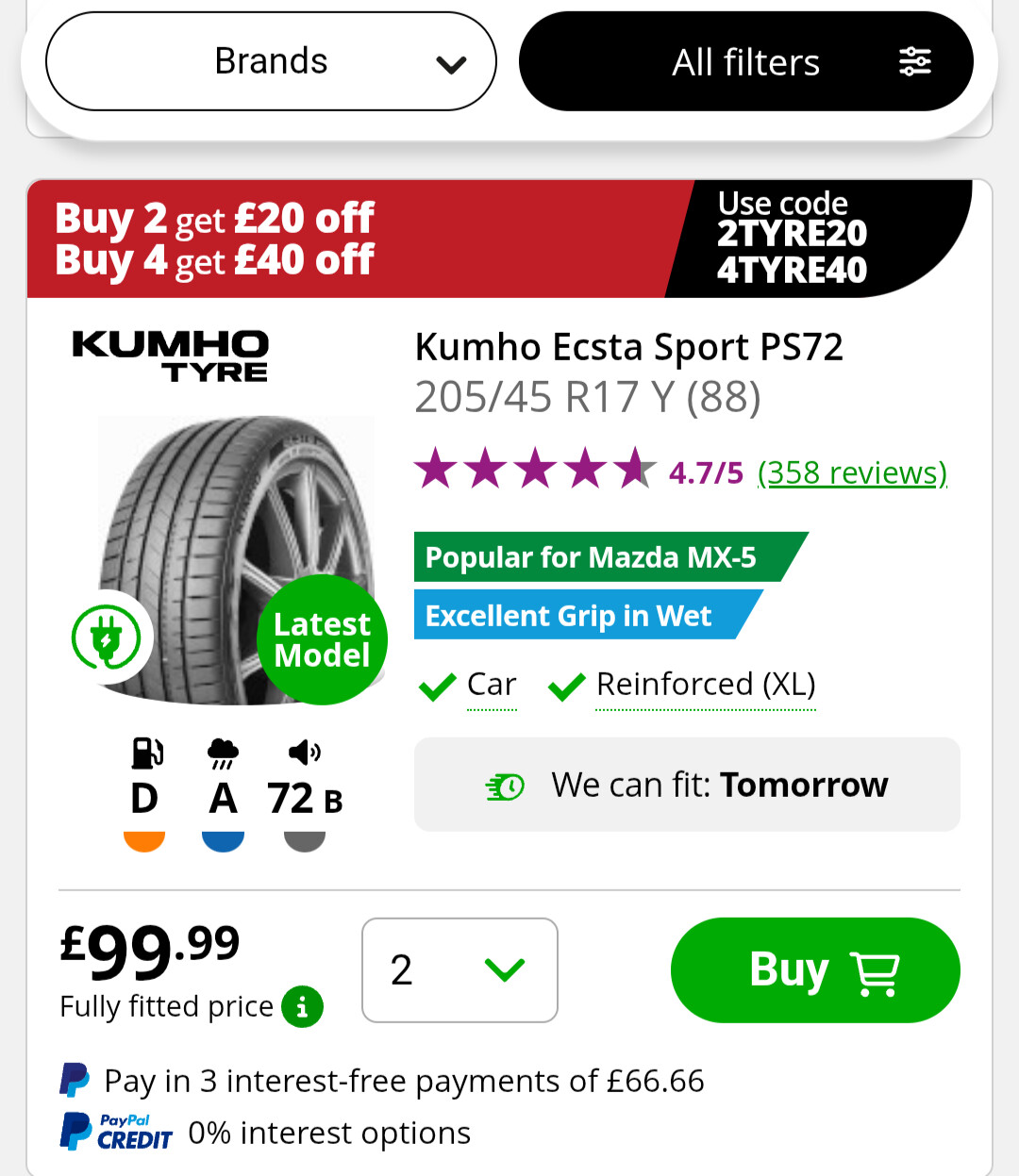

Hit the coupon code in and it brings the price down to £90 per tyre fully fitted. Or check out your local tyre fitters, do a price match as I did it. It can at times be favourable to give your local place/garage a shot at supply and fit price wise.
Sorry, edit…..that is Blackcircles the online tyre website below :+1:
May 2025- 4x Kumhos & balancing £307 ex VAT
I endorse Asda Tyres and Black Circles for tyres. often have offers of 5-10% off 2 tyres and 10% or more off 4.
Another thing I want to mention is that they brought up in the servicing is that they are advising the replacement of NSR hub carrier, for which they want to charge me 1150 pounds. I’ve found a thread about this topic in other forum and how it is not normal to need to replace it at such low mileage (https://www.mx5life.com/threads/attention-all-nd-mk4-owners.48611/). I’m trying to address this directly with Mazda UK to have them paying partially. If that doesn’t work, I’m still covered by a Vertu Motor Assured warranty I paid when I got the car and that is not expiring until next month.

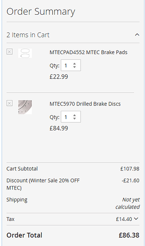

i like using MTEC. good value for brakes.
rear discs and pads for ND rear: £86 delivered.
calipers, as above ‘‘if’’ they both need doing, could be sourced 2nd hand for very cheap. if theyve already failed by 24k in your area/weather, cost effectivness will be 2nd hand as you will need to do regular replacements i suspect.
I think they are referring to the rear bushing. They can wear prematurely, not very good really for the mileage. My ND is on around 24k miles 10 years old, I may have the same problem although ATM minor movement in the bushes, I intend to inspect properly this year.
