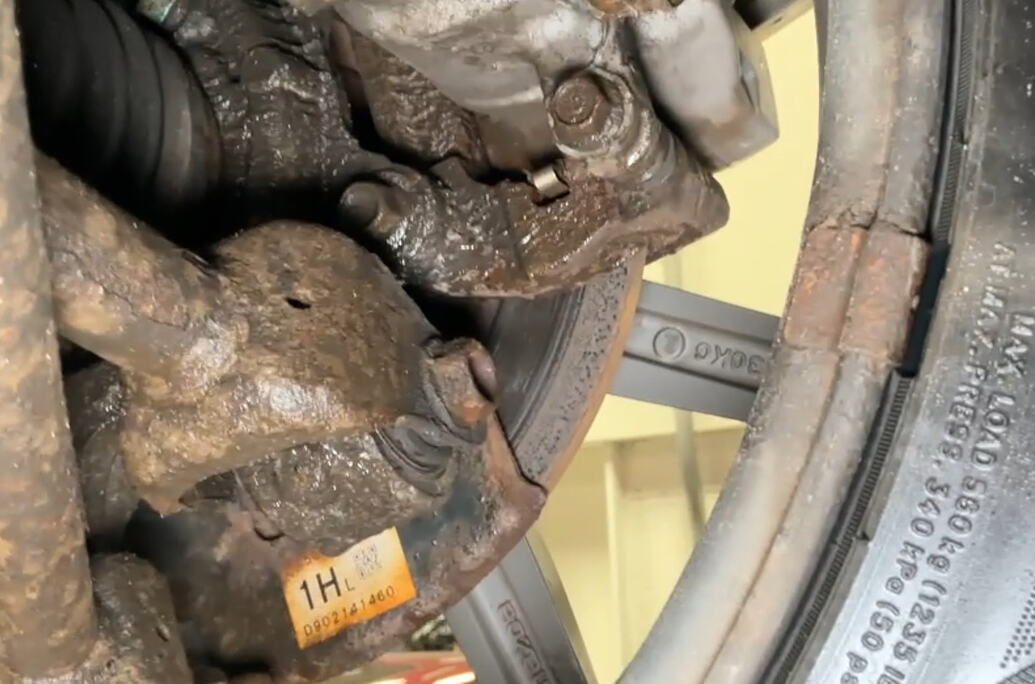

Seen your pictures of the rear discs, I’d agree the discs need replacing and add to that new pads too.
To my eyes and experience it looks like a classic case of lack of servicing brake wise. They’ve got an odd wear pattern especially the inner (back faces) of the discs. Whether the caliper needs doing is a another thing, if they work maybe just need stripping, cleaning and lubricant on the pins. I’d hazard a guess it’s easier for the garage/dealer to just quote for replacements. Being generous and guessing new discs + pads £200 plus the labour but of course you are at the mercy of the dealer and them fitting genuine stuff and whatever labour charges. I’m guessing your brakes and bushes won’t be covered by the dealer warranty you have, wear and tear.

I’d dig into the caliper ‘replacement’ a bit more. I recently changed my rear pads at maybe 38,000 miles on a 2017 car and it was like working on new calipers after a blast of brake cleaner. The discs were OK as well, although yours do look a bit rough. That said I’m not in Scotland and I don’t drive it when they are throwing salt about.
I still take it to the dealer for an annual service but I’d rather do the brakes myself so I can grease the pins and free everything up. They should do that of course, but who knows?

does anyone know what would cause this wear pattern ? (inside pad only contacting the central area of disc). it almost looks like half the pad is missing .its seems odd that it is the same both sides of the car. Is it defective pads, pads not ‘floating’ ?
Also is the general level of corrosion seen here typical of Scottish NDs ?
One that hasn’t been treated, unfortunately yes.
Seen that wear pattern before, rusty outer part of the discs and particularly the rears. I reckon it’s lack of maintenance in the past coupled with the rears don’t get cleared/cleaned off as quickly as the fronts if a film of rust appears. I’ve had it on one of my cars I think cheaper priced discs also were used on that.

They were not as bad as the OPs but I still needed to skim them and I fitted new Brembo pads. They turned out to be a bit softer (ie more immediate bite) and better at clearing the discs.
