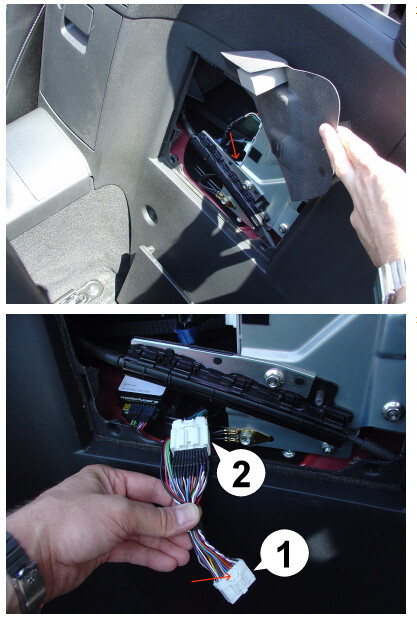

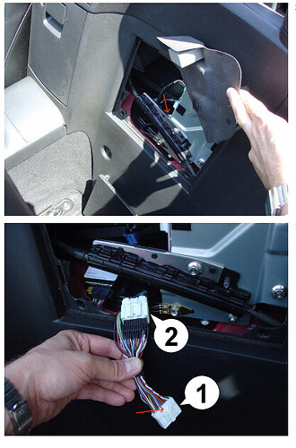

Just tried fitting my SmartTop roof module. I managed to remove the access panel, but got a “Fail” when I tried to remove the existing bottom wiring clip.
I’d like to know which contortionist with a dark sense of humour located that clip where they did! It is marked by the red arrow on this piccie. But the clip to push in is on the back side, with very limited access. I find I simply can’t push it in, and also wriggle the electrics loom clip loose.
Does anyone have any thoughts, other than “grow an extra hand”?
I found it easier removing the metal plate in front of the module , and I think got to the clip with a stubby flat blade if I remember correctly . Hope this helps
Kev
Have a look at the recent update by @David-H here.
I found it impossible to unplug the required connector with the OEM controller in-situ, and so resorted to removing the 10mm AF mounting frame bolts. With that loose, it was just possible to wriggle the module out, rotate it to access the securing clip, slide a thin jewellers screwdriver that I had ground down earlier to resemble a very thin chisel to release the locking tab and finally pull the offending connector out. After that, everything was easy-peasey.
I hope this proves to be useful.
Laurie

My MX5 is an NC2 and touch wood (hand on head) this gizmo is working well, love it. No idea how you’ll get on fitting it in an RF but access on the NC was dire until we just took the existing module out of its lair (I hadn’t read of anyone doing this before) hence benfieldl’s comment above, the link will take you to my photos.
Best of luck

As a matter of interest did you manage to disconnect the white plug in situ or as I did, remove the whole gubbins from the recess do the disconnect and reconnect then bolt the unit back in the recess?
I did it all in situ, while doable was a bit of a pain.
If that plastic back panel came straight off, I could have done it in 10 minutes instead of 20.
