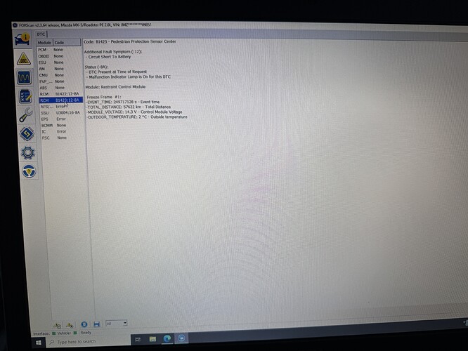

Went to start my ND1 a couple of days ago and it wouldn’t switch on/go to ignition ACC. I removed the battery and charged it. The car is starting ok now but the active bonnet system light is flashing a pattern = 4x then 1x and repeat. I’ve driven it 10 miles and it’s still flashing and I’ve disconnected the battery again and still flashing.
I plugged it in to my laptop via a wee ELM427 cable and software I downloaded earlier. I cleared the DTC/codes, but the bonnets system error keeps reappearing.

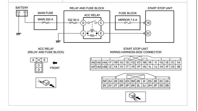

I plugged my car in last night and got a code:
U3004
This corresponds to a start stop unit that my car doesn’t come with. Googling the unit brought up this diagram/
I noticed that it goes through the heated mirror fuse. I opened the fuse cover inside the car and noticed that the dash cam was piggybacking off this particular circuit (proper Nextbase wiring kit). I removed the adapter and just connected the fuse directly.
Now my audio system is working again :ok_hand:t2::ok_hand:t2::ok_hand:t2:
