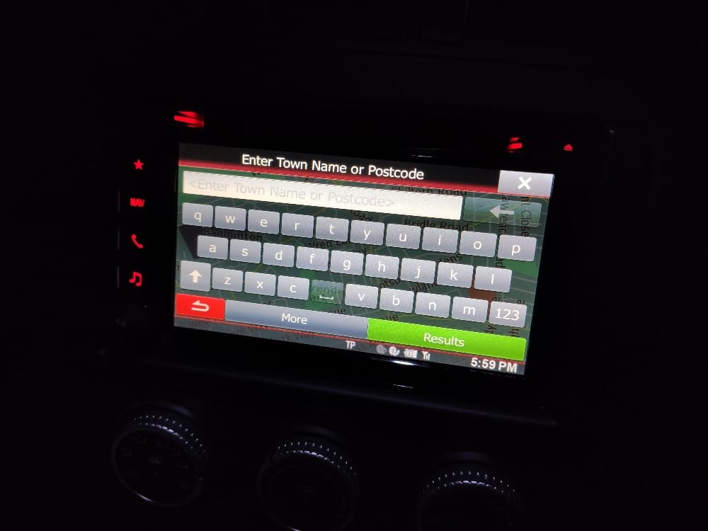

If I can remember, the file I need is from the NAV side of it. If you could just copy all the files from that file folder, I’ll rather just replace your complete working files into my damage structure.
The NAV files don’t affect the Alpine firmware.

You’ll need to be a bit more explicit about how to extract the specific files (or where they are in the file structure) - I’ve read this thread, and all 17 pages of the German Mazda forum which are mentioned above, but I haven’t actually done anything with the file system yet…

According to post #39 on this German thread the files that you need to reinstall are ALPINNAVI,EXE, DATA.ZIP and BRANDING.ZIP. (There are actually two copes of ALPINNAVI.EXE, one in the APP! directory and one in the APP2 directory - they have different sizes.
I’ve zipped all of these up and put them on my ftp server for you - I’ll send you a link by PM.
According to the same forum, you may also need to do a reset (either using the button behind the removable panel or by choosing “factory reset” from the menu) before the keyboard reappears.
Thanks for the detailed help! Will give it a go later.

Thanks to Philip and going out of his way to help me, I finally have my NAV up and running again and can input an address!!! :+1: :+1: :+1: :+1: :pray:
Ended up using his system files to replace my corrupted one and now all working.
