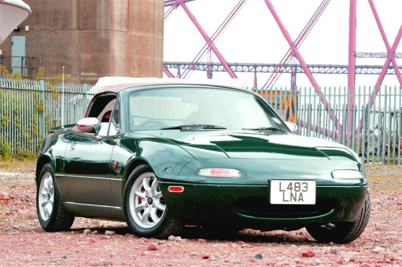

If you can get your headlamp poppers aligned ( easy peasy) you can see form mine how it smooths off the nose.
Best aspect of your car, to my eyes, lies in it’s simplicity & originality. It’s what people want these days.
Very nice car – I think my car would have had that colour hood originally – mine is a Monaco, but the previous owner replaced it with a new black mohair one.
Good tip on the lights too – it’s actually going into a specialists this week for its yearly service, so might add the lights onto the list.
You can do the lights yourself in 3 minutes.
Pop the bonnet, grab the leading edge nearest the engine of each, be hail & hearty and pull them up tillthey seem a bit proud. Close bonnet, and re-press the leading edge back down with palms of hand till they are flush. Rinse and repeat until perfection is achieved.
We shall inspect your efforts in due course.
It’s really that simple. We all do it.
