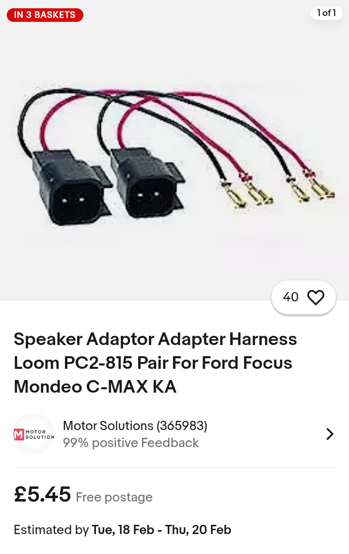

If you’re using an adapter harness it’s dead easy, simply unplug the existing speaker, plug the adapter into the plug that was originally connected to the speaker and then connect the two wires to the new speaker. The terminal/spade connectors on the adapter are different sizes just like the terminals on the rear of the new speaker so they won’t fit if you get it wrong.
For my door speakers (JBL GX) I bought from flea bay
MK1 ford Focus speaker connectors.
Spade fitting onto speaker, block plugs directly into Mazda loom.
I’ve an NC1
I must say I diligently bought those adaptors, then found they were completely wrong once I got the door apart and just soldered the speakers like I had originally planned. It’s not like I’ll take them off very often.
