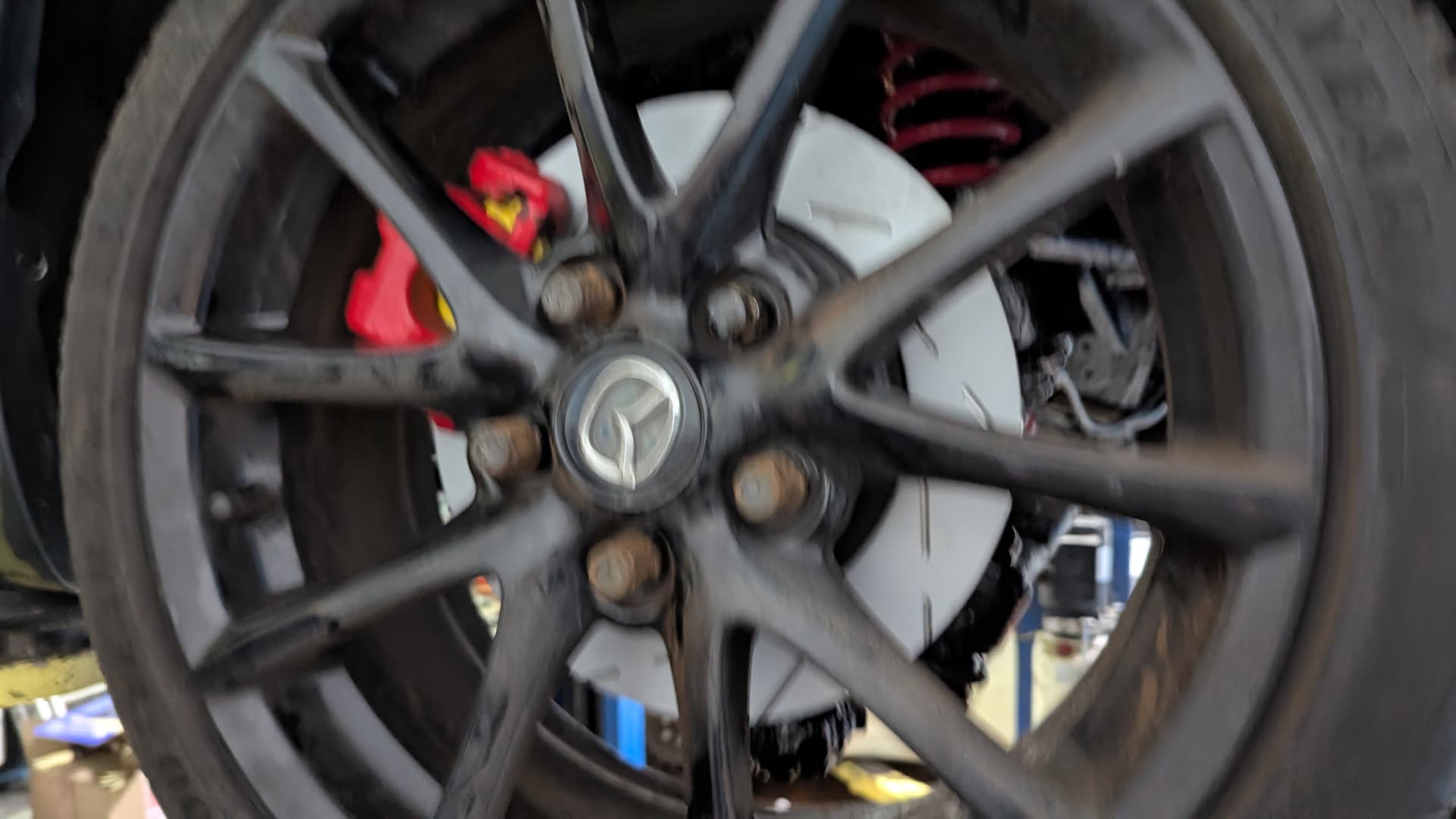

Yes the drop links and ARB are IL Motorsport , bought from mx5parts. I haven’t driven it yet, she’s still up on the ramp, rear discs swapped out for EBC discs and yellow stuff pads

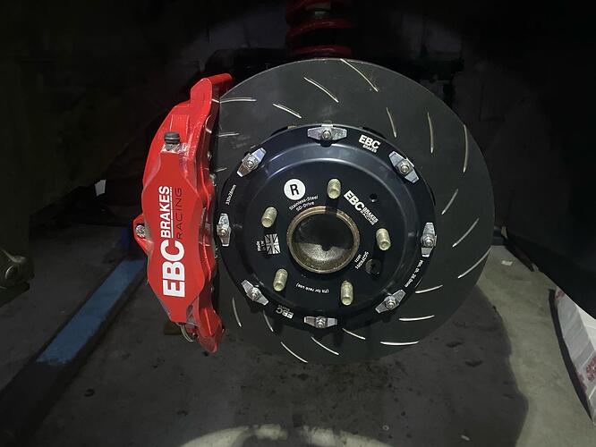

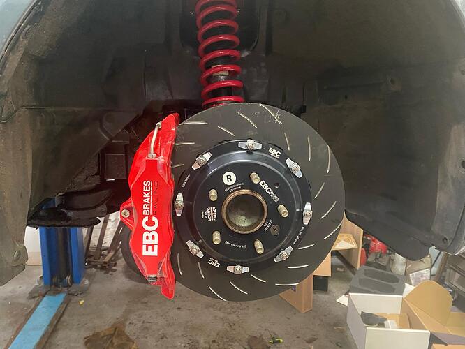

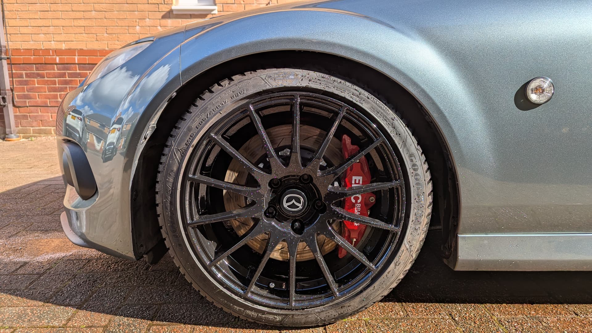

Called mx5 parts and they couldn’t advise if the calibre suzuka wheels would fit over the EBC BBK.
Ended up calling rimstyle, emailed them the BBK template and they confirmed the calibre Suzuka wheels don’t fit over the Apollo brakes. Sent them a few selections of wheels and none of them go over the Apollo BBK.
They sent me back some choices of wheels that do fit over the Apollos…
I had a choice of 5 different wheels in a style similar to that I liked, however one was 8" wide and as I’d had new tyres fitted when I bought the car less than 1000 miles ago I opted for 7.5" wide.
Out of the 7.5"s only one style is available within a few days so I’ve opted for a set of Fox FX004 in Gloss black.

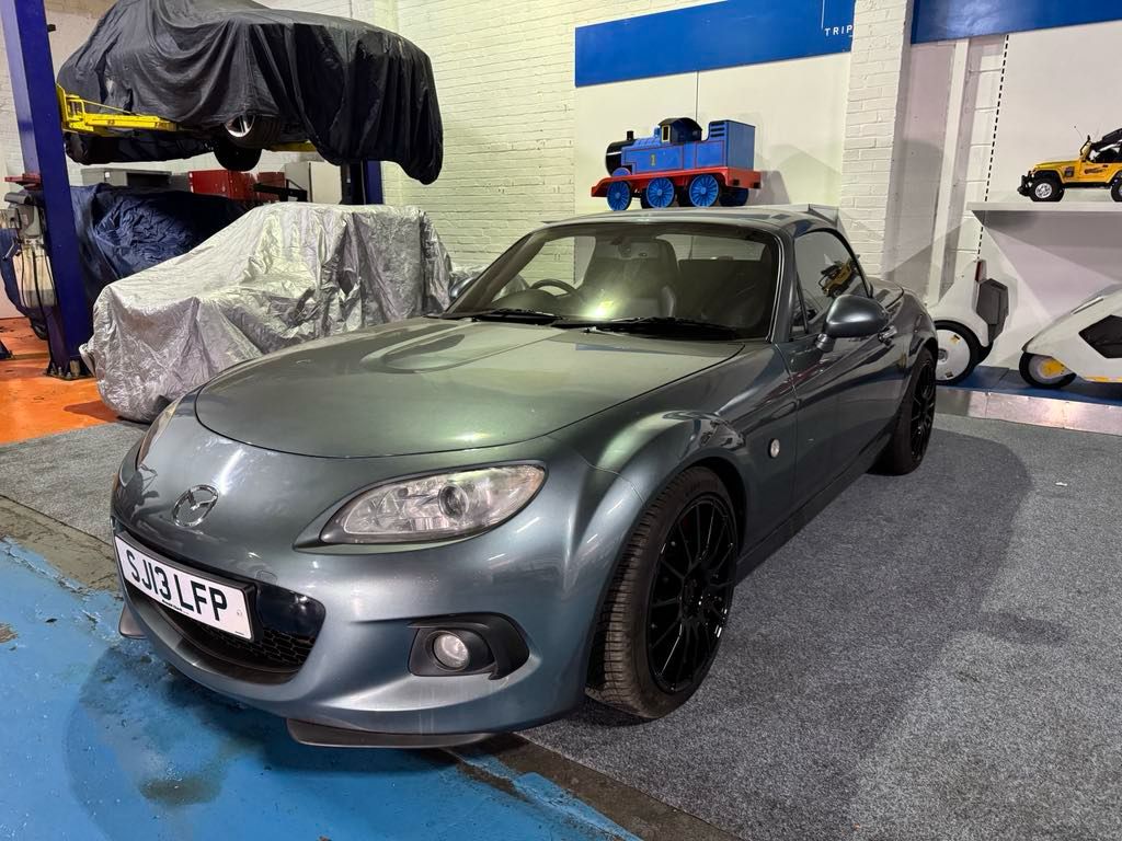

Until they arrive middle of next week the car is kind of talking up a two post ramp.

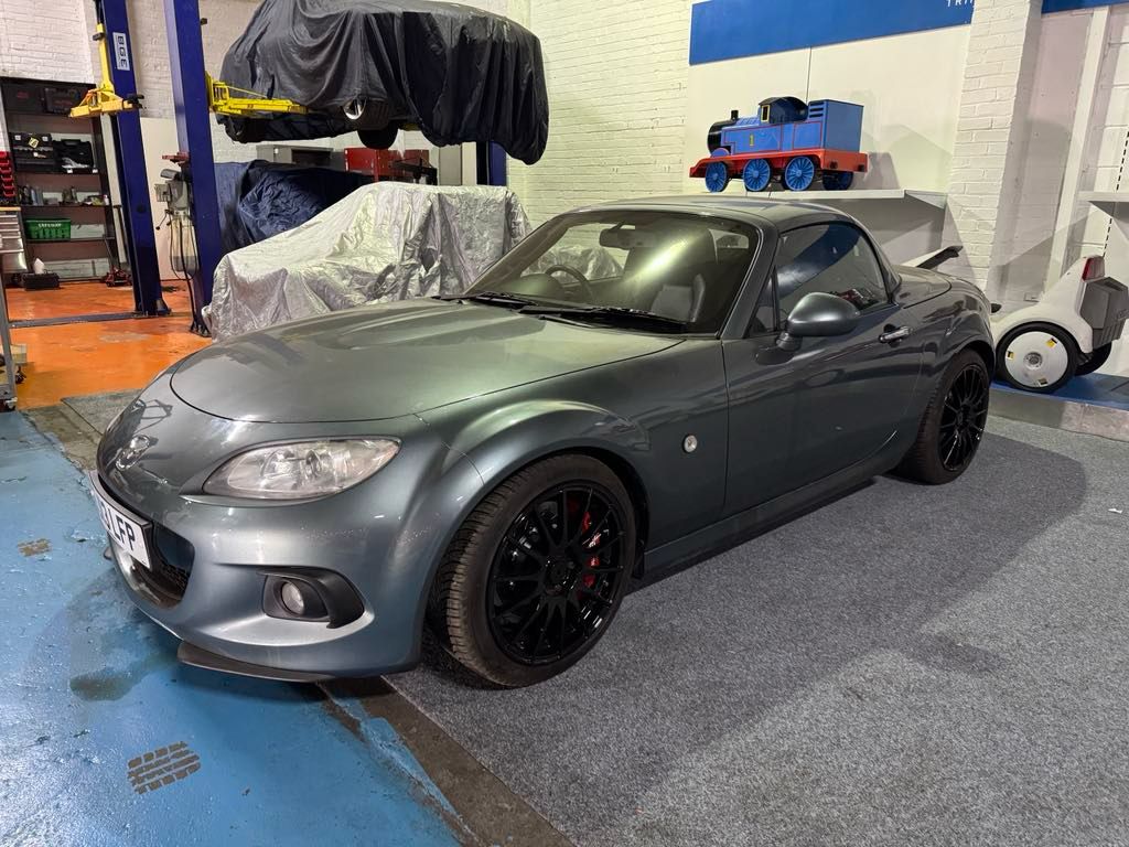

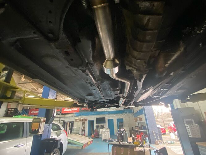

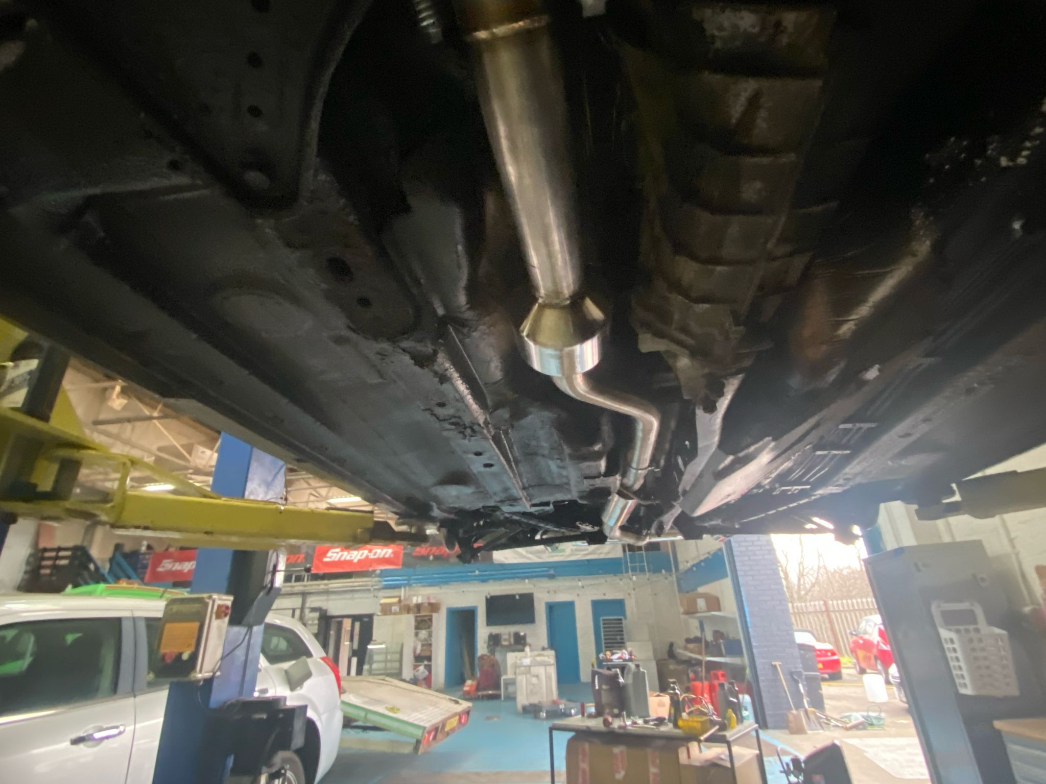

MOT passed no advisories.
Service done.

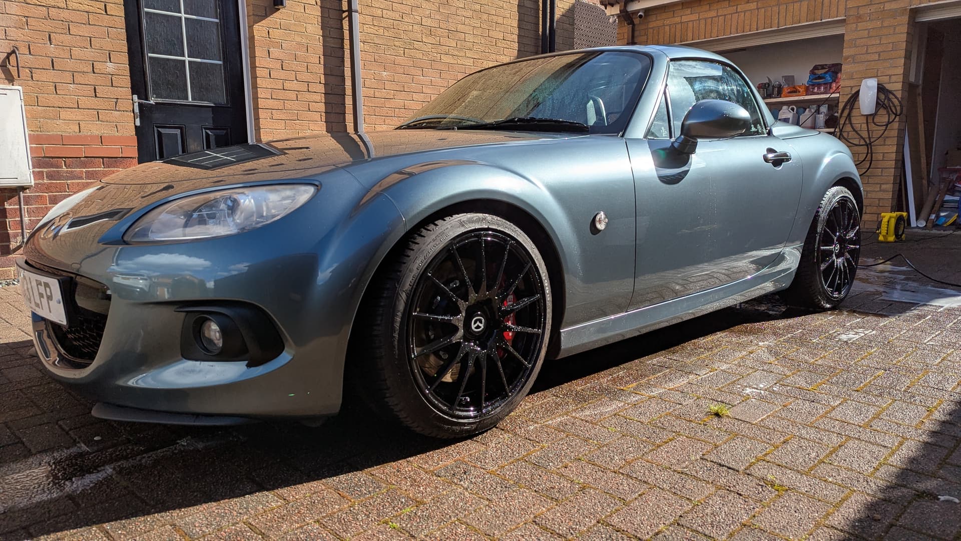

Wee drive about the B Roads, think it’s a little too low, may have to raise the suspension a wee bit.

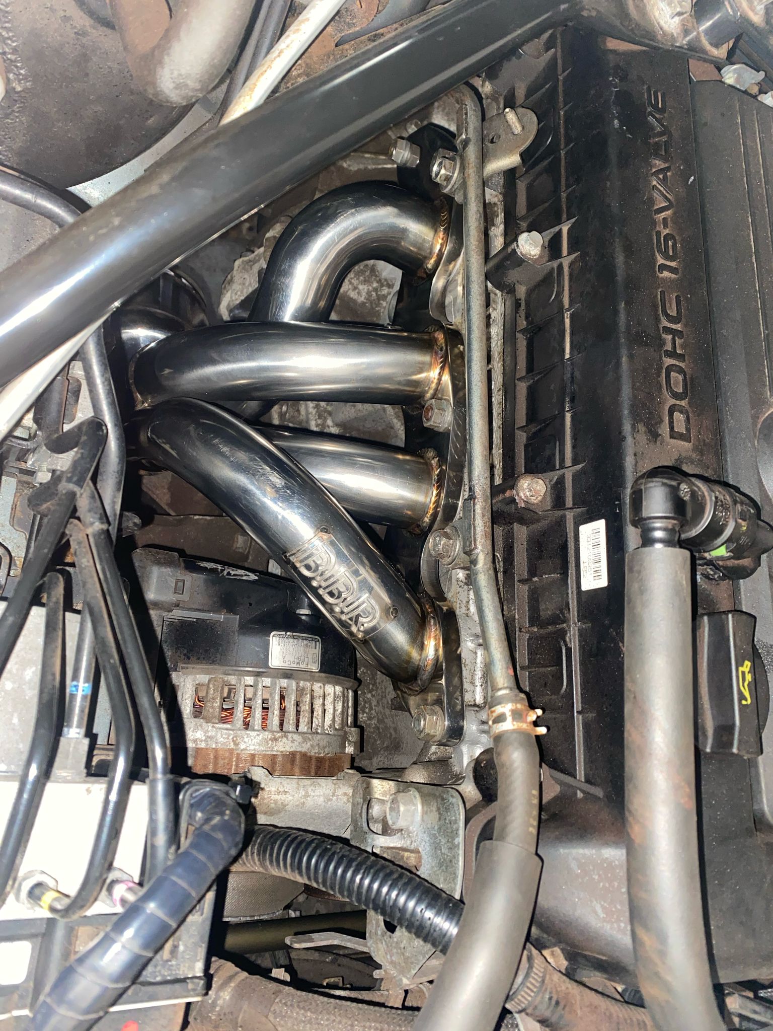

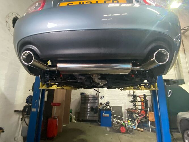

Lovely sound from the BBR touring exhaust, I love how the wheels fill the arches and the BBK looks very purposeful. I’ve put Mazda gel badges on and I think the car looks OEM+.
Heading for geometry setup at he end of this week, then get some miles on before Supercharger install.

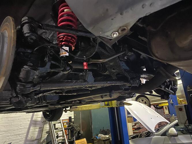

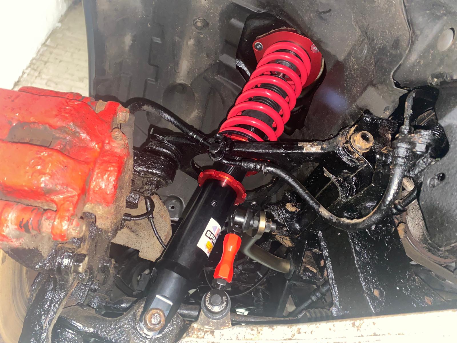

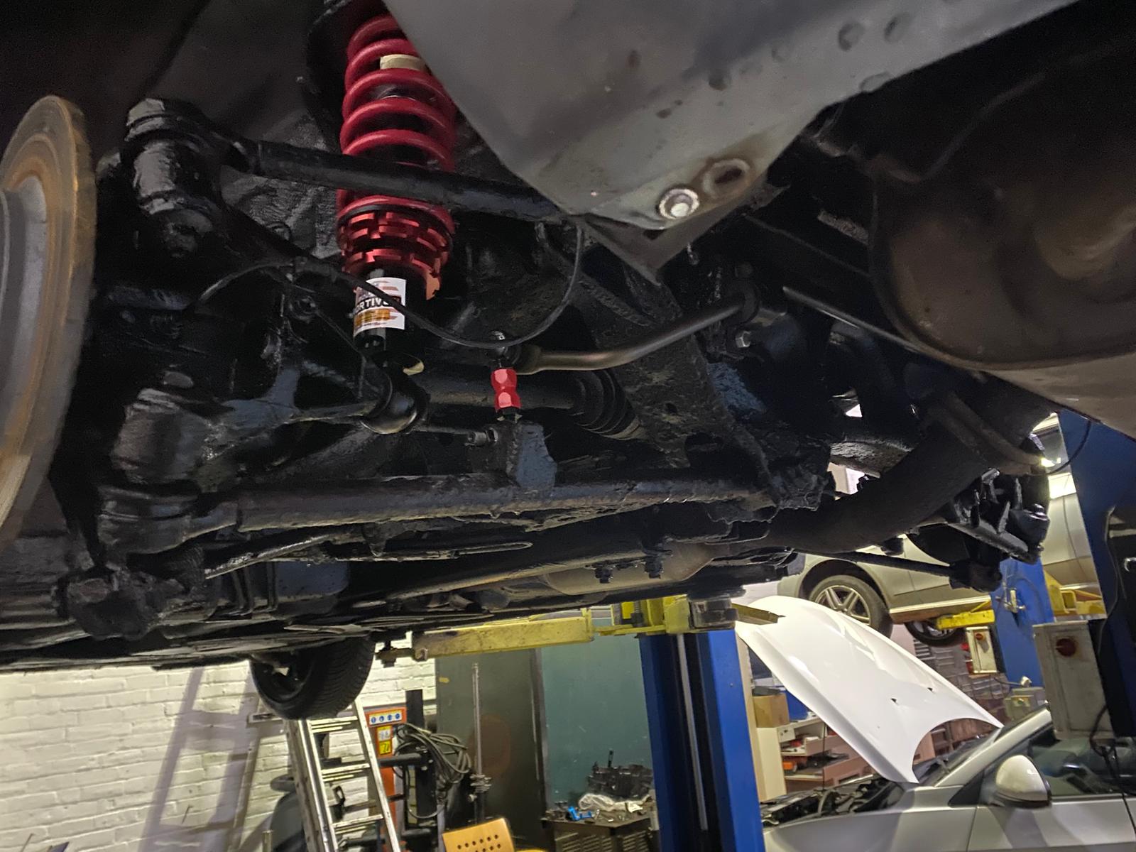

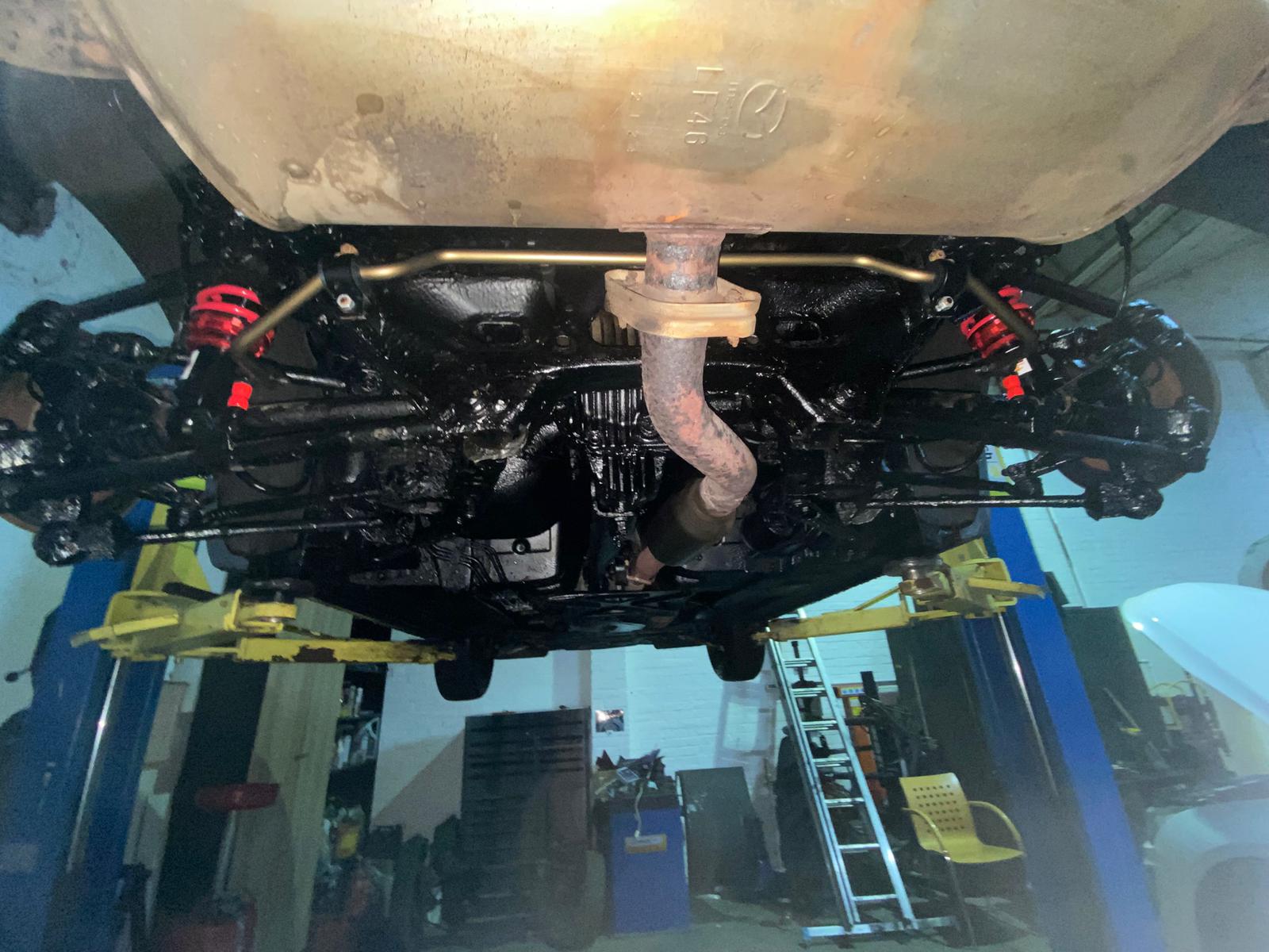

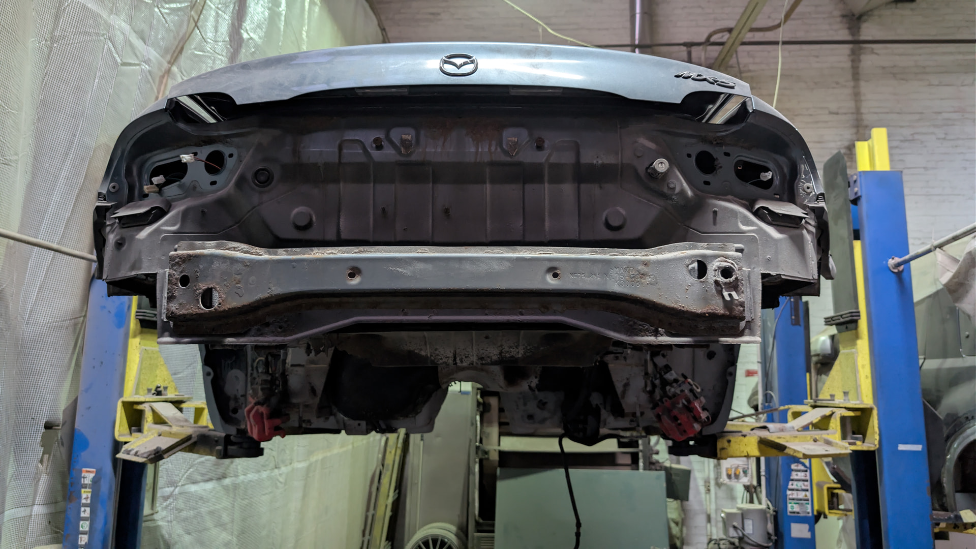

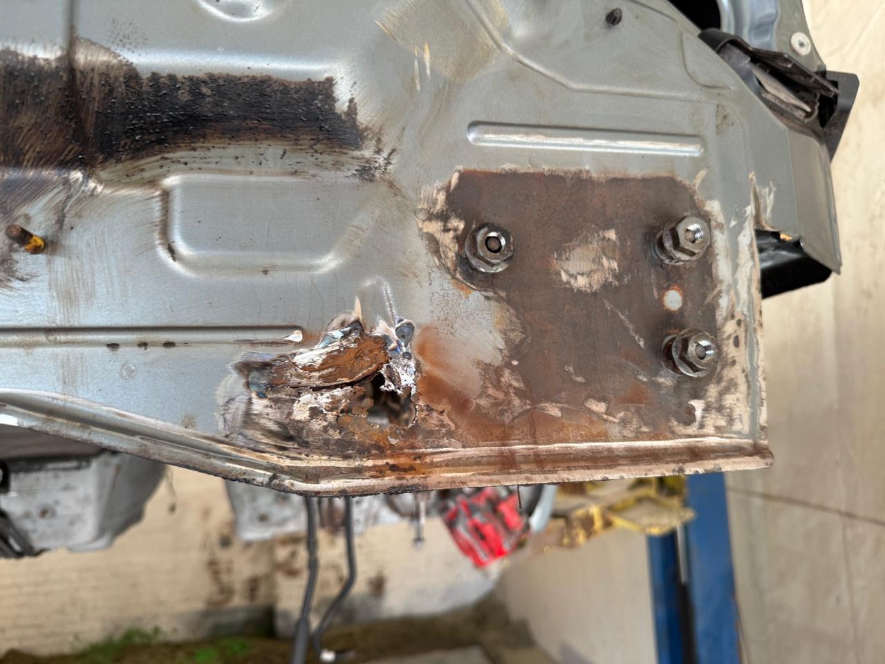

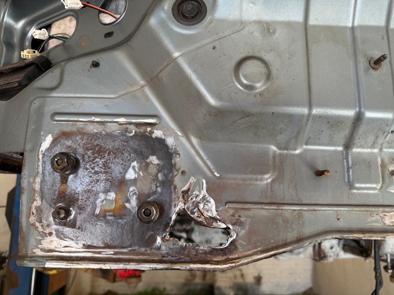

I got fed up with poor state of the car, an absolute mess, the sheer amount of coating was annoying the hell out of me. Wish I’d realised how poor a job the underbody protection I had done was, before starting to fit all my project parts. Anyway, I am where I am.

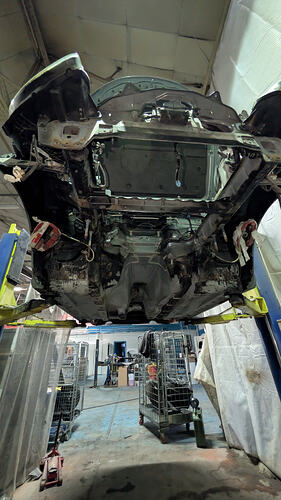

After some serious work undertaken by friends and I, over the last few months, between other things, we are almost finally back to the metal (rear bumber / crashbar still to come off) and have found an appalling state under the car that was, as I thought, solid and protected.. Make your own mind up.
Next steps: rust converter, welding, and start recoating, and reassembly of the car.
This mess was hiding under the coatings…..Make up your own mind from these photos. My Advice would be dont waste your money on coatings unless you go back to metal first….
How is the BBR manifold, it’s the catted one right? I’m thinking of upgrading mine but I’m struggling to decide between cat and non-cat, my concern is not having issues with the MOT but I’m also wondering if the catted one offers less performance.
