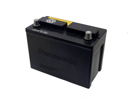

Hi - Sorry, I don’t have a part no. for the battery, (I just asked my Mazda main dealer for the OEM battery for an NB).
It’s this one:
Yes, they are local to me and I’ve used them for years. I would have no qualms recommending them.
I usually use Tayna but the size they list for the Mk2 I don’t think will fit properly, the clamp would need adapting. The original Panasonic battery is listed by MX5parts at £130 as above.
People buy standard batteries and adapt for them because they are cheaper and usually higher capacity, but the ‘right’ battery is the Panasonic.

So the Panasonic via MX5Parts
Loads of Not Fun trying to re-establish connection with the official site as it’s been a few years since my last order with them [won’t bore you with the details] BUT got there in the end
Parts No is: SI [Sierra India] 7456
£129.95
£9.95 [shipping]
£23.32 [VAT]
Total: £139.90
I’ll take that !!
