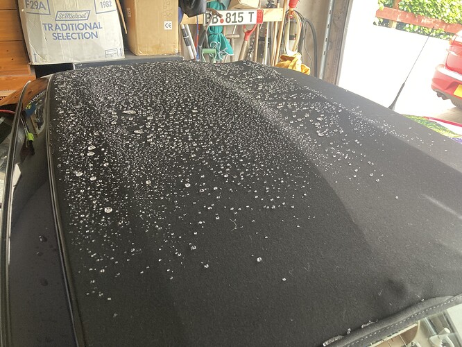

Autoglym…. fairly happy with the beading, but still would prefer the cloth to look more “black”……. I think I’m going to have to go the re-colouring route next time, prob Renovo….?
