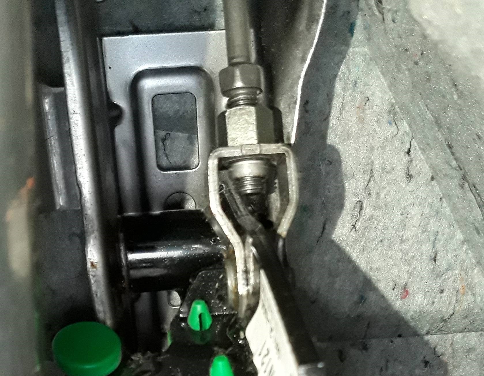

I’m over six foot, arthritic and elderly yet can now manage it quickly and easily in less than five minutes, but only after I took half an hour of experimentation to work out how. My secret is to borrow a comfortably padded wide stool from the bathroom.
Slide the driver’s seat as far back as it will go. Place the stool beside the car, top surface level with the top of the driver’s door sill. Posterior and hips rest on the stool, lying on one’s back under the steering wheel, wriggle in hands first followed by arms, head and shoulders, and if no assistant is available, make sure all the spanners, work light and reading glasses are already in position.
Operate the two spanners like scissors to release the lock nut from the captive nut of the U-bracket holding the clevis pin, but don’t stress the U-bracket, pin or pedal! Same trick to tighten after adjustment.
A small long-nose vise-grip just dangling from the small rod nut is useful to help remember the rod position in the desired setting when moving the lock nut up the rod and finally tightening it against the U-bracket.
The U-bracket itself needs a big (22mm) spanner on it holding it still, the lock nut the other (12mm) spanner moving.
This is a view looking up at it, a camera gets into a better position than one’s head!
