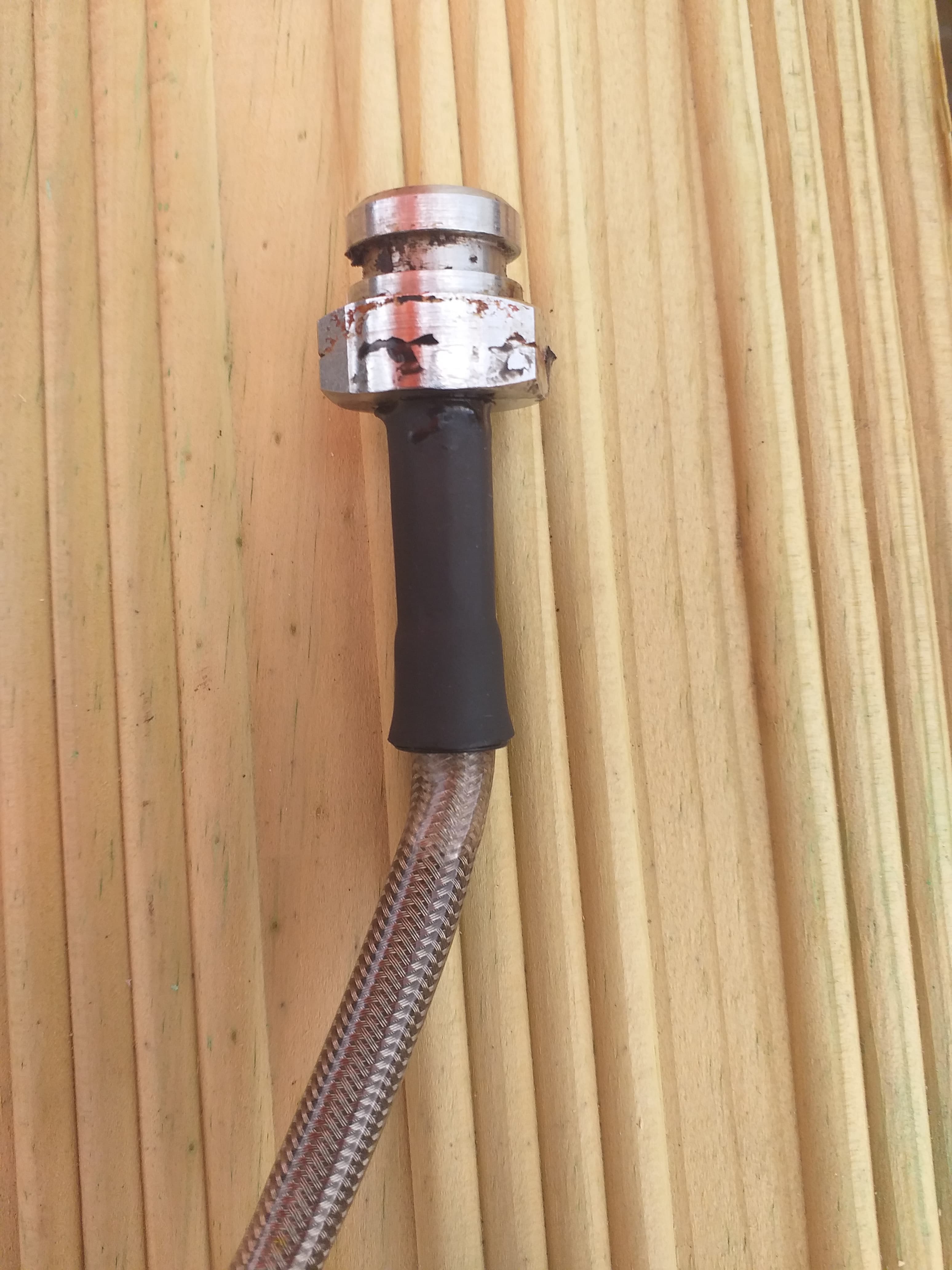

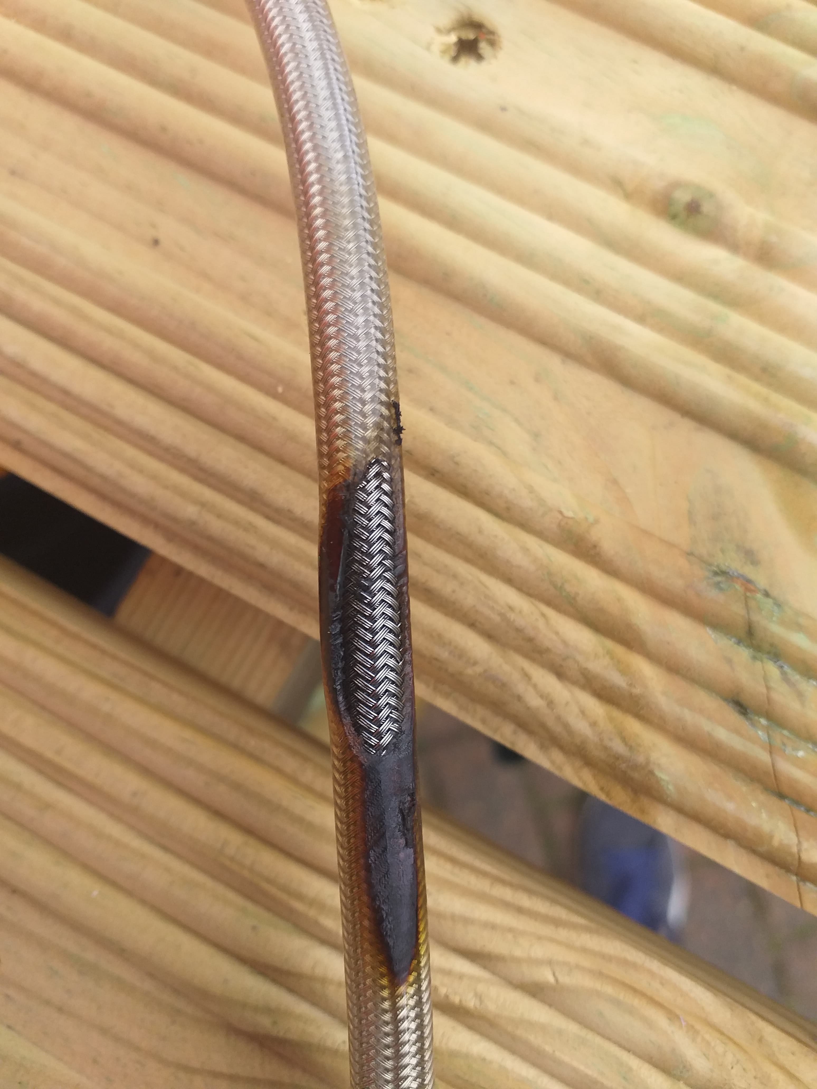

Evening Malc, Thanks again for your consultancy :star_struck:.
Look what I found today when I removed the front nearside flexi :scream:.
Goodrich ss hoses fitted November 2021 at 68k miles I’m now at 75k miles so 7k miles and 4 years life.
Im grateful it didn’t result in something more serious I’d have been gutted.
Regards
Nic
Good spot there Nic. Glad that my personal experience has been of practical use.
PS I was tempted to say ‘found in the nick of time’ but I resisted!!
:heart: :heart:

You’ve been very unlucky here, especially if both Goodrich hoses failed so early in their life and at the same time. Or perhaps lucky, in that you didn’t have just one fail and make that side brake harder than the other.
How happy do you feel about continuing to use those pads, which have now been overheated multiple times and for a fair length of time?
Thanks for your reply.
On inspection of the Drivers (offside) Goodrich flexi there is heat damage midway along the hose. I need to investigate further to establish if there has been a core colapse as with the nearside.
I took the decision based on my Aeronautical Engineering background to Inspect the Calipers, I did this and at the same time replace all four slider pins. After further consulting on the forum I have also now replaced the discs and pads with Brembos whilst also returning to Mazda OEM brake hoses - Test Drive today, but it feels 100 % better on the pedal already.
