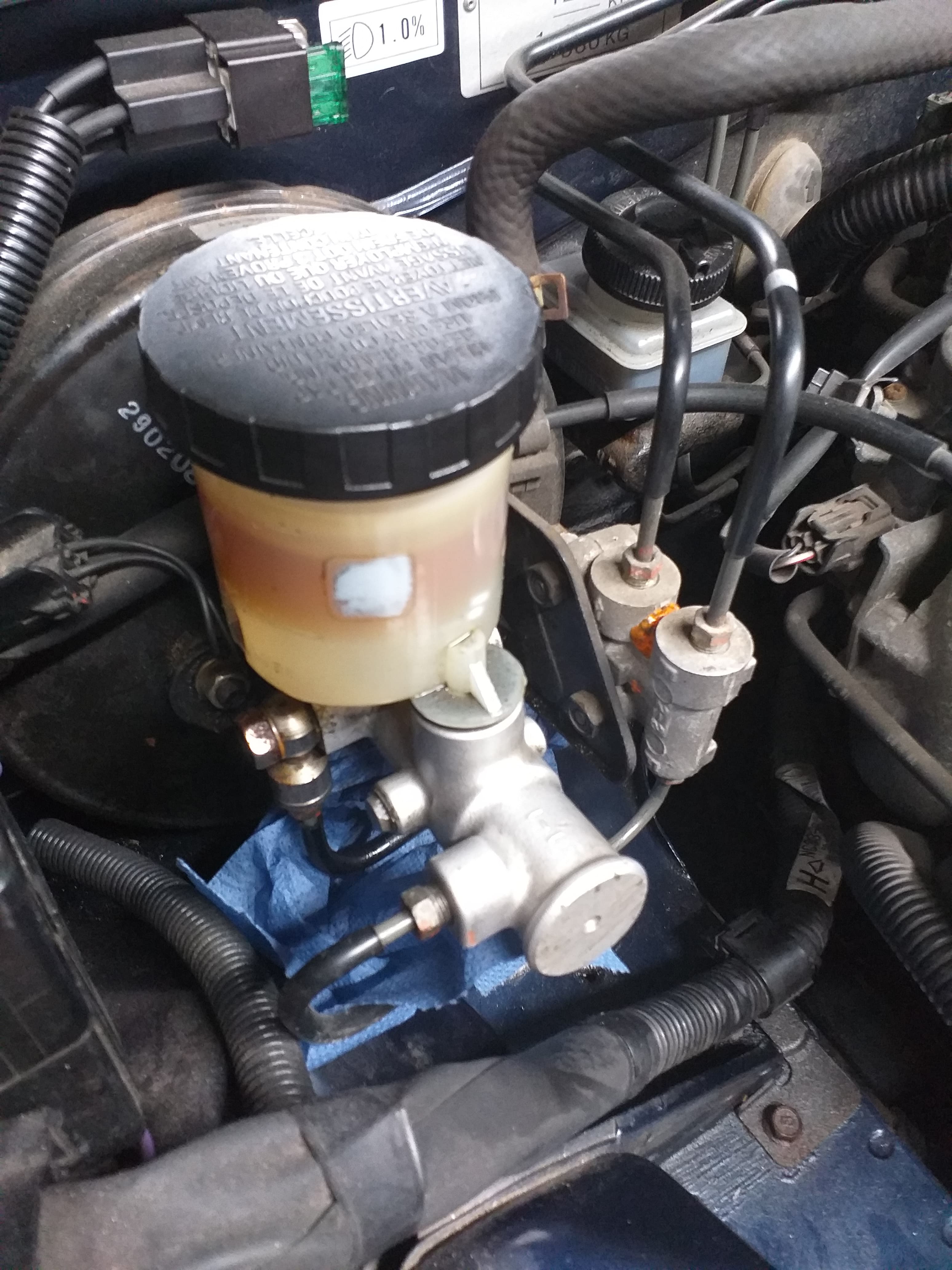

Evening All,

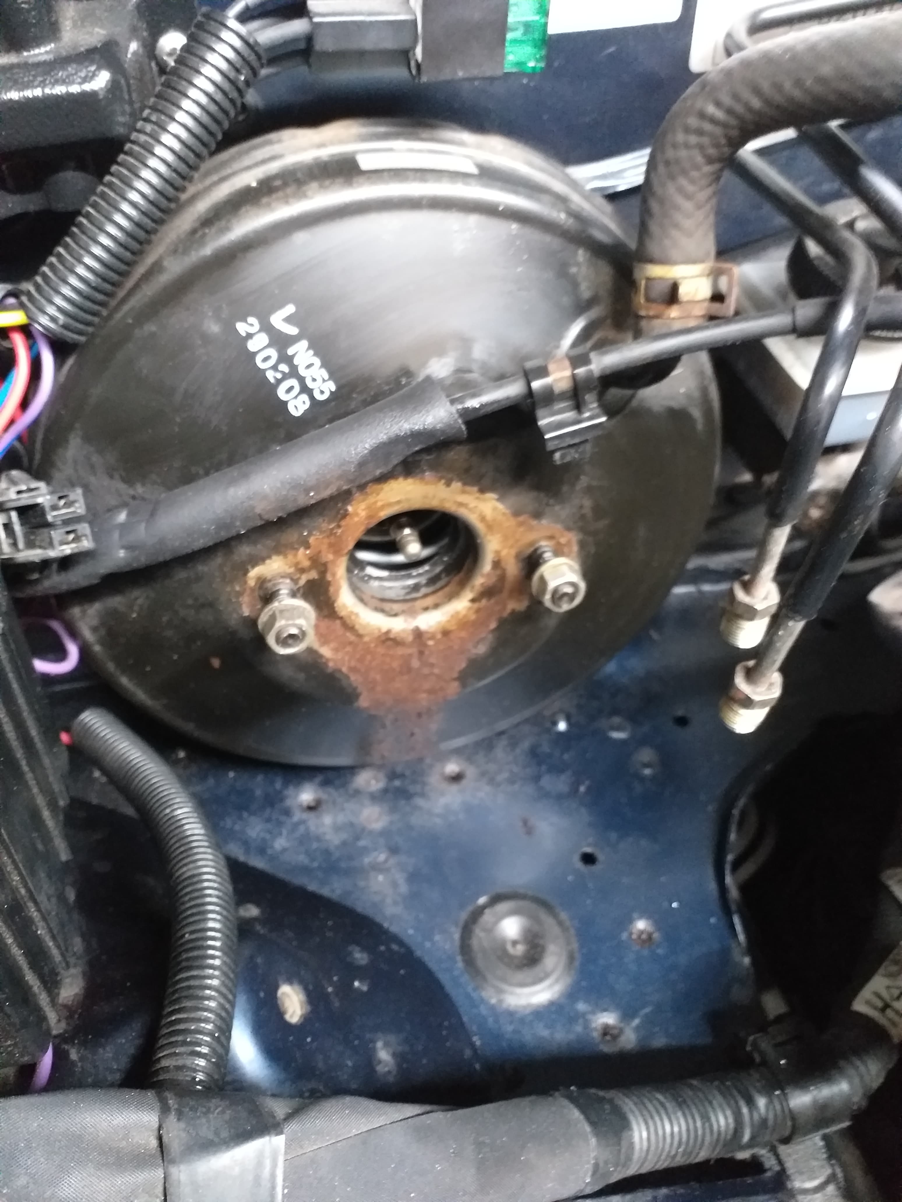

Continuing the above thread, I’ve now got the master cylinder off the servo - what a job. With it removed I see a rusty deposit around the hole running down the servo.
Ive ordered a master cylinder repair kit from BOFI racing and wondered if anyone has experience of doing this? And also with this level of strip if it’s worth removing the servo?

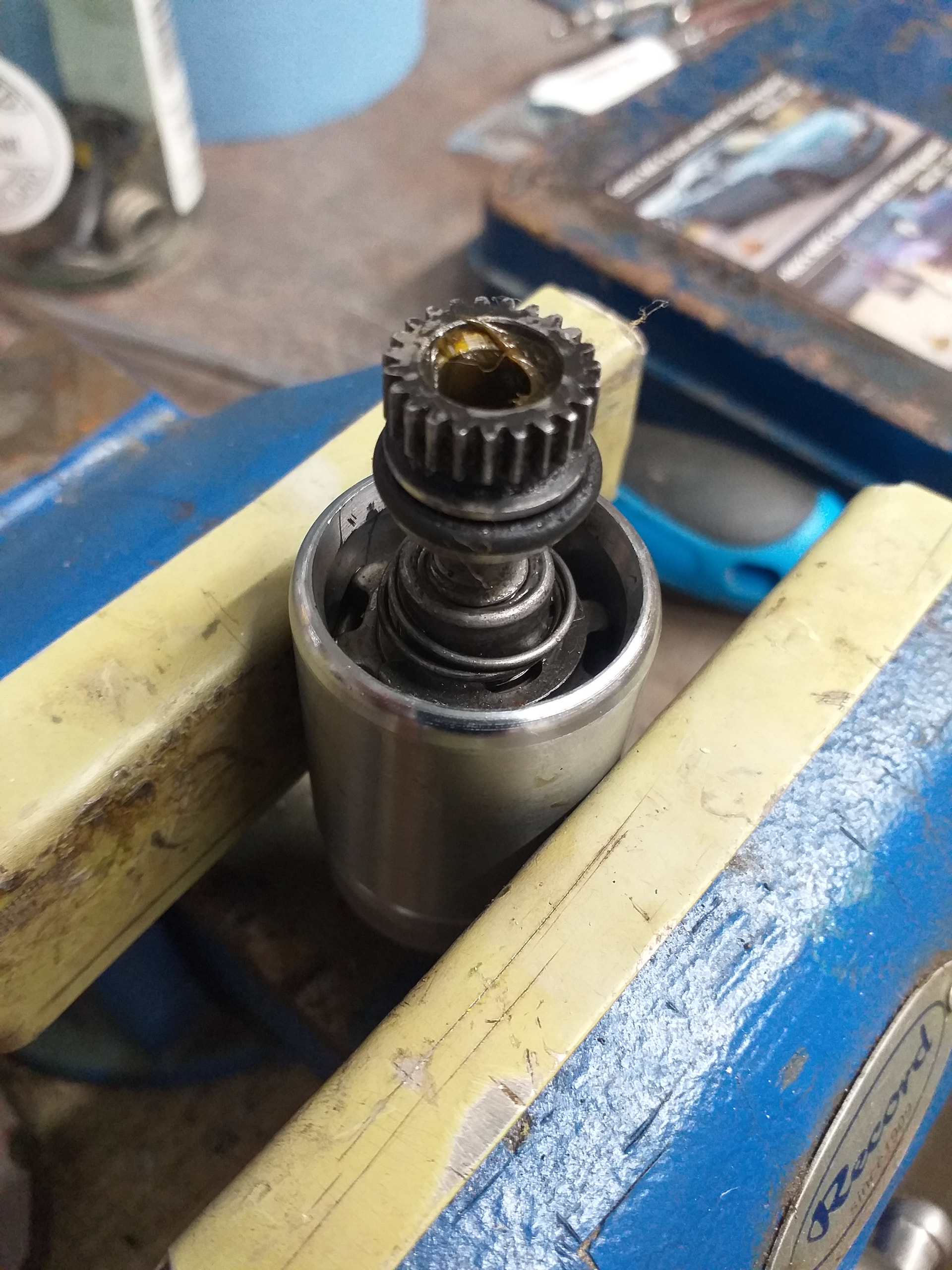

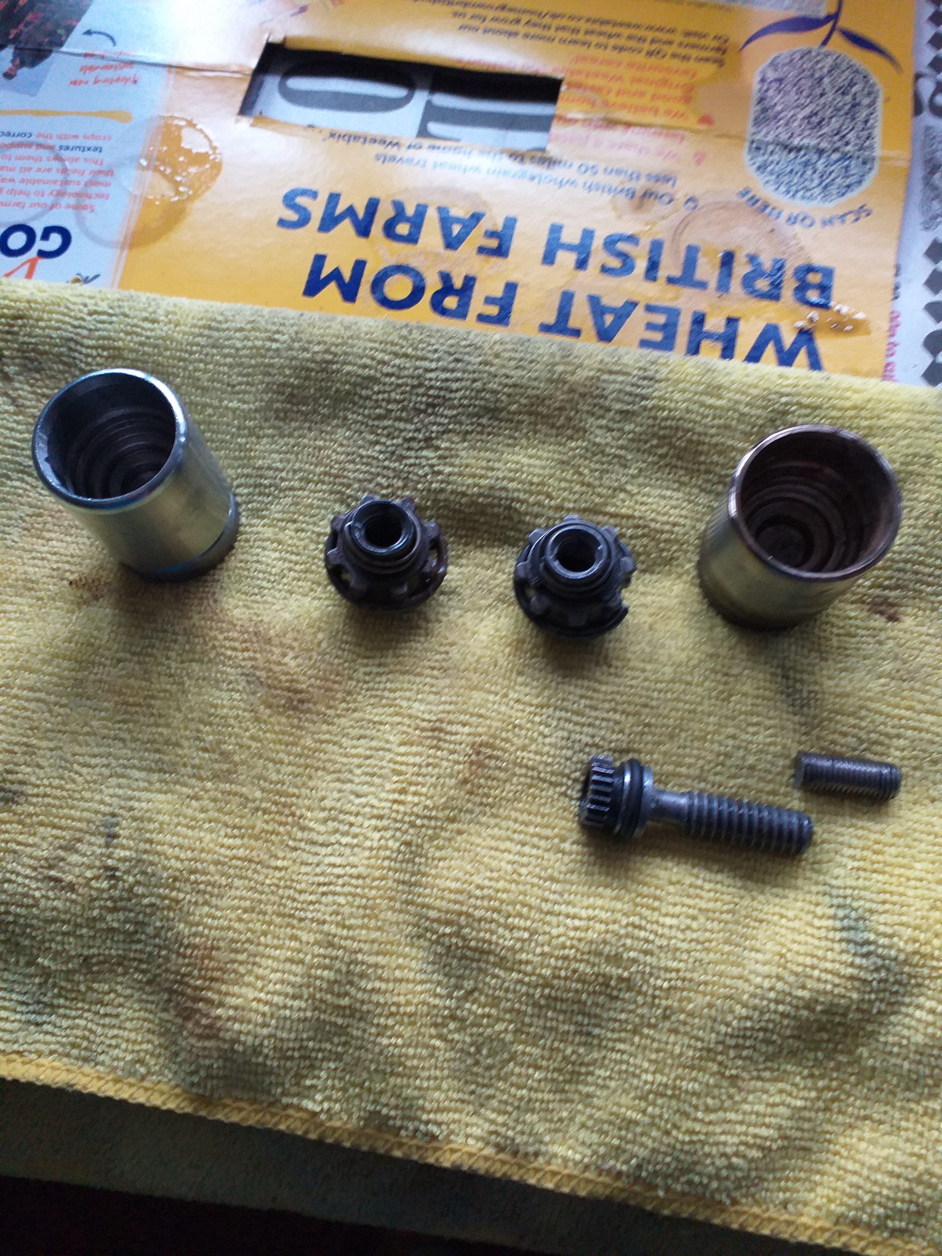

I’m rebuilding a pair of rear calipers, and have them fully stripped down.
My problem is with the replacement pistons which dont have the grenade insert that the adjuster shaft screws into.
I’m trying to remove the insert from the old pistons to fit to the new?
Thanks
Nic
Please see attached photo. Thanks.

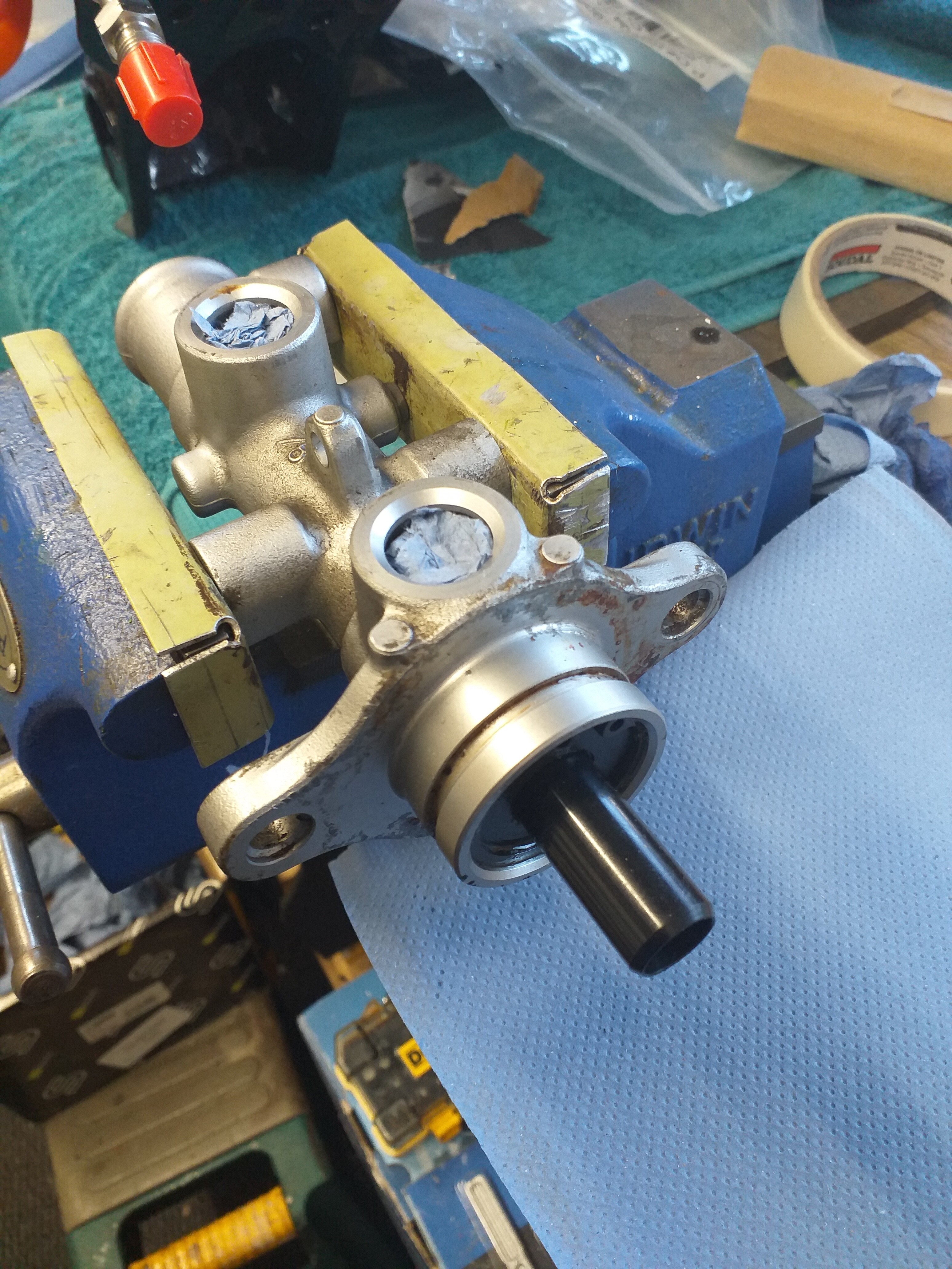

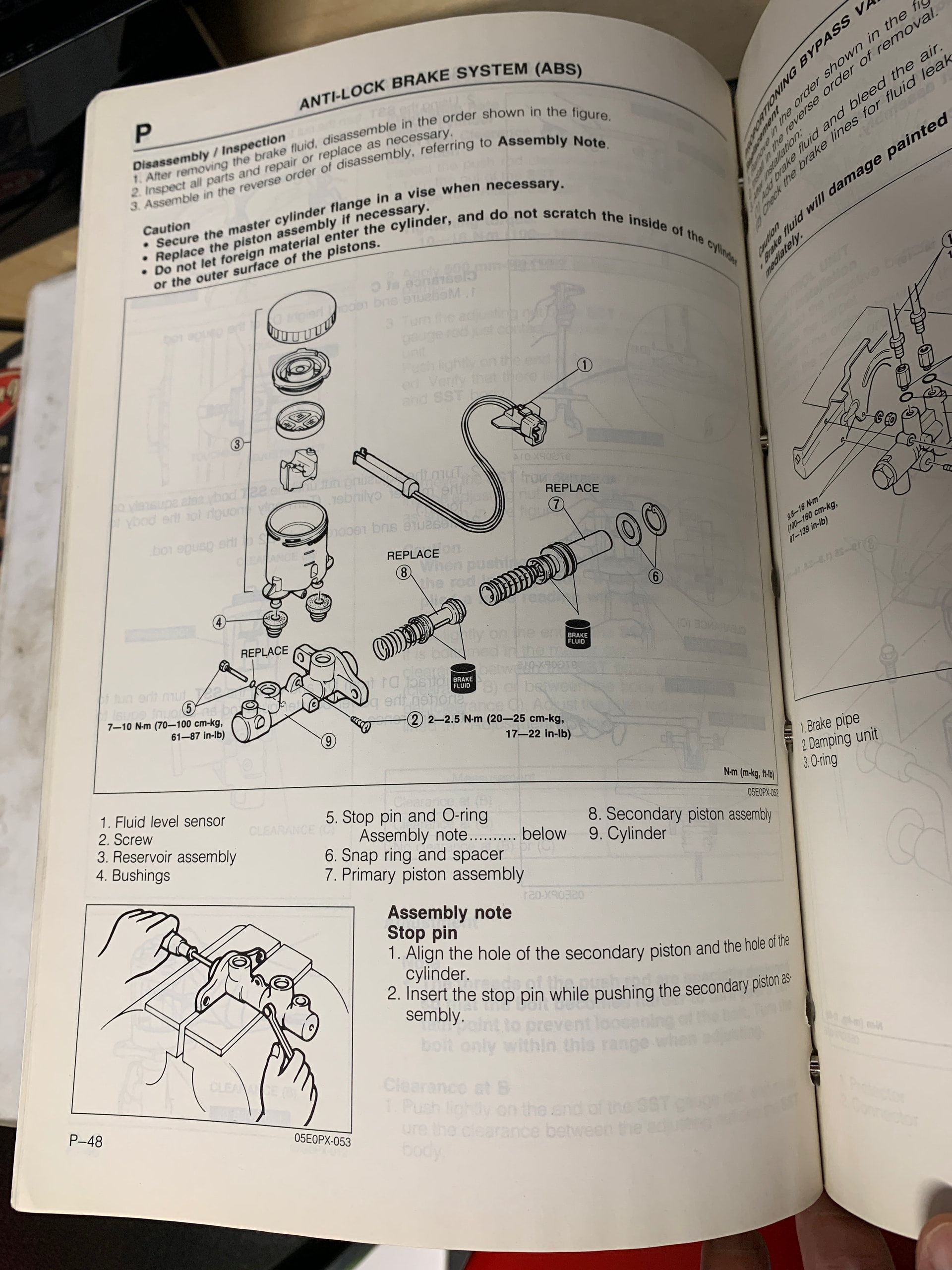

Does anyone have knowledge on the NB1 Brake Master Cylinder (with ABS) ?
Specifically an exploded view that shows the order of the Pistons/Seals/Springs Ect.for reassembly to the Master cylinder body?

Thanks Robbie,
Much Appreciated.

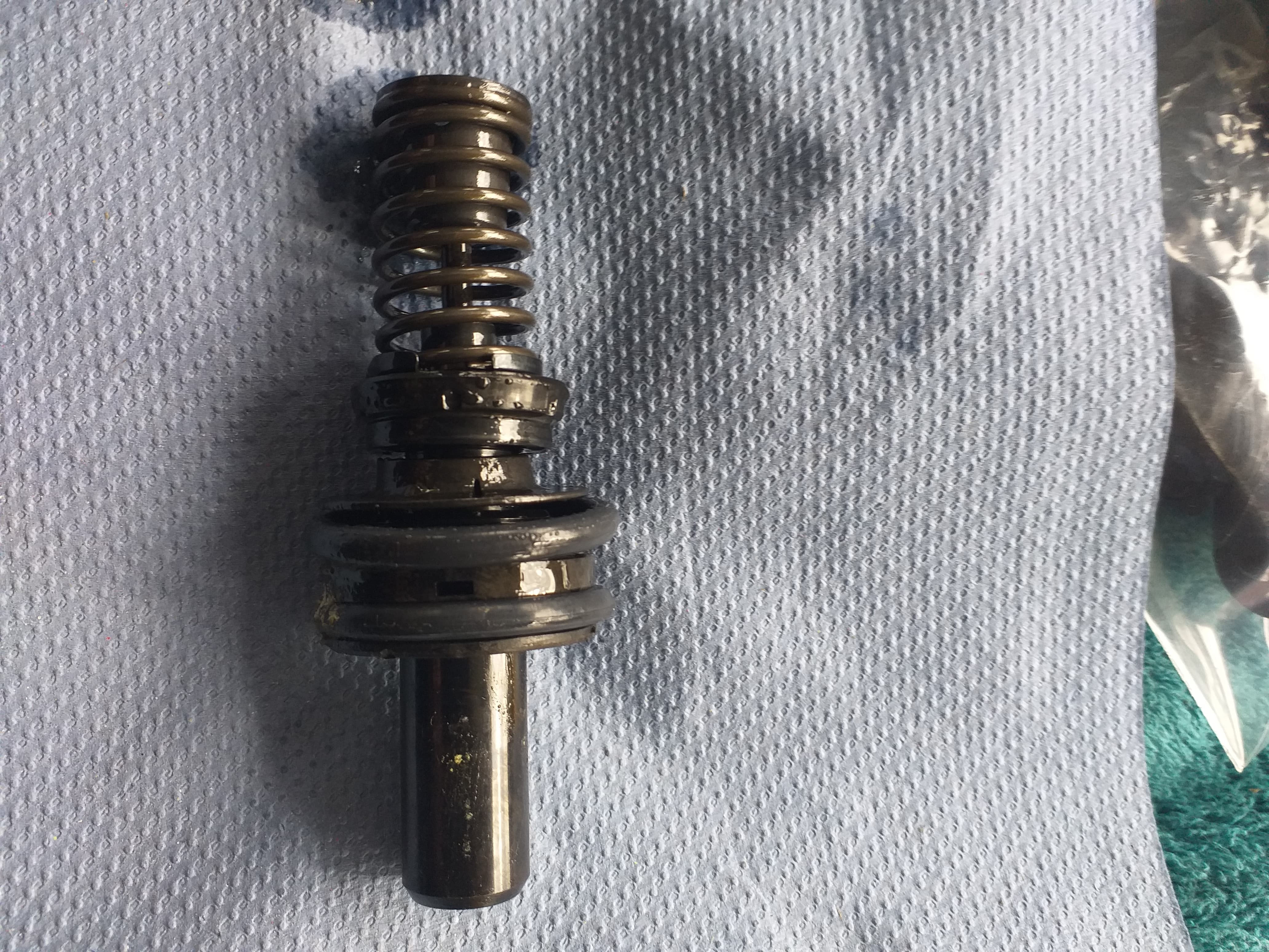

Hello All,

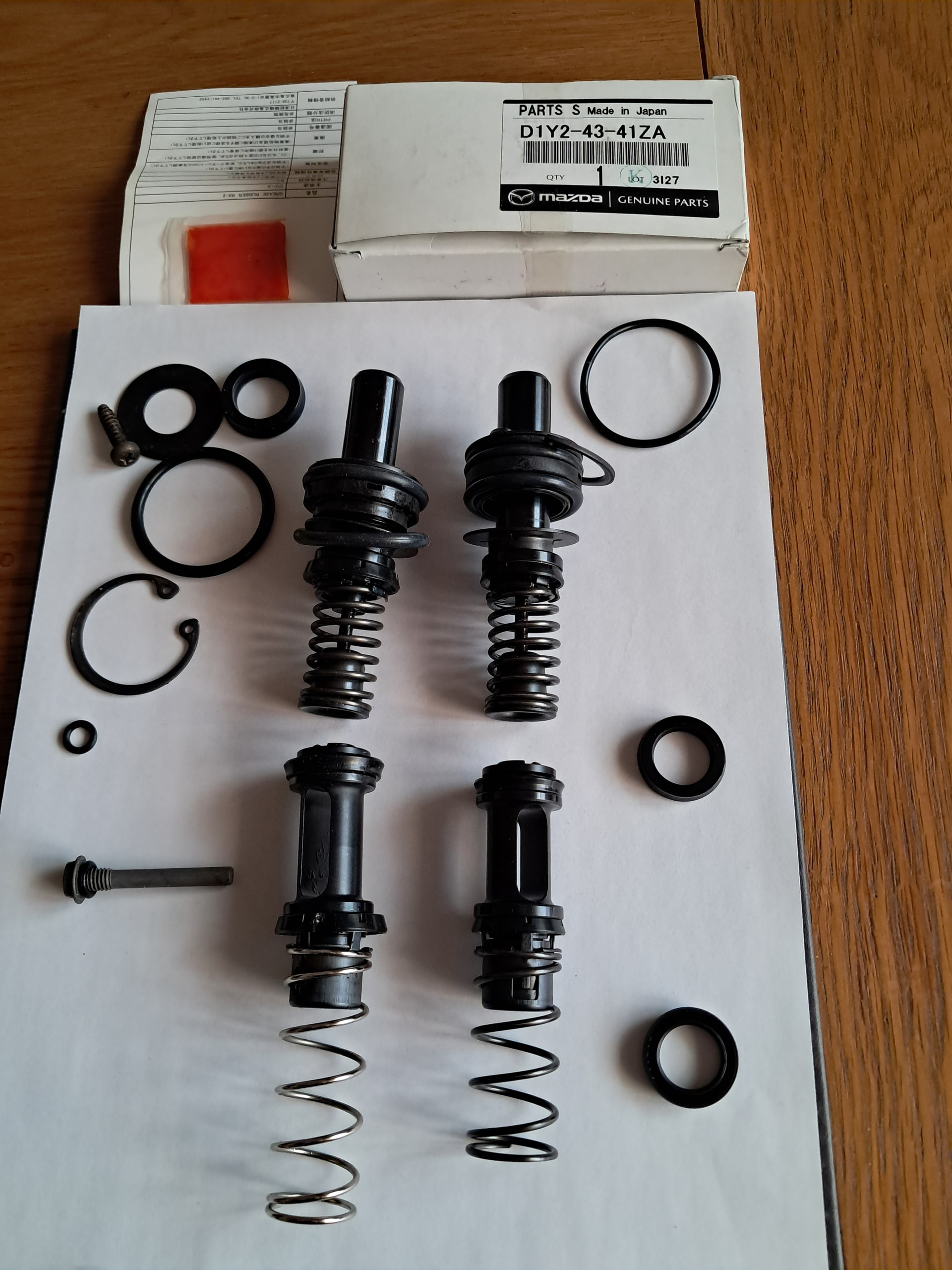

I’m currently rebuilding my original Brake Master Cylinder with a genuine Rebuild Kit supplied by Mazda as D1Y2- 43-41ZA (see photo).
Unfortunately the exploded view of the Master Cylinder ( Thanks Robbie) doesn’t show the position of the loose seals supplied in the kit (see photo).
Do they fit on the ends of the Primary & Secondary Piston springs? Can anyone confirm?
I also note the length of the secondary piston spring supplied is shorter than the original??
Many Thanks
Regards
Nic
Where did you get the seal kit from? I’d need a VIN number to confirm but from the part number, I think that might be the wrong kit for your car.
Thanks Robbie,
Kit came via BOFI Racing on long lead from Mazda Japan.
My vehicle is a 1999 NB 1.8iS
VIN is as follows : JMZNB18P200124795
