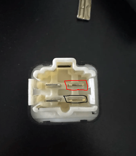

I get continuity on these 2 pins (I’m not sure if that means anything… i don’t have much experience with anything electrical )
If you look really closely at the relay, moulded into the plastic can you see the works “Coil”, “NO” and “COM”? What age & spec car is it?
I can see an “A” and “4”. It is a 1993 S-Special Import. Also the relay is a Denso B6S8
Do you have continuity across the other 2 pins? Is it a 1.6 or a 1.8?
I don’t. Just the two pictured
If you can get hold of a 9v battery and some wire, apply 9 volts across the pins with continuity observe if the relay clicks. If it does click, with the 9 volts still applied, check for continuity across the other 2 pins.

Don’t have a 9v battery, however I plugged in the relay while the car was cranking and the relay does click.
Is it a 1.6 or a 1.8? You can either try throwing a CAS at it at this point or I can walk you through some more tests.
it’s a 1.6. Any test would be helpful, just don’t wanna buy a CAS and find out it was just the relay

Okay so, I ran to the shop and got a 9v battery. with the relay powered I have continuity in the other 2 pins. I’m going to assume that means the relay is working fine?
I’d still check for battery voltage at the B+ terminal in the diagnostic box next. At least you’ve got a spare battery for your smoke alarm now.
