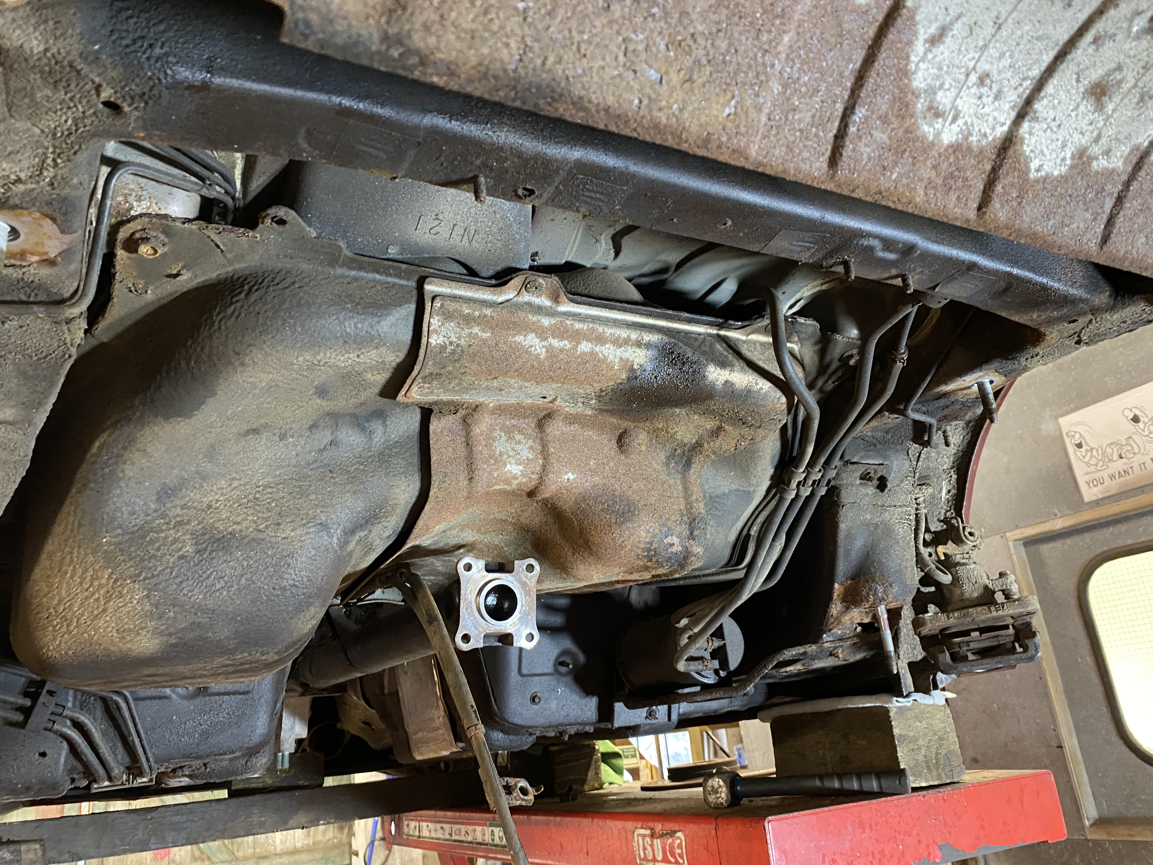

OK, so I’ve had my 2014 NC in to a specialist today as the handling has been off.
I’ve been advised:

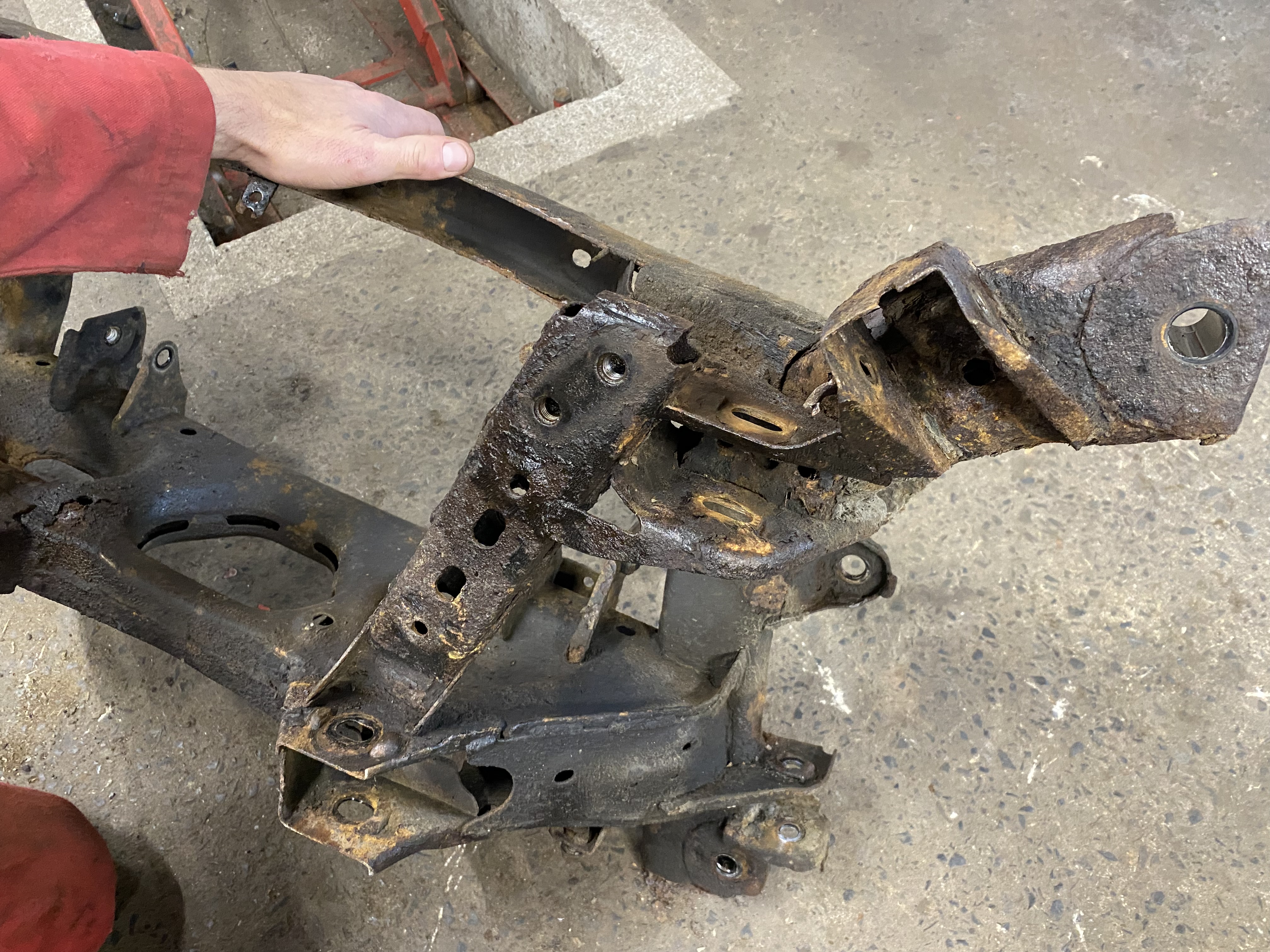

Rear subframe corrdoded, soft but not holed (he says this can wait a bit)
Lower front arms bushes split and perished (they’ve practically been pushed out of the arms)
Rear discs corroded and scored on inner face
Rear upper arm bushes cracked and perished (these have multiple splits all round)
The rear subframe brace bars are also completely rotten
Play in steering rack
I bought the car 3 months ago, now on 62800 so I’ve put 1800 miles on it. It was last MOT’d in September by the dealer with no advisories. The car has been wandering all over the place with the recent alignment all wonky again due to the issues.
I’m now looking at a 4 figure sum to sort this (and that’s without repairing the rack or swapping the subframe) which is 2x rear upper arms both sides, 2 new front lower arms, new subframe braces, new discs and all the assorted fixings to go with it. The front wheels have been leaking air since I got it but I was happy to get them refurbed at my cost.

Rear subframe… Get her up on axle stands and get stuck in with buffer or powered wire wheel and see exactly how bad it is.
If it’s not as bad as feared after attacking the tin worm , apply rust killer / encapsulator and a chassis protection of your choice.

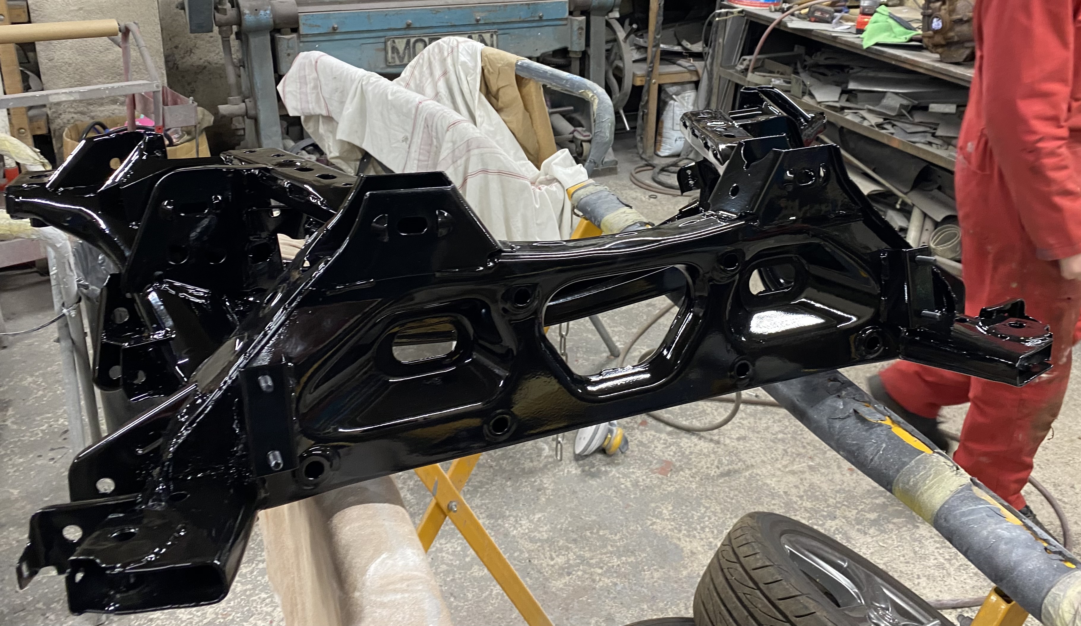

I’ve just had the rear subframe replaced on my NC1 as it was rusted and the suspension arms had to be done as well. The cost of a genuine Mazda subframe was horrific but my garage sourced a pattern part and used that it brought the cost down significantly but the end result with new suspension arms was still £2400.
Thanks for the info. I see refurbished subframes for £500 and that’ll be a plan for later in the year.
As it stands just now to get it to a suitable state where the coilovers can be fitted the cost of parts is around £1100 (on top of the £350 worth already ordered), then the £500 for subframe and nearly £500 (-£180 deposit) for the steering rack on top. It’s going in for an inspection at the dealers trusted garage next week but I’ve started ordering bits already.
I think I’ll be attempting most of the jobs on the driveway as I imagine a garage battling with bushes or bolts instead will fair rack up the costs. A few new tools, some swear words and many cups of tea should bring the overall cost down. Once the new fixings, bushes and arms are in then my local specialist will tackle the subframe later in the year - it’s “soft but not holed yet”. That’s the current plan anyway.
