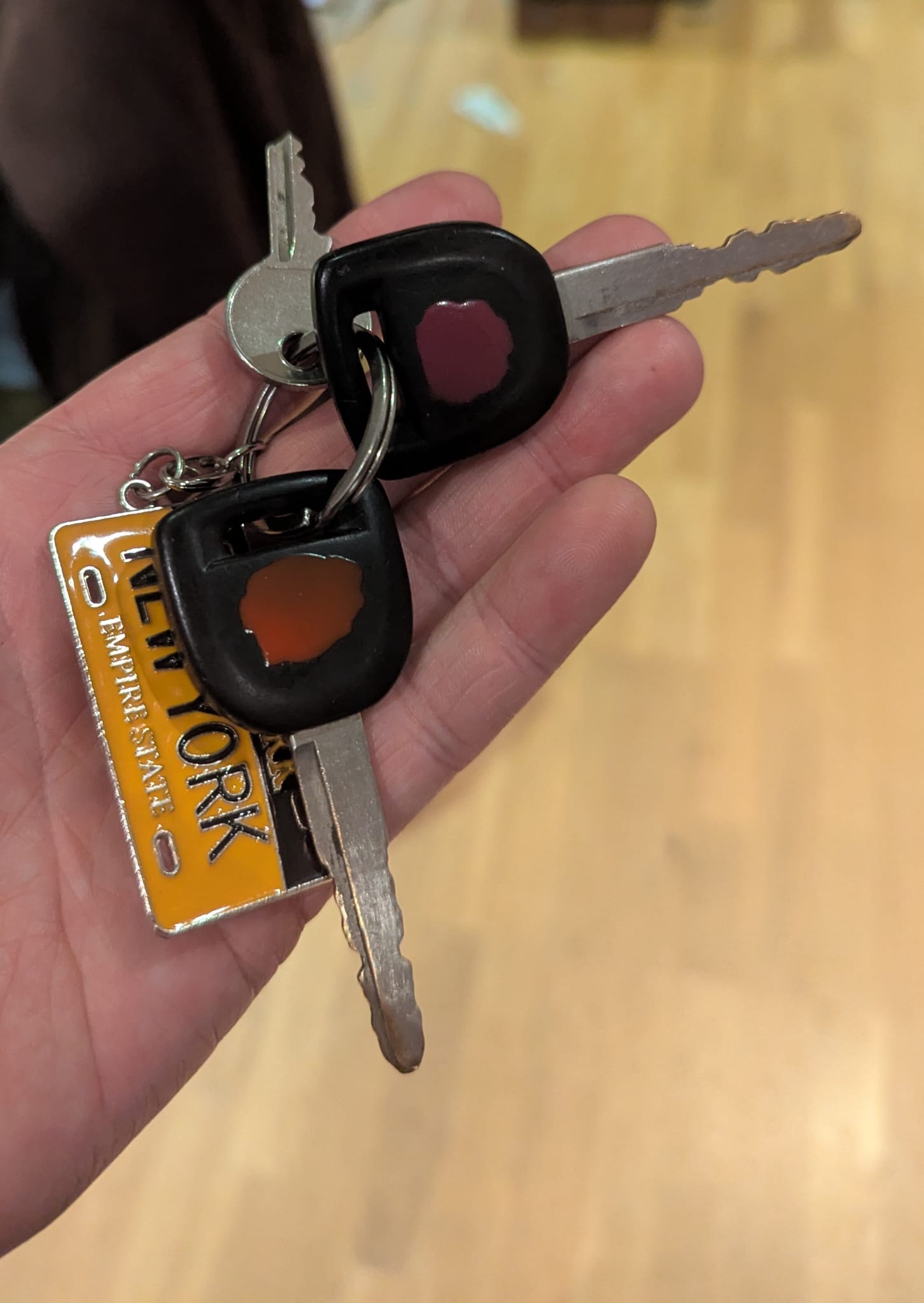

I bought my car a few weeks ago and the seller gave me three keys (no remote)
One ignition key
Two keys which will unlock the car
He explained to me that the car recently had a new sensor fitted and he was given a separate key for the ignition. I have colour coded them with some of my daughters nail varnish as it was driving me mad (see photo). I have no remote for anything.

It’s likely that the car has had an immobiliser fault in the past, that has resulted in the ECU, immobiliser module and ignition barrel being replaced as a set.
The ignition key contains a transponder chip (matched to the immobiliser, which is in turn matched to the ECU, or ‘PCM’ in Mazda-speak) that needs to be cloned for any replacement key. (I believe that this is run-of-the-mill stuff for an auto locksmith.) Very wise to have a spare!

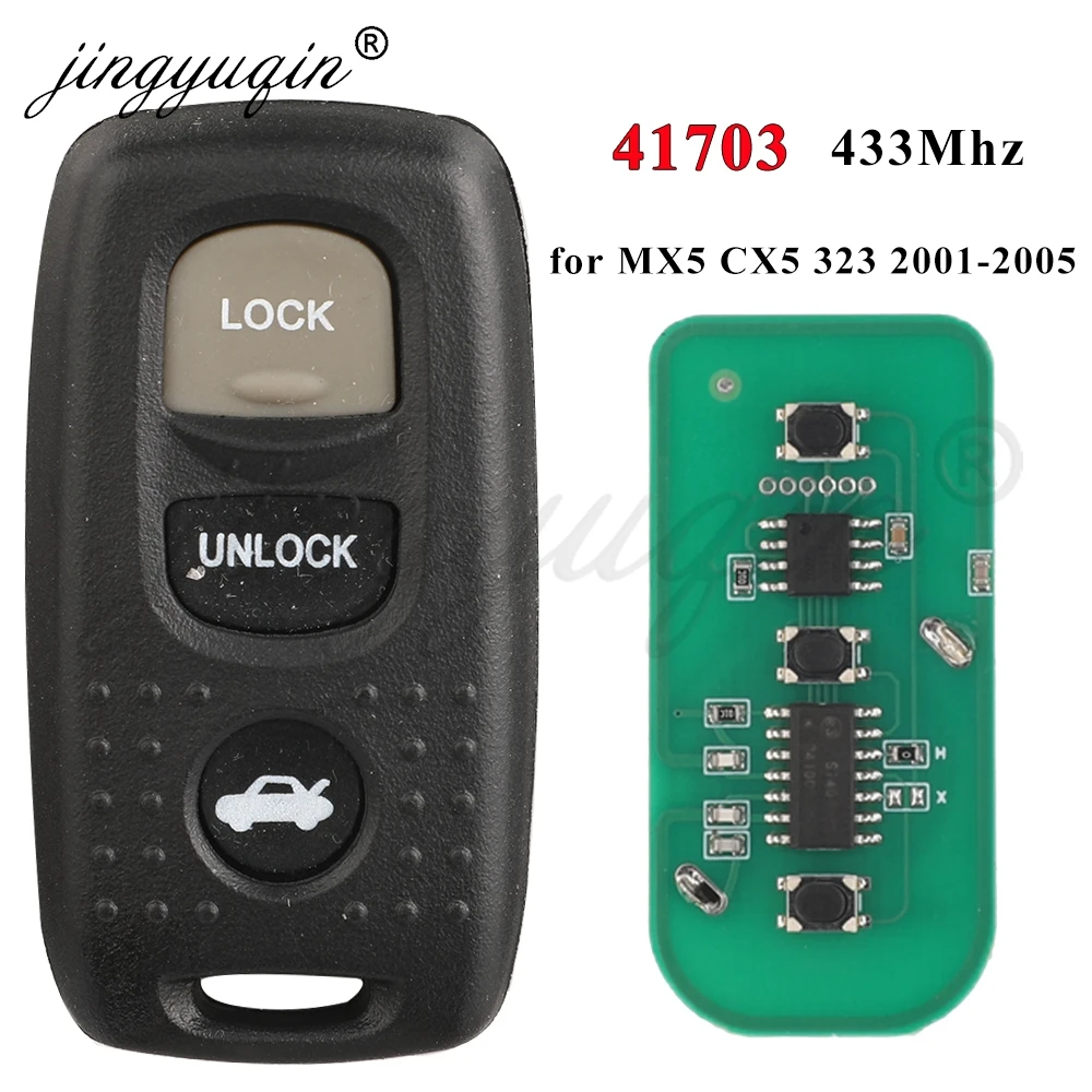

UPDATE : I do think my car has remote locking as standard (Arctic edition), I haven’t yet checked that the receiver is behind the glovebox. I believe the correct remote would be three button Visteon 41703, people selling them second hand for £50 on ebay. Seems straight-forward to programme.
I think I’ll just manage for the time being, I don’t want to spend £50 and find it doesn’t work (I know I’m a cheapskate)

How about £3.48?
(plus shipping, or buy 3 for a tenner!)
Dunno if it helps but Bullit 2005 2.5 Remote sez ditto ‘Visteon 41703’
THEN there is another set of letters/numbers beneath (which I suspect maybe different to the one you require ?]
Again dunno …….maybe this second set of letters/numbers is what is requried in order to recode?
You are not a cheapskate….just being sensible !
:open_mouth: , ordered! For this price if it doesn’t work then never mind!

Not clicked on the link but the pic looks like Bullit remote

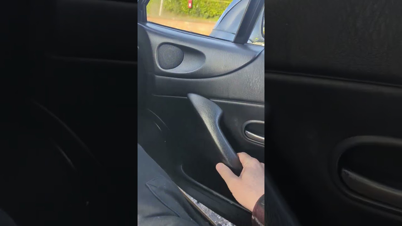

As I am sure everyone loves a happy ending :wink:, I got the keyfob from China and followed the procedure shared on this forum to pair it with my car. Happily it works and it turns out my car does have remote locking and the boot opener works as well!
Am really chuffed and would like to thank you guys for the help, 3.74 inc P&P !!!
I made a little video to show it being programmed in case it helped anyone, but it turns out the forums won’t allow them to be shared so nm. If anyone is interested I could put it up on FB group I suppose.
Happy days!
