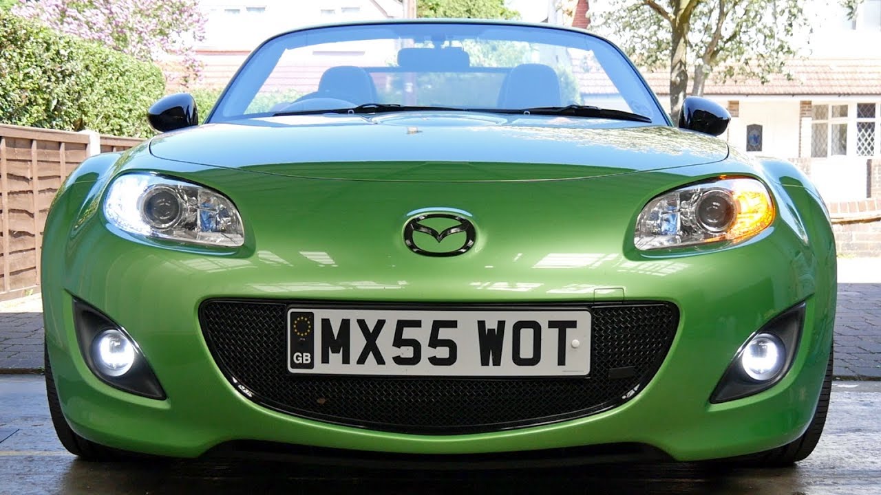

A simple solution is to install LED bulbs in the foglight housings, if you have foglights fitted.
They need to lbe switched on and off manually but thats no big deal.
You can also put led bulbs in for the sidelights.
This will give even better road presence
