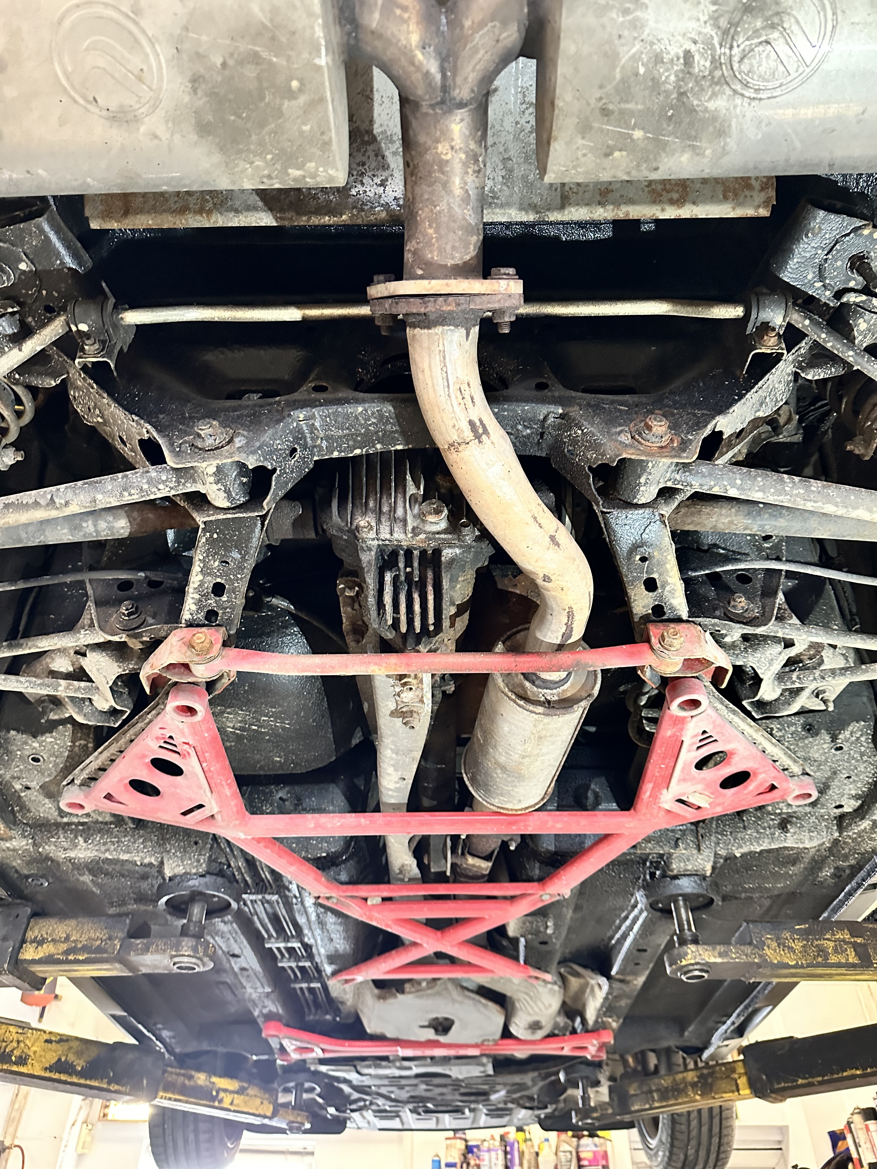

Some people swear by chassis braces. My current NC is supercharged, running Ohlins and has the 3 IL under car chassis braces. TBH it’s probably too stiff for a lot of UK B road usage, though great for track.
If you improve the chassis, brakes and tyres then you’ll be able to drive the car quicker with your current power.

Chassis already fitted out with the full IL Motorsport kit and I’m lucky enough to have Ohlins too.

How long have your chassis braces been in place there ?
3 years.
