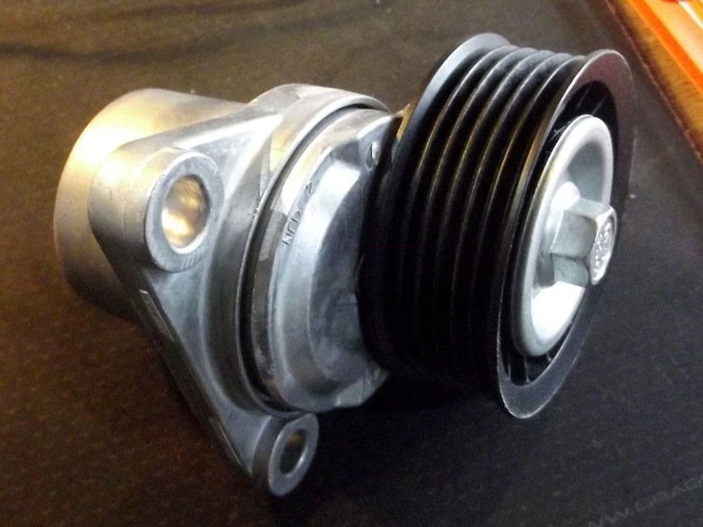

Try taking the serpentine belt off. I had a similar noise on my 07NC.
The idler on these are prone to failure and it does sound like an engine knock when they go.

I think it’s still the same pulley set up on the NC2 as the NC, I’m sure I’ll be corrected by someone if I’m wrong.
Try removing the belt and fire it up for a short bit. If the noise has gone then replace the idler and tensioner pulleys. It’s quite a simple task. I bought mine from Autolink
i’ll give that a go, it’s a bit problematic because it rattles so intermittently, it does it a lot when i don’t want it to but whenever i try to show it to someone it stops doing, but it might be good just to check all the pulleys and to refresh them anyway.
That sounds just like mine was, it rattled on start up, sometimes on idle but disappeared when going fast.
This was the tensioner I replaced on my NC, it solved the problem.
