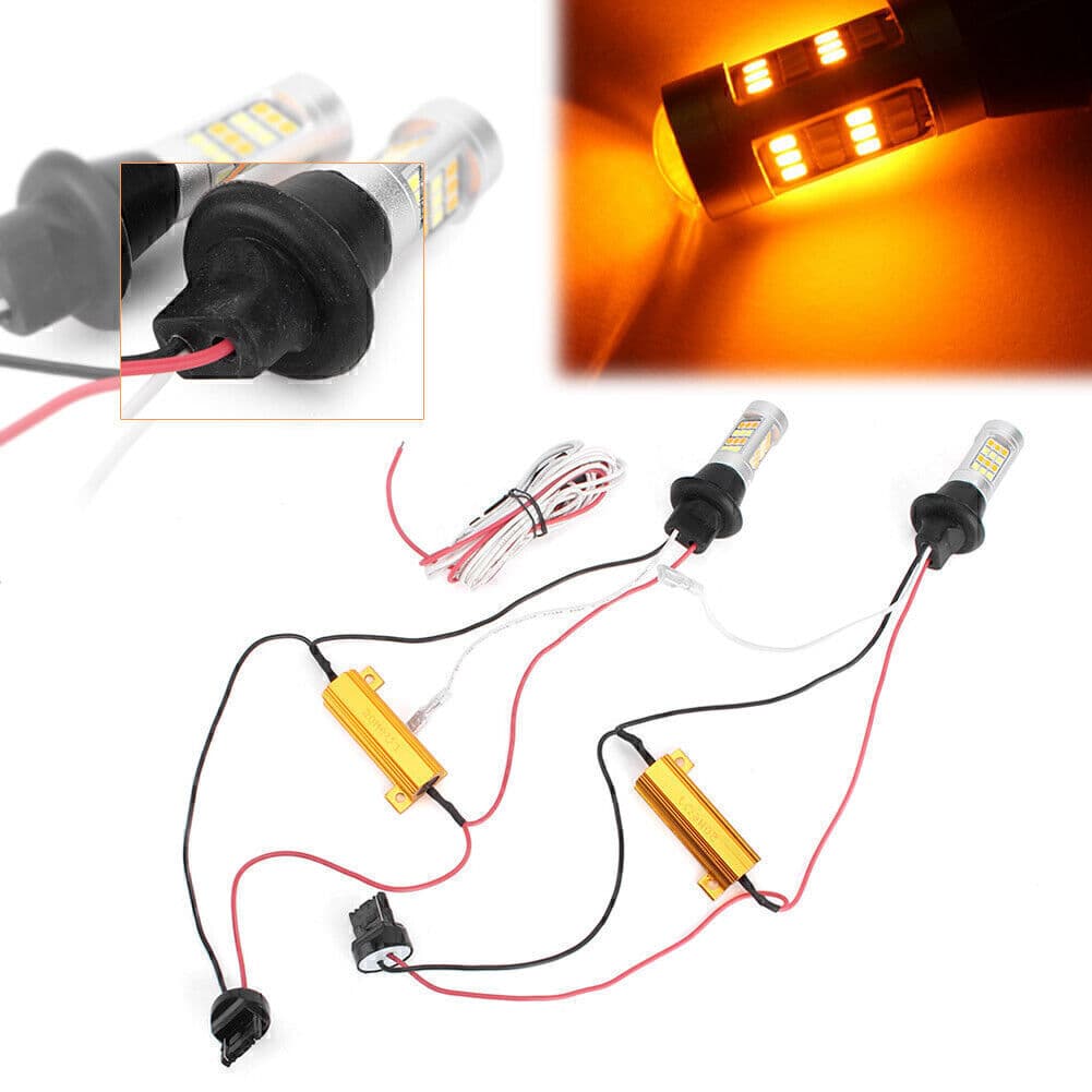

Hi, you can get a similar kit for pennies (£15 or less) that replaces our indicator bulbs with Switchback LEDs that can be both white and orange, and the white automatically turns off when orange is on, then back on after a sec.
I have these in my car front and rear (for extra reverse lights) and they’re great. Minimal crimp wiring required with a cheap relay (literally a few minutes and £20 in parts + tools or less) and look at the result:
This is what the kit looks like, any W21W or T20 kit should fit:
There are much brighter options too, which I’m currently comparing and testing.

Any T20 switchback kit with resistor should work without any other modification (except for wiring in the DRL function).
I just did a quick eBay search and found this: 2 X T20 7440 42-LED 2835 50W Dual-Color Switchback LED DRL Turn Signal Light Kit | eBay UK
Looks the same as my front ones.
