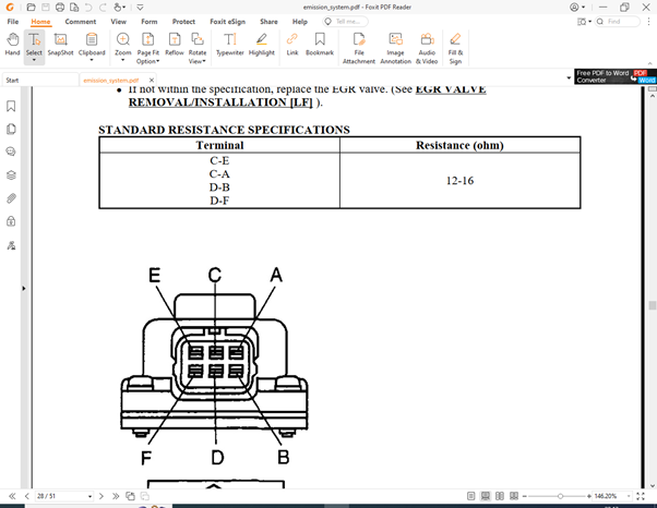

Here are the Diagnostics for the EGR Valve courtesy of Mellens. In the majority of cases it is the motor that is the problem but you may be one of the exceptions. However I think by the time you have managed to access the connections it may be quicker to remove the stepper motor and test it off the vehicle, best of luck.
I believe if you change the whole valve, it requires a coolant drain, so going for the stepper change first, was my preferred route.
