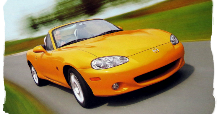

MX5 Arizonas had Recaro seats? I thought they just had the same seats as all the rest/ Just normal high back black leather seats
13652-10-small
They are different. If they were the same they would have a 3 wire air bag system. The seats are also colour coded. Only 1000 sets of seats were made.
