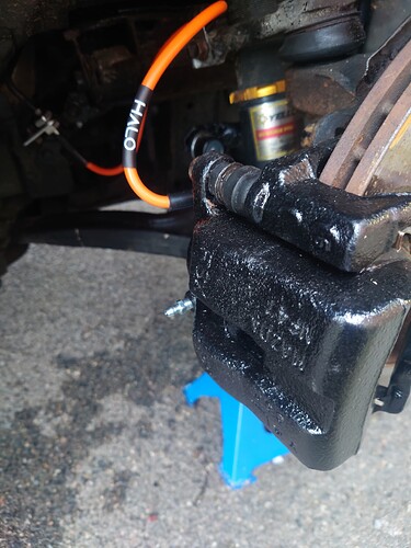

I’m not sure if this is even possible or not, but looking at your photo, have you put the calipers back on the correct side? From memory, the brake hose should be at the bottom and the bleed nipple at the top.
Edit… And the Mazda text is upside down and is that an “L” I can see cast into the caliper on the right hand side? In all my years, I’ve never struggled to bleed brakes on an MX-5 using the traditional tube in a jar method.
I was surprised to need plumbers tape but it worked. I recall bleeding the brake line and just getting bubbles despite having obviously replaced what was the whole lines worth of fluid. It freaked me out at the time but having plumbed a couple houses I had a fair bit of tape and memories of when a few wraps was the difference between a leak and not.
I always use ptfe tape because I use a vacuum bleeder - no tape = air pulled passed the threads rather than fluid pulled from the system.
Excellent spot.
Bleed nipple should deffo be above the piston housing.
I learned this mistake on an Austin Maestro as an apprentice…

I made the mistake of taking both calipers off and replaced the seals and pistons at the same time. I should have done it one at a time. Live and learn.
