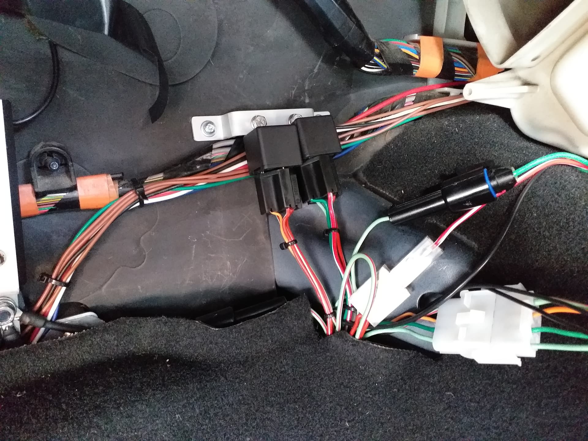

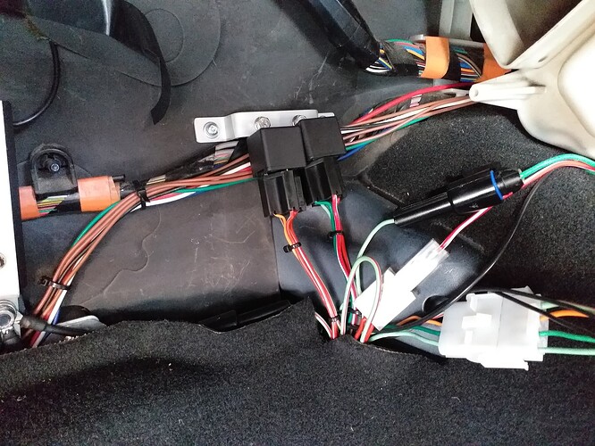

Hi Robbie,
Just a quick update re the above thread.
Ive sucessfully moved the NB Rear Fog Lamp switch to the NBFL position and switch to the right of the stearing wheel.
Ive also successfully installed heated seats using the NBFL switch in the NB Rear Fog switch position together with a bespoke wiring loom and relays.
Thanks for all your technical assistance, if anyone wants to do same just give me a shout .
