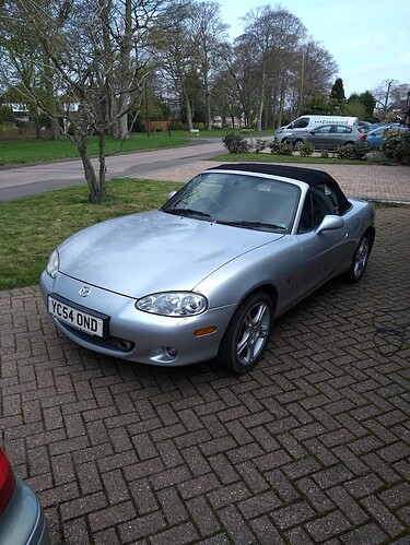

Welcome, Drewski! From this angle your new car looks terrific. :slight_smile:
David

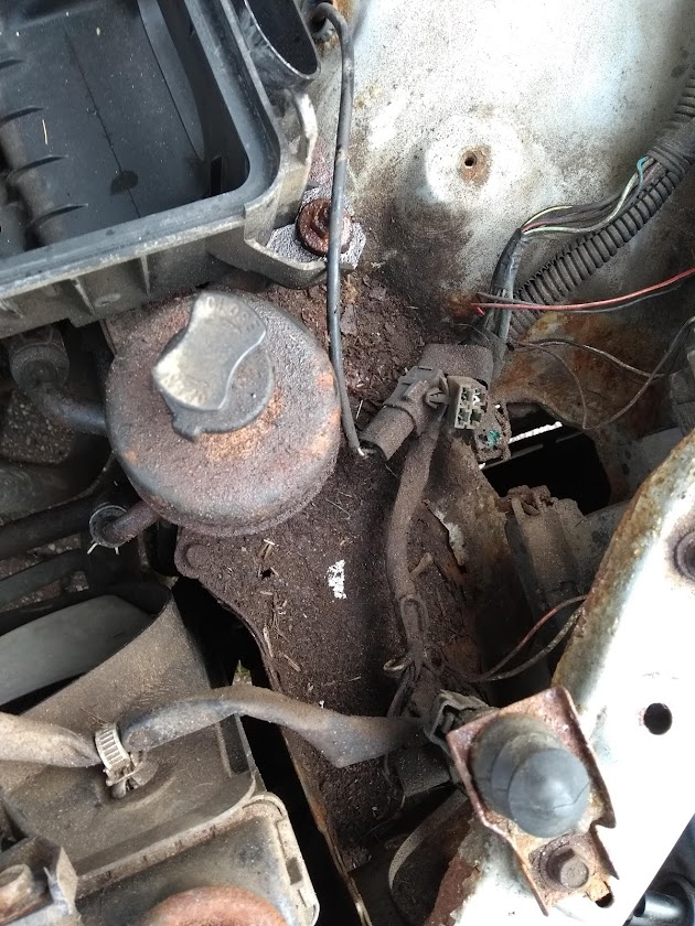

Agreed, definitely the best angle looks wise. The underneath angle is not so good.
First job will be the brakes, looks like, as the car was standing for some time, the discs have rotted. I discovered what a “flitch” is this week and that will be the next job, if I can find somewhere to do the welding that is.

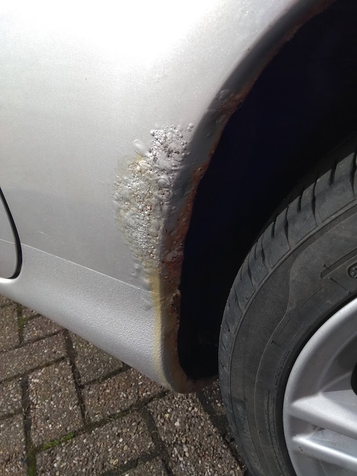

If you are planning to take your car in for repair, suggest you have a good look round for other areas of rust besides what look to be areas behind the left and right headlamps: That “flitch plate” area adjoins the front chassis longitudinals which are a known area for corrosion leading to MoT failure, the sills at the rear rust because the drain holes just inboard of the seat belt upper anchorage towers get blocked with dirt and water collects in the sill. You can can check with a trombone cleaning brush, about £5 on e-Bay, push it gently down the hole and it should come out of the floor inboard of the sill. If it does not, pour some water in with a funnel and gently agitate with the brush until the gunge drips out. You can check for general corrosion in the sill area by trying to flex the rear wheel arch flanges, particularly down where they curve into the sill. If the flange flexes a lot it is probably badly corroded. The battery compartment under the rear floor is another area to check as sometimes battery acid vapour collects there.

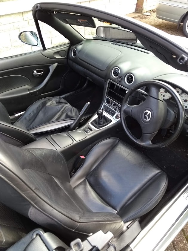

Incidentally, the wheels on your car indicate that it should be a 2004 1.8i Sport - it will have a six speed gearbox and semi-LSD differential which are nice bits to have. If you are buying chassis or engine spares, make certain you buy the correct parts as brakes etc are different.

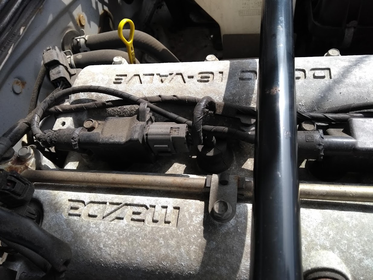

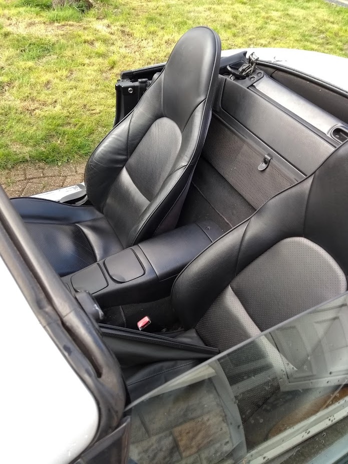

Definitely a 1.8 Sport - camshaft front-to rear pipe for the VVT and also the suspension tower cross-brace, plus leather seats and the three-spoke leather covered steering wheel. Sadly also has suspect rear wheel arches but not surprising given the level of rot under (and in!) the bonnet. Did the previous MoT (you can find it on the UK gov website) show any rust advisories?
Yes, lots, the sills had been done at some time and the car appears to have been looked after but it ended up on a farm and I suspect it made a few laps of a field nearby. Mud had been sprayed up at the front, into the engine bay, then it looks like it had been left for some time with the bonnet open. I’m sure a lot of people would have walked as soon as looking underneath, (although the underneath has turned out to be not quite as bad as my first impressions). I saw potential, the price was quite good so I took the jump. Quite often I don’t pick cars and bikes, they seem to pick me! Have a look on the MOT site, reg is YC54OND
Thanks, 'keen to learn as much as poss about the car and marque. The log book has it as a S-VT Sport. Is it a 15th anniversary do you know?
