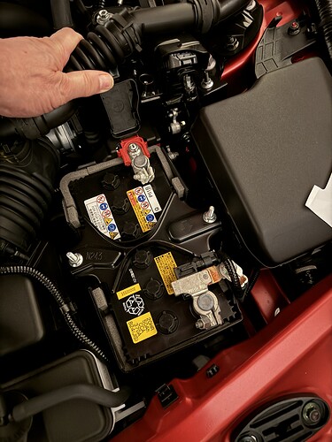

So here are two images of the engine. One a close up of the battery.
I assume I would connect the positive red connection directly to the positive terminal on the battery but where would I connect the return, negative, black cable to if not directly to the battery negative terminal?
Would one of the battery strap threaded rods work?
Forgot to mention that the battery on my car is at the very front of the engine compartment.
I put the negative clip on the hoist bracket/loop on my daily driver and NC.
Has the ND got one? Any metal part connected to the engine/chassis will do if it takes a clip.
I have mine rigged like this, but I split some rubber hose and slid it on to any sharp edges on the retainer to prevent a short if the wires rubbed through.
Hi C,
The negative will go under the silver nut on the black thread. If you follow the line of your thumb to the right and then look just before the red bit of your car you can see it sticking up. Just undo it and pop the ring over and re tighten, as you can see it has a washer combined with the nut.
You can see the threaded bit of the clamp on the positive post to attach the positive wire. With a little careful bending/positioning of the red wire you can get the cover to click back down.
