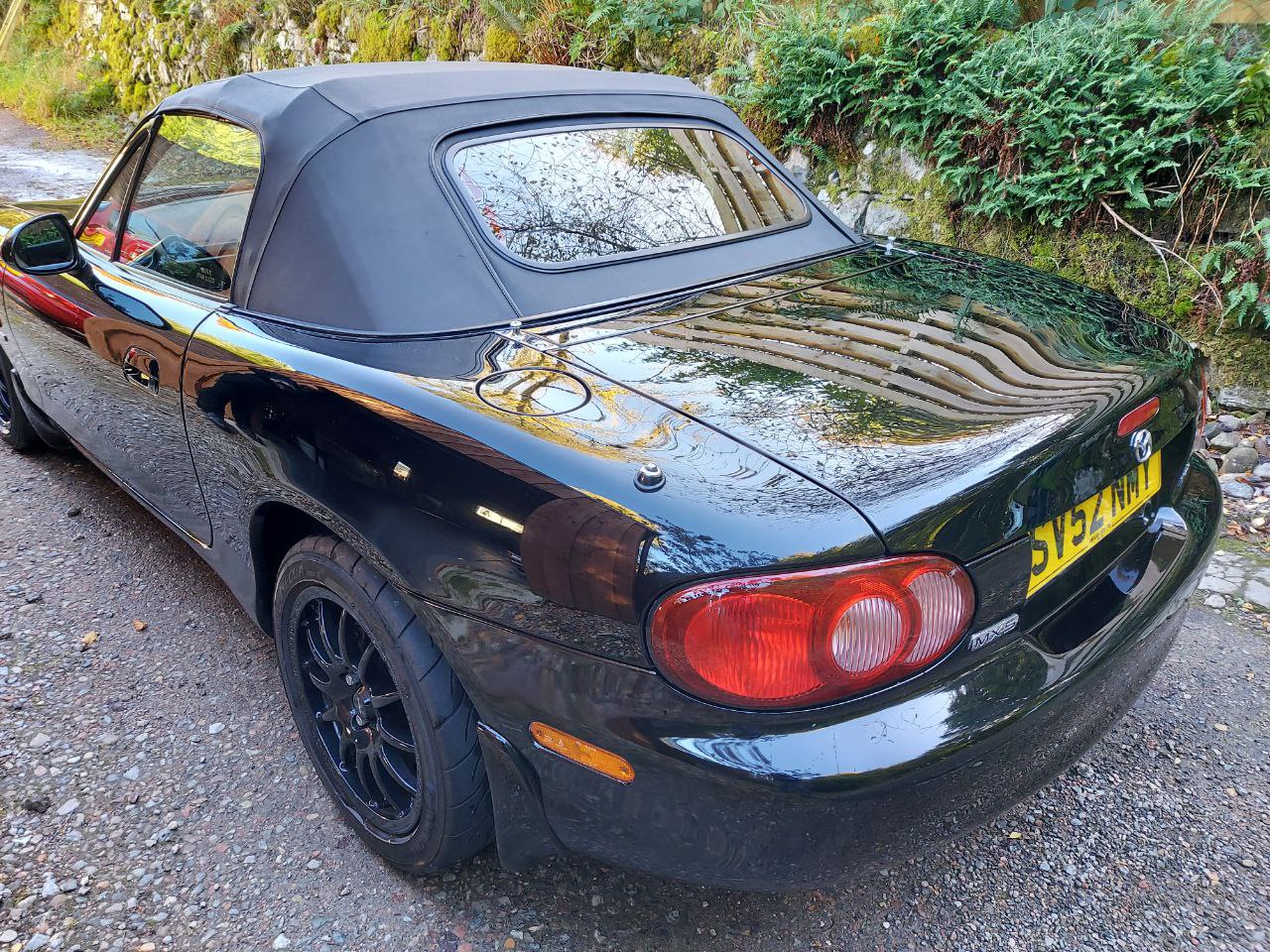

I have largely followed the same process as @Dipstick - soak the hood down, fill a bucket about quarter full, add soap/shampoo and a good squirt of Milton fluid, then massage it into the hood with a soft-bristled nail brush in an area of about a foot square at a time. Rinse it down, then move on. Once you’ve done the whole hood, go back over it until the gunge stops coming out. Holy cow, did that get a lot of muck out of the hood! I part-opened the hood to let me get all the way down around the bottom where it meets the car - an old toothbrush helps - and, judging by the amount of muck in there, it was well overdue for a clean. You do have to be a bit careful with the hose, but it will drain fairly normally without soaking the inside.
After drying in the sun, I use the Autoglym sealer shown above. I did try the cleaner part of that kit, but the above method seems to work much better.
Best done on a warm summer day when you don’t mind getting wet!
Final step is to pull through the drains if you haven’t already, and I also get down and make sure the little drains in the bottoms of the sills and doors are clear with the end of a small cable tie.

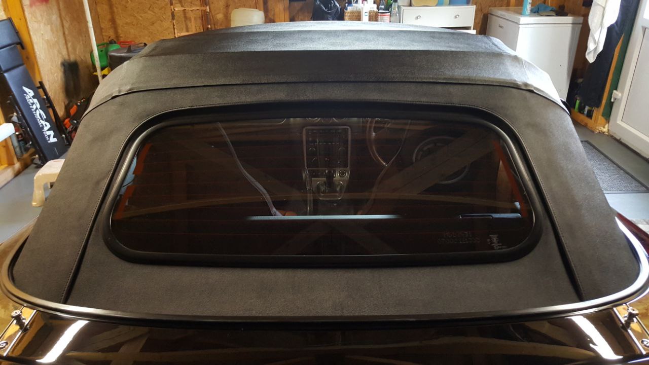

I use Poorboys Natural Look on my Mk2.5 vinyl roof…also on the tyres, door panels and dash.
It is easy to put on, totally waterproof and does not clog the fabric. On the interior it can stay matt or gloss depending how you buff it.
I’ve been using it on the soft top for 5 years and I love it.
