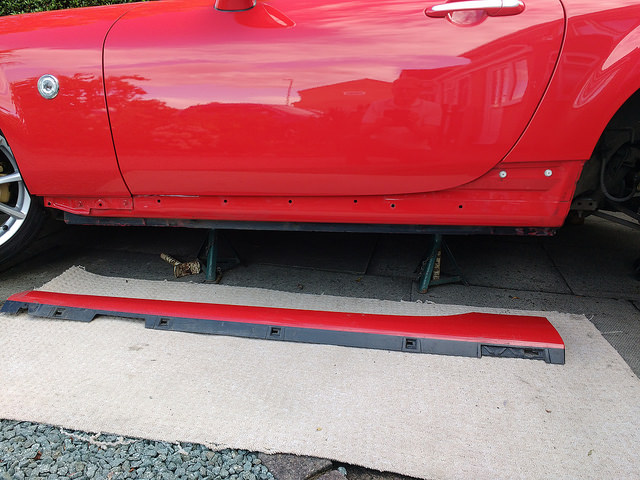

I responded to a thread here below. Sadly some links/photos do not work anymore but it gives you an idea.
43918117462_1694ec6e34_z
Thanks for the reply, I managed to remove by undoing one clip at either end of the sill, and gently persuading with a few taps from front towards the rear of the car on the bottom corner of the sill with a mallet protecting the sill with a towel. surprisingly easy to be honest, did break a few of the clips but I hope to plastic weld them back on. All good fun !
