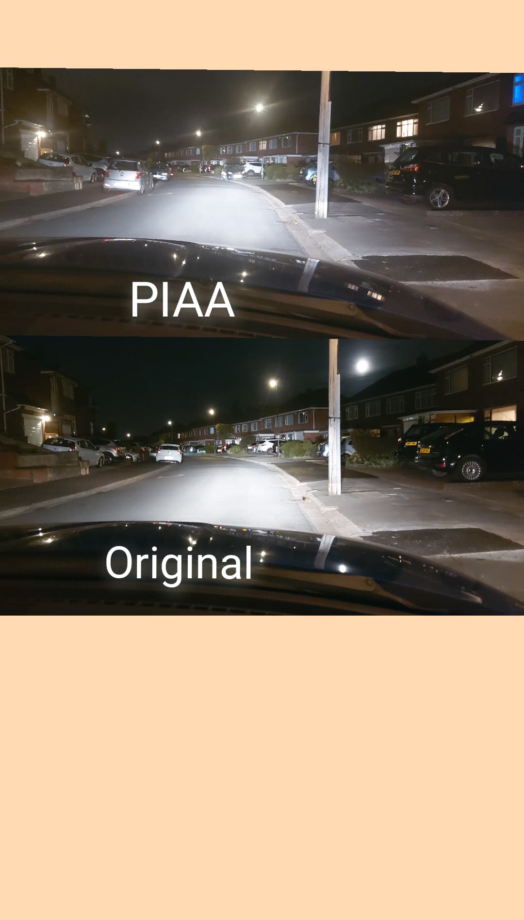

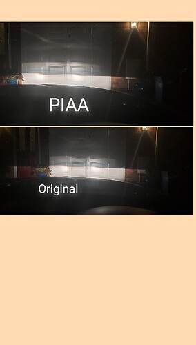

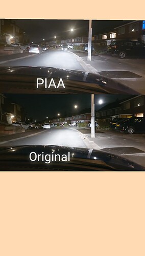

Last year I swopped the original (?) 15 year old bulbs in both dip and main beam for a set of H7 + H9 PIAA Hyper Arros bulbs. Whilst not offering the ultimate brightness compared with others they do claim better durability and knowing how much of a pain changing these on the NC is I went for longevity. Also swopped the sidelight lamps for some “whiter” ones to try to match the headlamps. I decided to remove the front bumper rather than go in through the top or remove the wheelarch flaps.This made the job much easier and enabled a clean up of the front reinforcement at the same time.
Results can be seen below
Dipped Beam:
Main Beam
