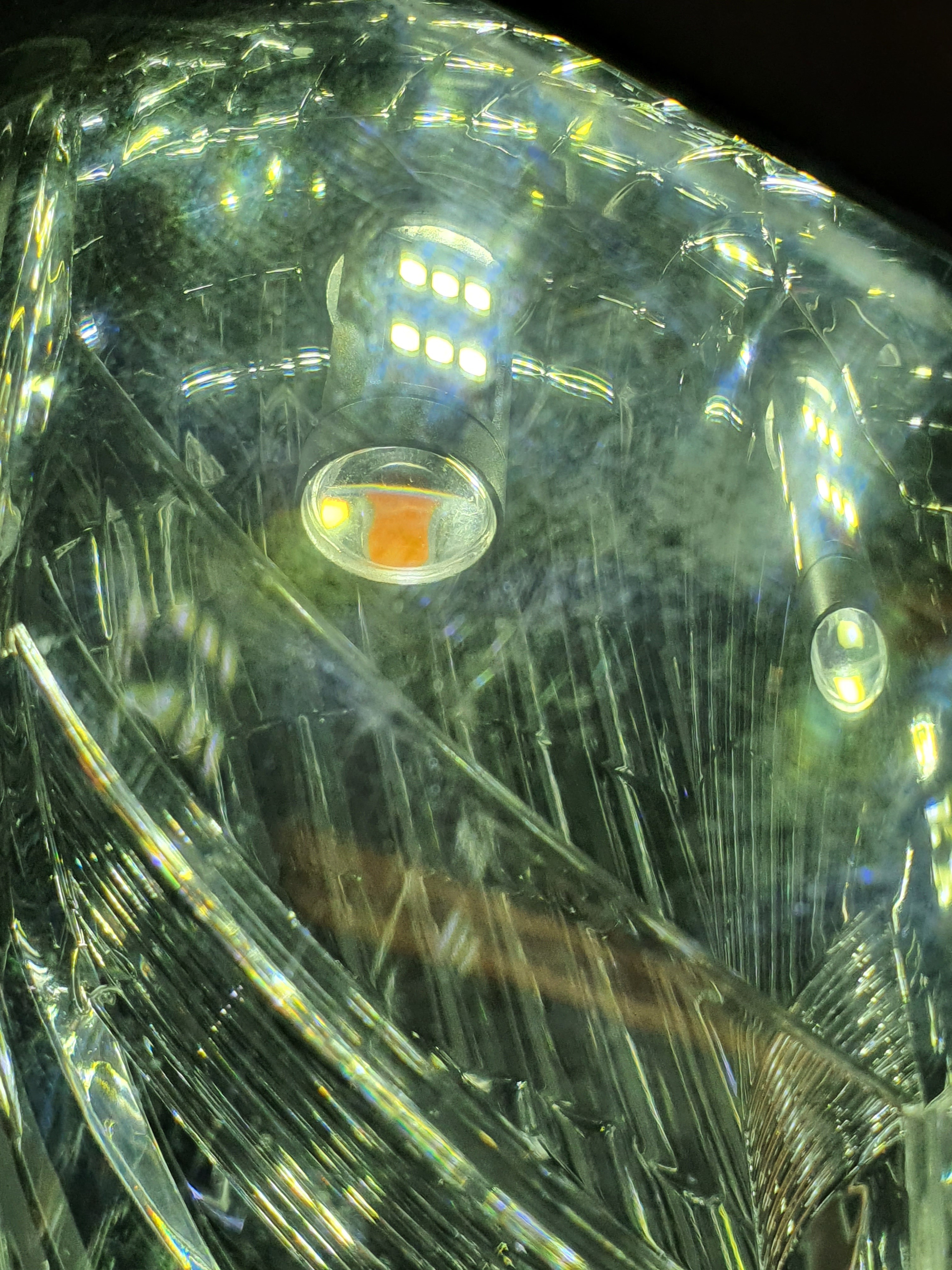

I’m trying to visualise what this looks like🤔. Do you have any photos Barrie?
Thanks. :slightly_smiling_face:
So, not a lot to see really? The new LED bulb is a direct replacement for the indicator bulb. When car is running the bulb acts as a DRL, when indicator is used, the DRL off and the indicator flashes. Cancel the indicators and DRL works. With the addition of the controller, when headlights are on, it dims the DRL’S to comply with MOT rules etc. When ignition switched off, the DRL’S remain on for a short while. Acts like a lot of modern cars with the “see you home” feature. Very good modification IMO. EXTREMELY bright DRL’S and indicators.
2nd pic just shows the orange LED for the indicators, not actually illuminated.

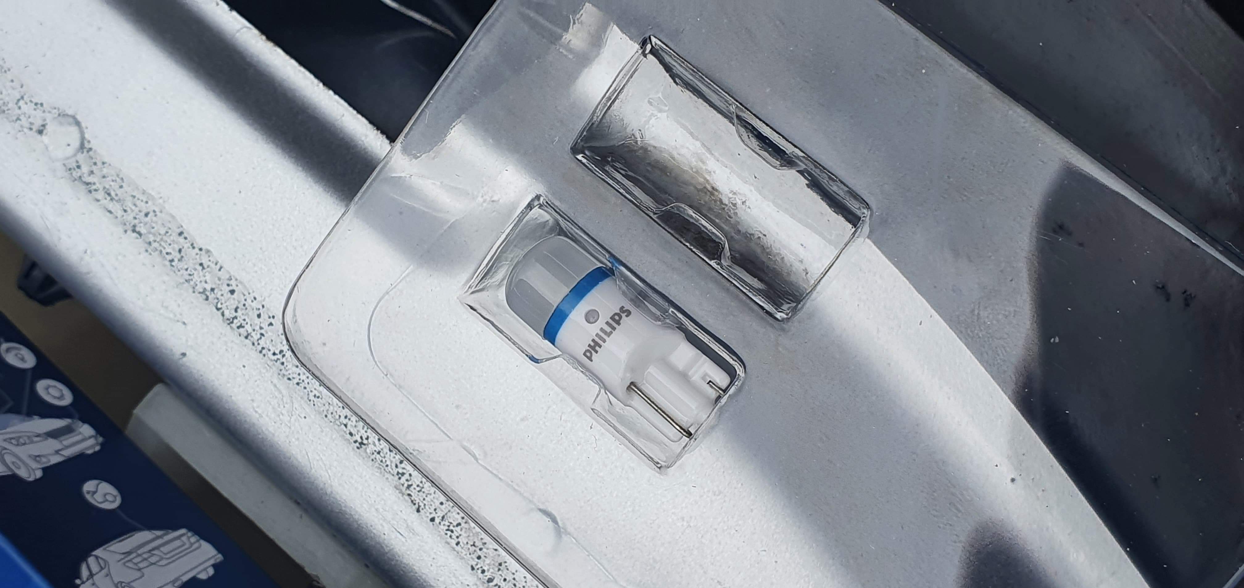

I bought these some time ago…
They give a really good white light and are really visible in broad daylight too!
Sorry for the quality of the photo, but for whag they cost they’re a good solution I think!
