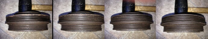

Is my outer crank pulley scrap?
This is in relation to @DickieRltd’s images in my other thread:
in which (the post below the images) he says that his pulley is in better condition than mine, but is still considered scrap.
There is some damage in two places on mine, the worst being on the lip which sits closest to the engine. The third image is taken at 90 degree rotations and the final two images are close ups of this damage.
I just wanted to check if this is the case or if my previous photos made the pulley look in worse shape than it actually was and that it is still okay to use, the teeth (if that’s the right term) still look okay as far as I can see.
Thanks :slight_smile:
Hi I consider my pulley scrap as it is a harmonic damper as well as pulley and the rubber bonding is breaking up.
The engine in my picture is an expensive forged high reving project so no substandard parts will be used.
If you drive hard do trackdays etc its worth installing a new one.
If you are on a very tight spending limit the old one can be cleaned up and re fitted as long as it runs true without wobble.
