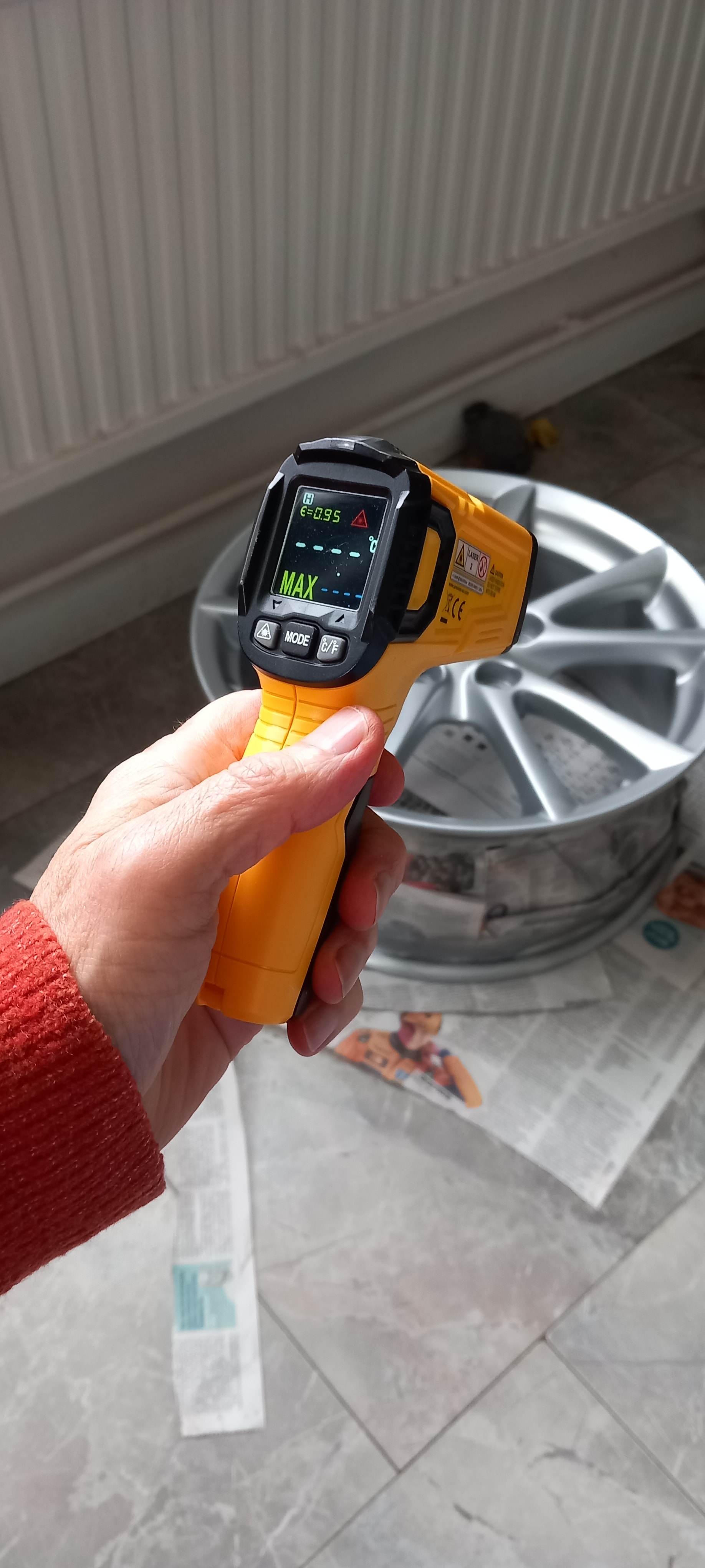

One of the useful things to carry in the car if you have doubts about tyres and brakes is an Infra-Red thermometer. Mine is still working OK five years later.
These are generic and reasonably accurate, and surprisingly useful for comparing surface temperatures, like brake discs or wheels; much safer than touching the dull red glow on an overheated brake disc. They’re also useful for looking at cold spots and heat leaks around the house, inside and outside.
Shiny surfaces, white surfaces and black surfaces give slightly different answers for the same temperature, but you soon get used to it.

I have one of these infrared guns to get an accurate reading of the disc
As Richard FX quite rightly advises a laser thermometer is a useful item to have in your toolkit. As someone who has spent a lifetime as a mechanic when laser thermometers came out it was one of those items that you find invaluable.One great use is if you have wheel bearing noise that you cannot pinpoint where it is coming from quite often after a run up the road the laser thermometer aimed at the wheel bearings will show the offending one to be at a higher temperature.
