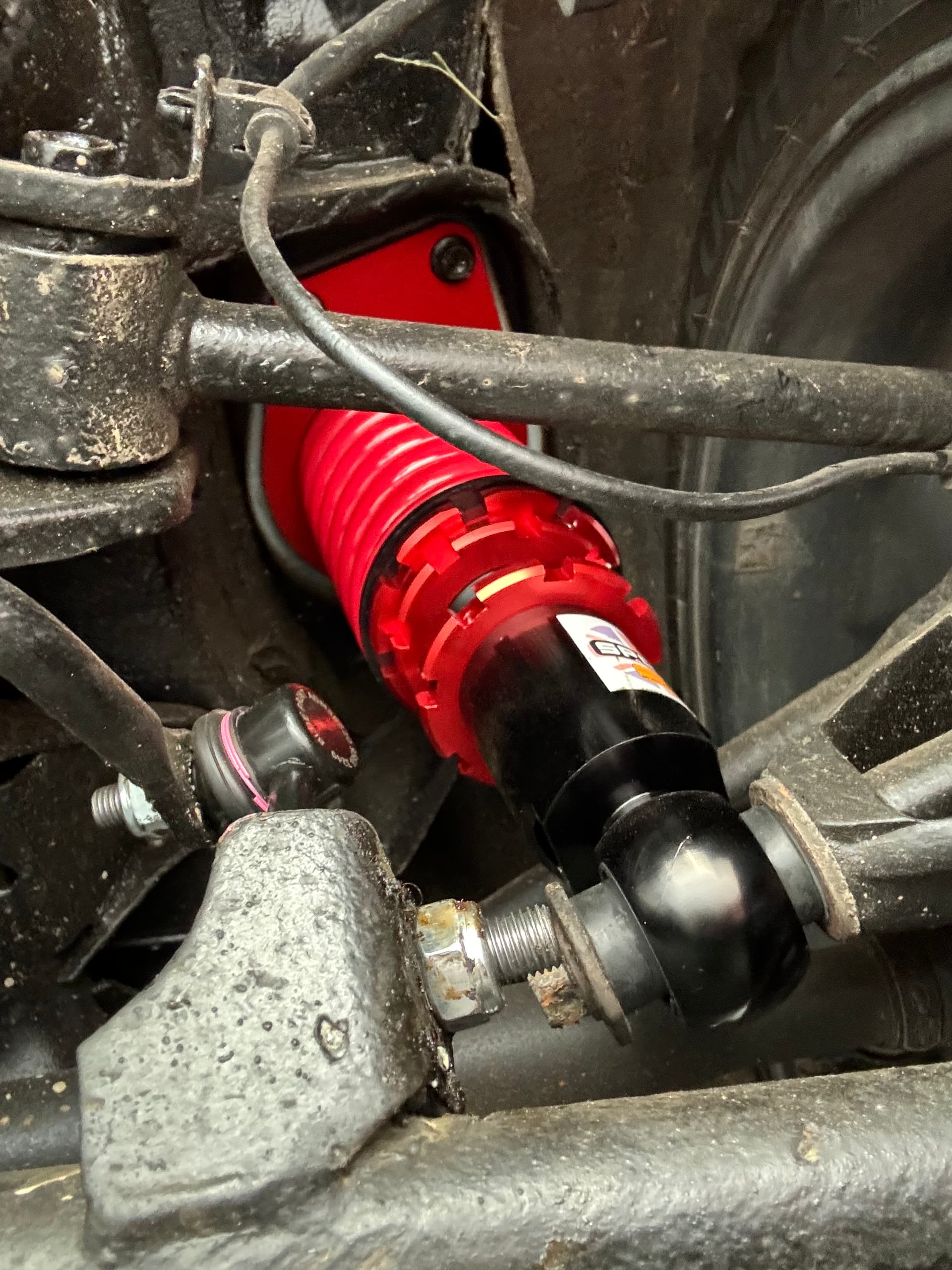

I had MeisterR Sportives fitted by Roddisons last year.
They set up everything and my Sport Black is now like it’s on rails.
Money well spent in my opinion and their experience in this field, is excellent.
