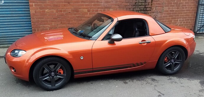

Mine below with MeisterR’s set at around 30mm lower.
Gives you an idea though, infact circumference should be the same on both size rims once the tyres are on.
A base measurement don’t go any lower than 30mm from standard or you’ll find those ramps and speed humps troublesome.

Personally I think this is just right, it’s whatever Meister set them to out of the box, I can get a measurement if you need one as I forgot.
It clears speed humps with one heavy or two medium/light people in.
Mazda spec for 16in is 356 - 405 ft 351 - 401 rr 17 in is 4-5mm lower. Mine has the -30mm Eibach on std suspension and new tyres shows 355 ft and 345 rr
