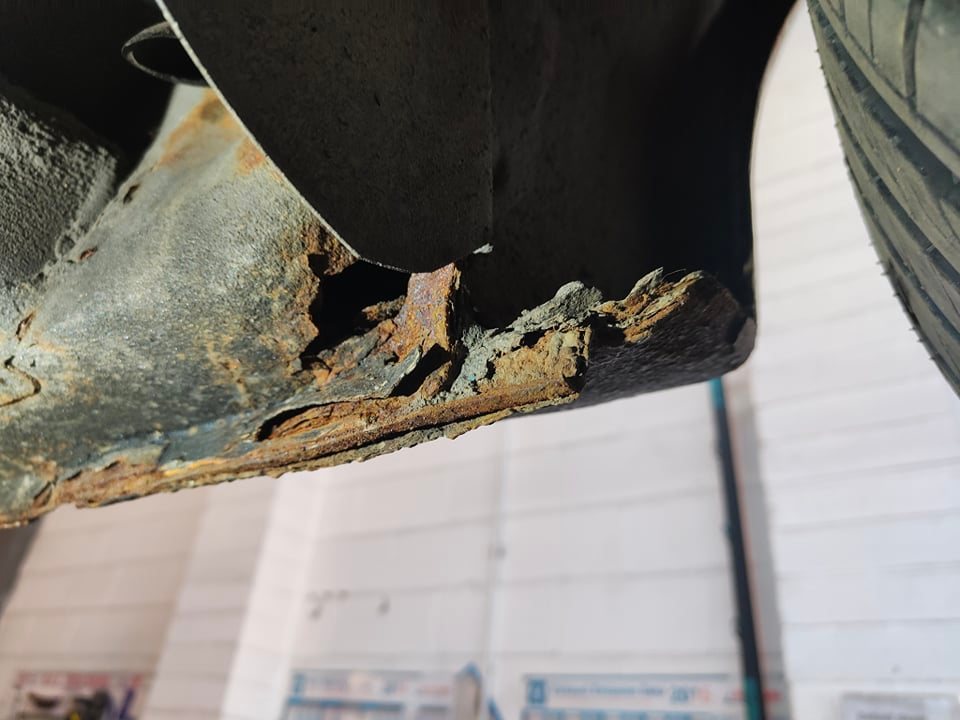

I put the car in for the MOT yesterday and it failed due to corrosion. The guy who does the MOT is a friend of mine and still had the car on the lift to show me. Rear sills: screwdriver went straight through and not in a small spot, but quite a large one on the nearside. A huge chunk flaked off freely to leave a large hole. The front rails: clear signs of rot, large holes etc. When I told him I was surprised as they had checked it over a few months back, he simply said “No they didn’t. There is no way they could have missed this”. He also informed me that someone else brought in a light blue MX5 a few months back which they bought directly from them and the rear sills were like damp carboard. Rotten and squishy.
From this I can only conclude they either didn’t check but claimed they did, or didn’t check properly.

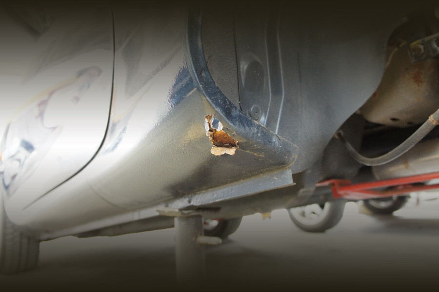

Anyone buying a NA or NB; if there is any bubbling of paint on the sills, or sill area, its NEVER just surface rust. Its always rusting from the inside out. eg. bubbling paint might be spotted, which is soft to touch. You might even squish it, and it oozes water. Scraping the paint off at first glance reveals clean metal, and someone might conclude paint defect. A closer look reveals at the centre a tiny black hole, a pinhole. The is the first sign the metal has failed. Further scraping might reveal a black circular edge. Pushing in results in a crunch.
It might be a pinhole, but the repair is just the same

And just for reference to the pic Saz as posted, DO NOT EVER EVER rest your roadster on the sill lip edge to work on or lift on it, it is very very bad practice to do so and will cause massive damage ,it is not for jacking on, the jacking points ARE BEHIND the sill lip , not on it.
Please do not do it .

Annoyingly the bit in question wasn’t as per the images, but behind the sill lip at the rear. The fronts, well that I should have been able to spot, had I thought to check for that.
FYI, the example is a photo of a car in Japan needing rust repairs. Hence, what you can see of the underside is unsually clean looking.
Yes, leaving a car sitting on axle stands in that way is pretty bad.

These are the pictures THEY sent me after the MOT

I went there 2 months ago for some work on a 1999 I bought and wanted to know if the car was worth making into a project so asked them to check it over while sorting out some work under the car. They called and said that it had corrosion as expected but that it was solid and must have been done a little while back so should not have any problem in an MOT. I had it tested last week and it failed due to corrosion. The MOT guy stuck a screwdriver through the bottom of the sill and found this to be around 1 foot long down the side of the car behind the lip. When I said I took it to be checked and what they said he laughed as there was no way this had ever been worked on before.
