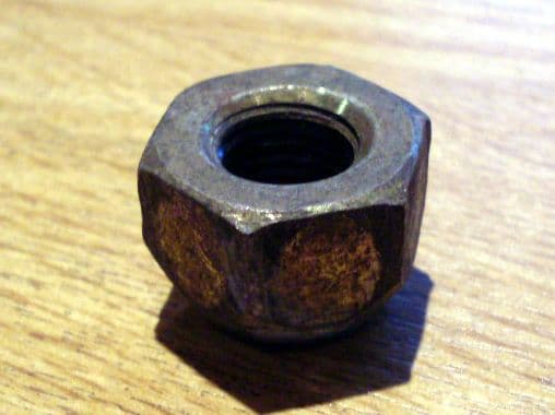

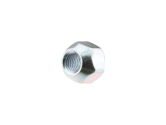

Thanks everyone. Looking again I think they are original bbs wheels for a Eunos Mk1. The problem is that they were fitted with the wrong wheel nuts which are too long - hence falling off!  The tip to drill and tap the covers looks really helpful. Thanks again
I wouldn’t do that “fix”; its a lousy solution to bodge covers that are £100 each. Better off getting the correct wheel nuts.
As Saz says, please don’t drill the centre caps, they are rare and very expensive ??
I have these wheel nuts on my car which fit BBS wheels.
