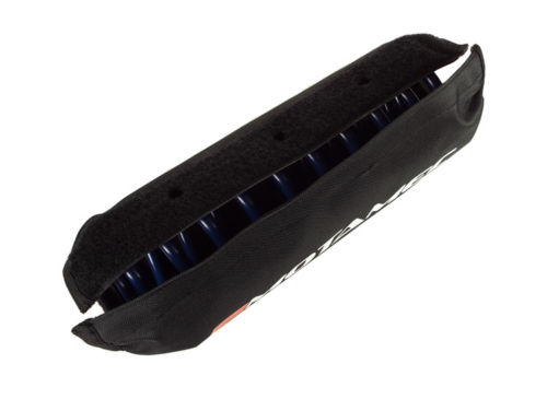

I have fitted custom made, ally bodied Protech coil-overs to my trials car. To protect(!) the springs and damper rod from mud and corrosion I fitted simple covers, made from rip stop nylon, over the springs. They don’t affect the function of the shocks at all. Any dirt just falls off as the covers flex.

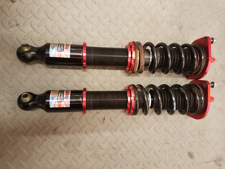

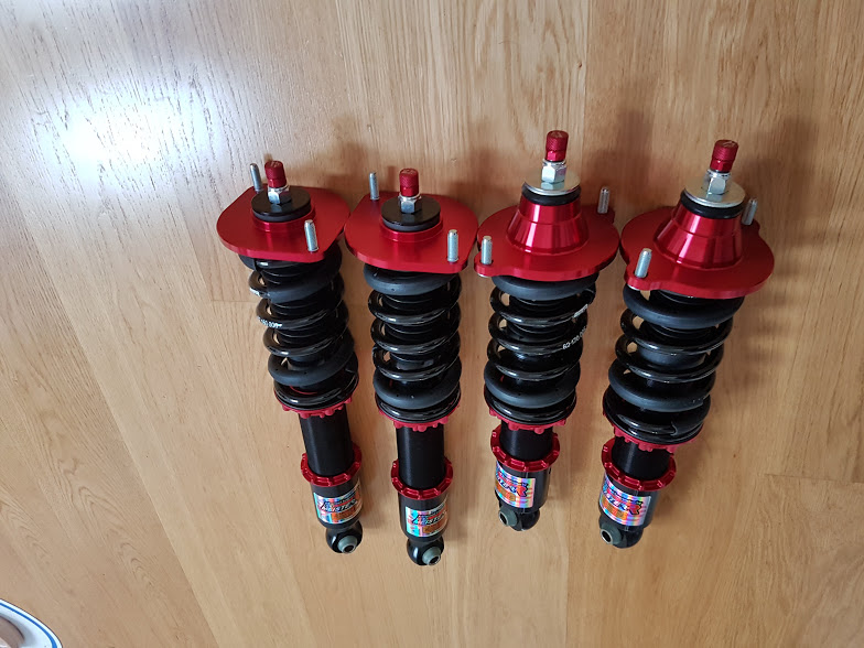

Here are my Zetapro Meisters purchased in 2014 used for two winters on my Black Mk1 before being fitted onto my recent imported Mk1 in 2016 and sold in March 2018 with the only noticeable defects a slight paint chipping from the springs which were starting to rust the only reason for selling and replacing with a new set.
My new set as Jerrick at MeisterR suggests have socks fitted when in non show use.

Hi Ian,
I notice on your ā€˜New set’ the springs have some sleeves over the top and bottom section, I assume to help prevent the coating being damaged if/when the coils touch each other, they are not on the old set.
I am just fitting a set of Crd’s I received early January to my NC and they do not have this sleeving on the springs. Do you know if this is a recent addition by Meister, or did you fit it yourself?
I also note the Eibach springs currently on the original dampers have some sleeving top and bottom also.
cheers
Stewart
The ā€˜New set’ came with the sleeves fitted, perhaps Jerrick may pop in and advise as to why.
Cheers
Ian
