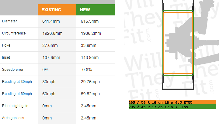

Arch gap is actually marginally higher with the 17" OEM setup compared to the 16s. If you’re comparing two cars with the same factory ride height of course!
This compares 205/50/16 with the 205/45/17. Calcs here:
N.B. I actually run 195/55/16s Goodyear Vector AllSeasons on my original 16s for winter, but that’s for another thread! :wink:
