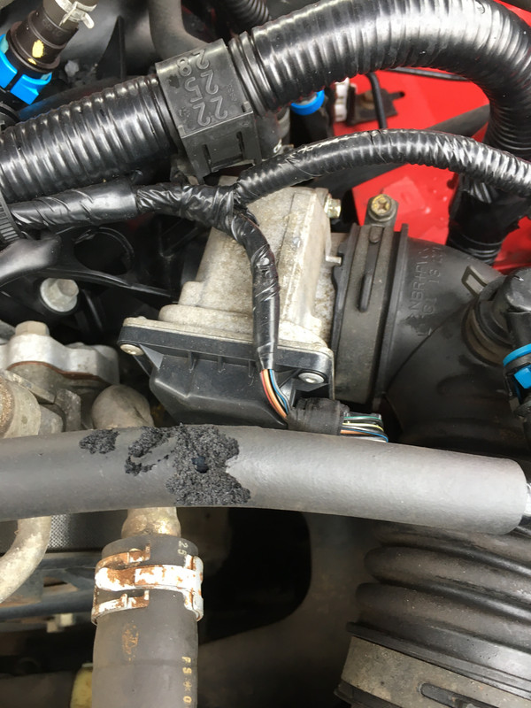

I had this problem last year - the mice particularly like that nice soft spongy covering over some of the pipework around the engine on my MK3.
Both my husband, and a mechanic friend, suggested spraying / wiping the engine and engine bay area with WD40 - as mice do not seem to like the taste! I tried this, and it seems to have worked for me - I do re-apply the WD40 occasionally (especially this time of year!) and I also have a mouse trap situated behind the car in the open lean to where it lives (obviously make sure the mouse trap is somewhere safe where dogs noses, etc, cannot get at it!!!)
I use the car every couple of days, but that did not deter them, until I started using the WD40 - so it is worth a go!

Does that foam actually do anything? Could I remove it altogether? Could it be replaced by something more durable?
