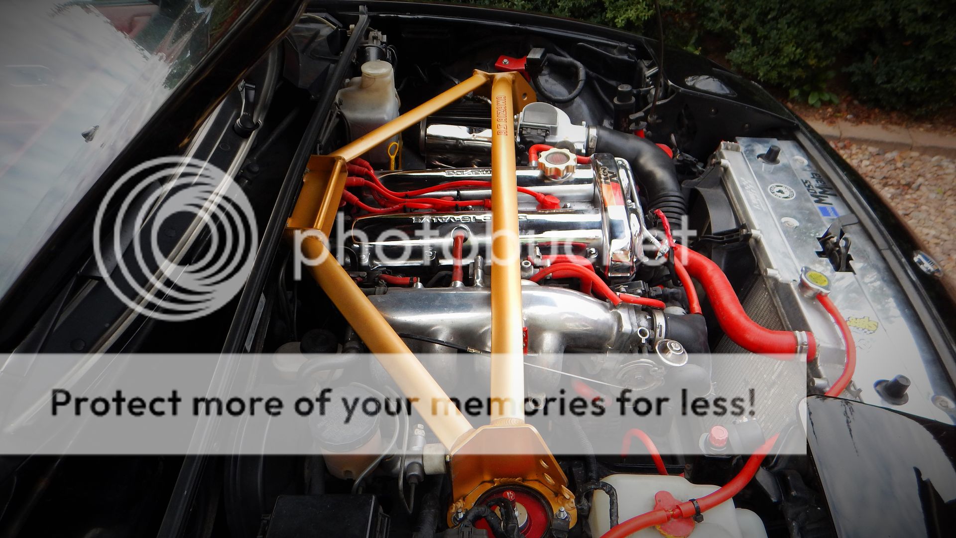

The only brace I’ve had that makes a difference is a 3-point triangulated brace; I have a Okuyama brace, but Moss do a rip-off version.

Looks impressive! The three-point job that Moss sells doesn’t have the triangulation bracket, so I can’t see it as being as effective as either your Okuyama brace or the standard “straight-over-the-top” effort, as it has an additional joint that could conceivably twist.
I suspect my main problem could well be the air intake “snorkel”, which you don’t seem to have.
How is the brace fitted to the bulkhead? Are extra bolt-holes needed, or are they existing?
